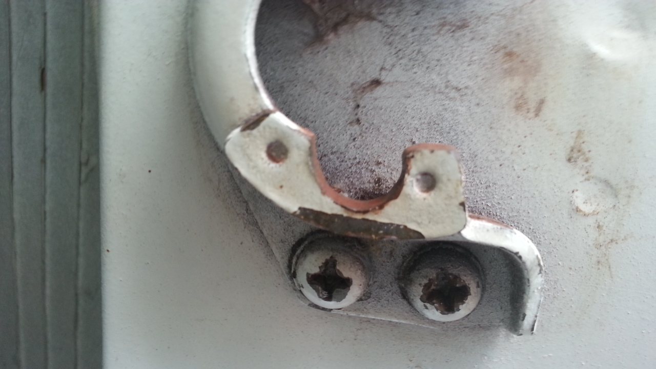

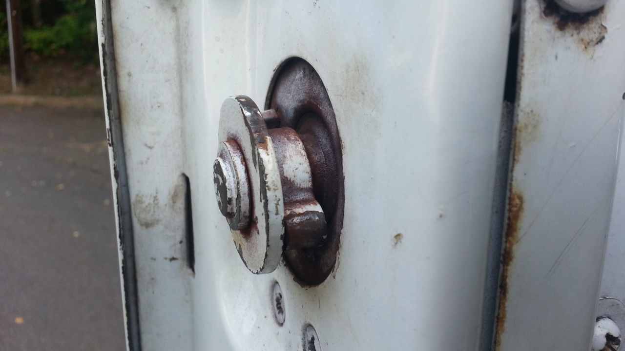

This is the "old" style latch (62QS325A) and striker (keeper?) (31RC310B) which lasted up into the 80s...
post-11199-0-14820300-1379370069_thumb.j
post-11199-0-09064100-1379370088_thumb.j
Pictures showing which part number is which will be excellent!
Jim
...and here's the 424 somebody has on ebay...
Notice the external prongs which engage the striker. Different.

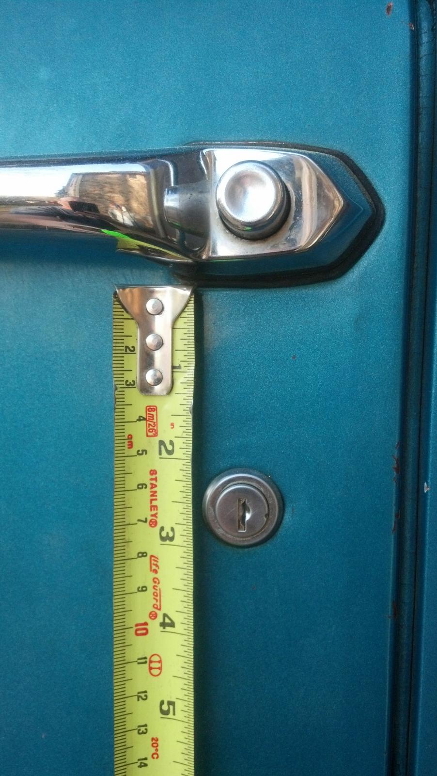

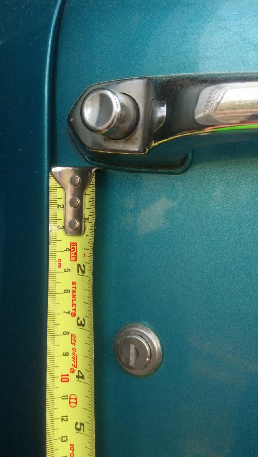

Here's the difference, the first pic is of my 1979 "old door" and the second is of the "newer" R model door. The only difference is they moved the key cylinder lock hole down about 3/4 of an inch to accomidate the new latch system. Just enough where the old latch will not line up with the key cylinder in the new door. I guess the easiest fix would be to move the clylinder back up when I get around to body work and paint.
That's about the most helpful thing anybody ever did!
Thanks for the pic.
