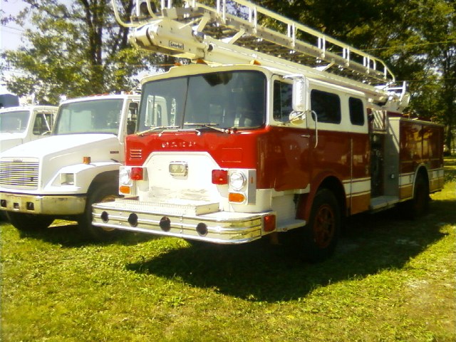

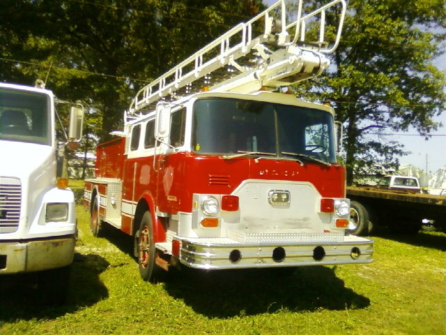

Well Guy's it's like this, A friend told me about this truck in mass for sale for $6,500. I looked at the pics , called the guy Who by the way is a Mack collector and truck salesman. I would rather not say his name on here but he has the FIRST R-model Mack firetruck and cut it up to make a pick up truck out of it.. Anyway the truck was not shifting into hi range so he took it to a mack dealer across from his house to have fixed, (a buddy buddy deal) they told him that they could not fix it and they were to busy, so he took the truck home and tried fixing it himself. I flew up on Monday, The truck had ALOT more rust on it then was in the pics, when we took it for a ride I did not think it was shifting into high right. It would not shift into high untill 2100 to 2200rpms. and alot of blow by. Going against my gut feelings i purchased it anyway and started to drive it home to Wv. It did ok untill I started to hit some longer bigger hills in Nj. then when in pa. going up and down the mountains it did not shift right, the temps started going up to 240 degrees and staying there.When I stopped for fuel it had about 2 quarts of oil on the ground, going up hills trucks kept flashing thier lights because of all the blow by smoke. My intentions was to buy this scope and restore it for my collection and to use it for parades and use it in the movie industry, However when I got it home there was bearly any oil on the dipstick again, and now the truck won't start. When all of you saw this truck on here for sale from that guys collection it was for sale for $4,250 , then sold it to me in this condition for $ 6,500 and I a total of $8,000 into this truck that won't start, when it did run,it did not run right. I had a guy from a local Mack dealership come and look at the truck and he said if it was him he would junk it. it needs a new motor not to mention when he looked undernieth the body frame mounts where COMMPLETY rusted through He said it will cost you more then it is worth. . I was not able to get under the truck and give it a good look over due to me having only 1 leg. I put this on here seeking to help some fire department to maybe they could bennifit from my misfortune and bad judgement with buying this truck. I trust people too much thinking that no one would screw me over that bad. Instead of getting some usefull help or advise I get talked about .I am out $8,000 for a truck that is junk and sold to me by a MACK guy as being good. It;s all in the attorneys hand now. I appaligize to the great guys like this YARNELL, I will never post or seek help here ever again, after this episode I might just become this GREAT GUY that you called me and start buying every Mack Firetruck that i can and scrap them all, just because of you and all your neg, comments.

Let's set this story straight!!! I am the gentleman who sold George the truck which I purchased from the estate of Don Costin.
I drove the truck back to my yard from Wenham , Mass. which was about 65 miles. I did have trouble shifting into high range
on occasion, however the truck did not overheat at all. I looked into the shift problem with my friends from the Mack garage.
It was determined that the throttle linkage on the injection pump was out of time. I corrected the problem and also adjusted
the linkage on the air foot throttle. I rode tested the truck and found that it did shift at 2100 rpm's as it was designed to do.
The buyer was e-mailed approximately 20 to 25 pictures including 4 pictures showing the minor rust. He was also recommended
not to drive the truck to West Virginia as the truck is 42 years old and weighs 44,000 pounds and was not designed to
travel that far non stop due to the age of the truck. The buyer stated it would be alright because he was in no rush and was taking his time. He left here at 1:45 P.M. on Monday, Sept. 9th and arrived at his home at 5:15 A. M. on Tuesday. He had the opportunity to get on a plane and go back home if the truck wasn't what he wanted. He did not mention that the truck had six
brand new radial tires on it and a brand new E-1 body. which is worth $6500 any day of the week. He also stated he has a
1980 Mack Scope with extreme rust but a good drive line, it would be well worth it to put the motor from that truck into the 1971 truck. I have been fixing, running , and selling Mack trucks for over 40 years and never had one complaint. Any one
is welcome to e-mail or phone with any comments positive or negative or questions, which I will answer.

The Lynfield scope is going to be parted out instead of being completly crushed. I have had several private messages from people wanting parts for thier cf macks. A mack mechanic came to the house over the weekend and found SEVERAL problems that he recomended not fixing due to cost. The injector pump is shot and does not have enough pressure to keep motor running,there is oil leaking from the turbo, the radiatoris almost commplety rusted through, which is probabally why I used 3 gal of water on the trip home. and after he found and read the aerial inspection report that states that ALL the frame/cab mounts are rusted and rotted completly through that I would not be a good cristian to sell it to someone in that condition. . BUT on a brighter note.. the boom works great,some of the outer body parts are good . The tires and rims are already spoken for, A guy wants the aerial basket to build a bar for his mancave, (unless somebody wants the whole boom) The boom is complete right now, anyone interested in the boom, conntact asap or it will be gone also, Doors, glass, gauges, emblems, reaend,are all good and still unclaimed.and for sale. I do have the full set of ladders for sale as well. Anyone interested in anything, please send me a private message and not public due to some of the inmature haters out there with thier negative facebook drama.
