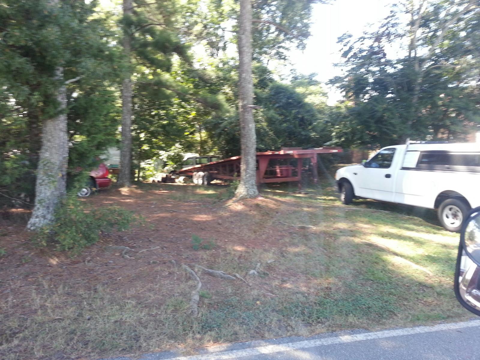

I see a lot of guys running 3 car trailers on their tractors. I am looking for one myself for my General.
This one's in nice shape,been parked where it sit's for a cpl. years.My dad just said I can use it if I want,i'm claiming it... :twothumbsup:.May have to get that Titan single axle tractor if I can score it for a good deal.
https://www.bigmacktrucks.com/topic/32758-car-trailer-question/#findComment-205939
Before putting it into service I would pull the wheels, check the brakes and service the bearings. Then go over the lights to make sure they are all good.
