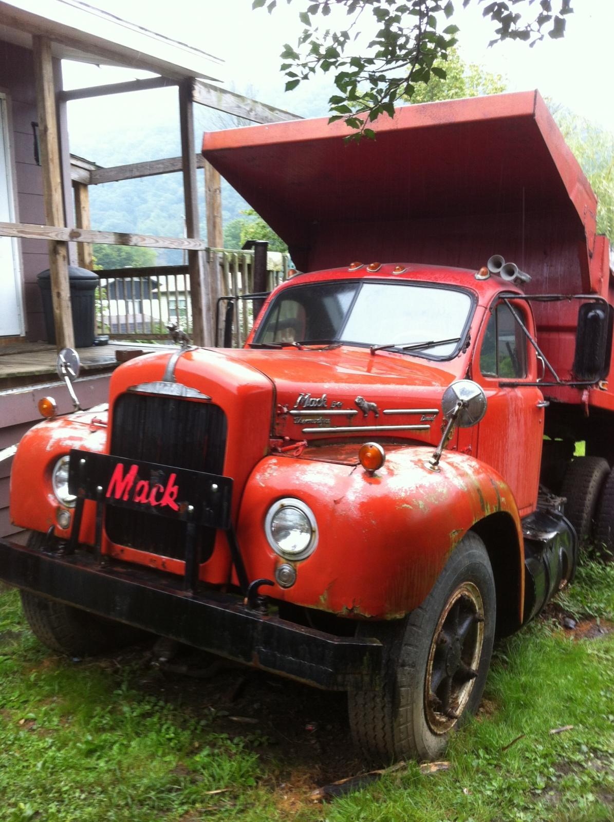

Ok have to start keeping my eyes peeled for 24.5's then. I like the big cab protector and the high sidded body too. I would just air her up and pull start her but its down in their back yard so ill have to either drive her out or tow it. It was starting fine and now the starter doesnt turn and the wiring is gonna need some help so im figureing to jump the starter over and go from there

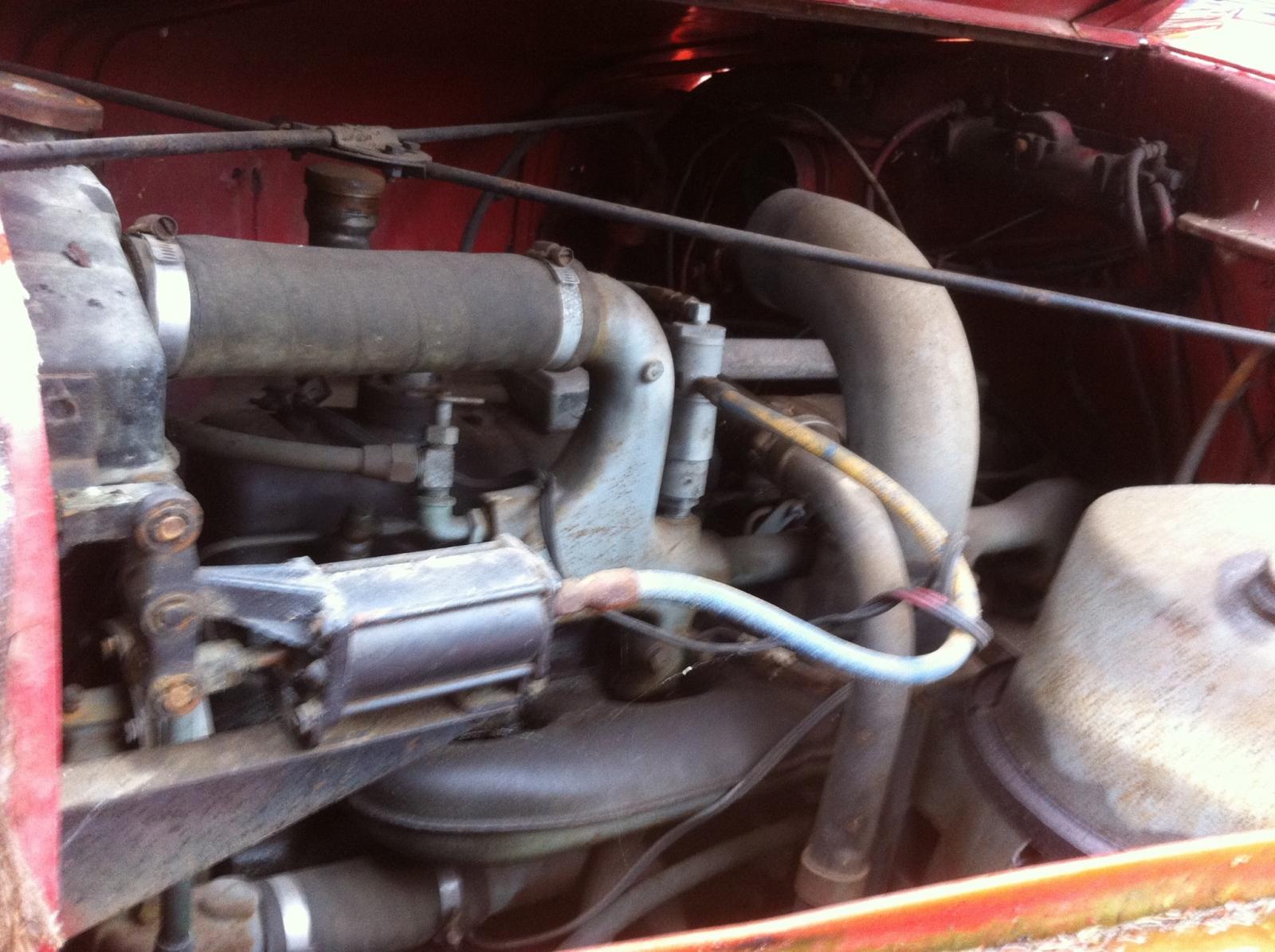

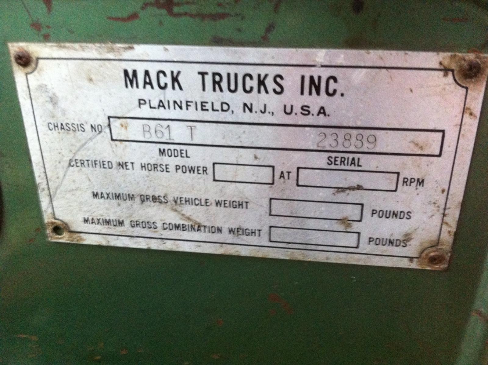

Well went up to see if i could get the ole girl to fire up. After loading up with what tools i thought i might need, i drove up and started working. I got the tires aired up and as it turns out they weren't flat just sunk into the ground. I used the hand primer pump to make sure i had fuel to IP. I had hooked up a battery charger when i started and gave it a try, just the solenoid clicking. Ok well lets try to just just the starter over. Well only being familiar with r series solenoid being on the firewall i had to trace cables to find it under the seat. Honestly would have been the last place id looked. Well i only had one screwdriver and a pair of pliers. I should have knew better than to try but in light of better judgement i tried to jump it over with the pliers and knocked crap outta my self. Found another screwdriver and after melting the tip off of it she cranked over about 6 times and fired right up. I was surprised that it appears to have original air park brake. I always thought they had a parking brake drum off the back of the trans? Heres a video of her running sorry its dark it was about 9:00 when i got it running.

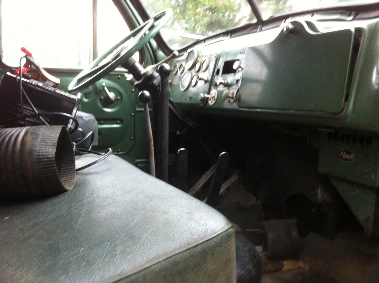

Ok that was my thought that there was no such thing as spring brakes in the 50's. im guessing mine has a very early retro fit kit. And strangest thing to me at least is the park brake knob works backwards (push to apply, pull to release)
it may not be hooked up right or its the wrong valve, I did a thread on installing spring brakes http://www.bigmacktrucks.com/index.php?/topic/24092-b61t-upgrade-to-springbrakes/?hl=%2Bspring+%2Bbrakes#entry110188
