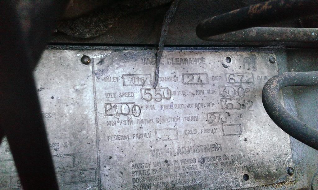

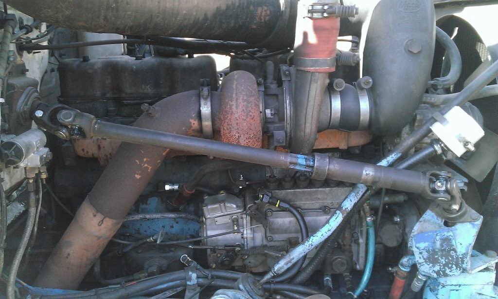

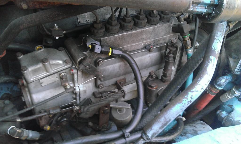

What do you guys think the best cruising rpm is at 60mph? Both for fuel economy and pulling? I've got a 2v 300hp and I can get a cheap rto11613 13 sp single overdrive and 3.9 diffs. This combo should see me sitting at 1800rpm at 60mph (100kmh). What do the e6 engines like to run at?
