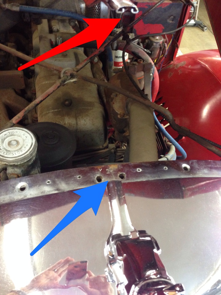

-Front hood hold down bracket (see pic below: blue arrow indicates where it goes and red arrow indicates what it holds down. Probably easily fabricated if they are hard to find.

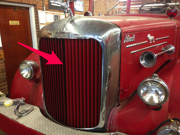

-Front grill chrome trim piece (maybe says 125 near the top like some of the 95's?) See pic below for where it goes.

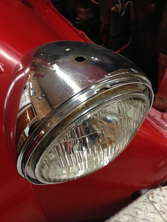

-Font headlight outer trim ring (drivers and passengers side).

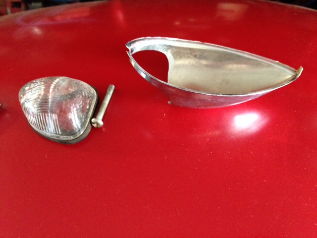

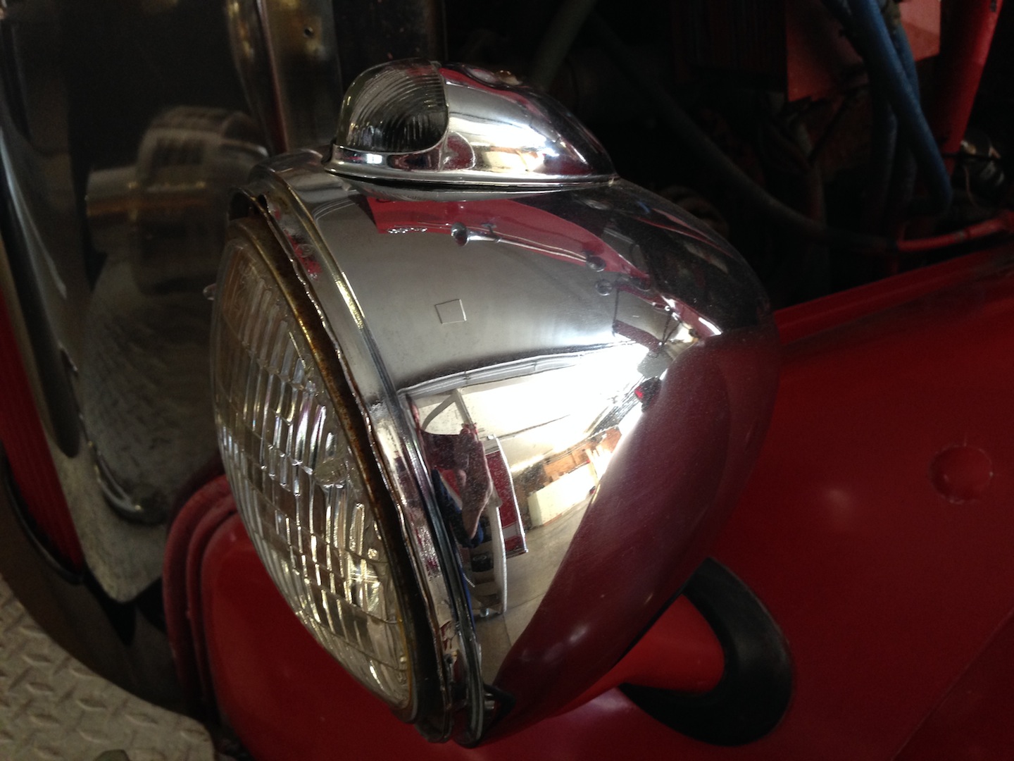

-Top mini light on top of the passenger side headlight (see pic)

there are two lenghts of the park lite and I presume yours is the short one.also there are two types of lenses show picture of other side lens.the hood hold down brackets for the hood stripe are avalable from mack. same as whats used on rd steel hoods.head lite ring are easy to find at swap meets.I would put one mirror on the drivers side and use the old fashion (ones that came with truck)arm style.
part numbers for hood hinge brackets are:73RU11842P1-- 73RU11843P1--73RU11842P3.they are also used on the DM models.Same hinge stripe on them all rite back to EQs,LJs.Let me know if you can get them back there.

Thanks for the info. I've included a pic of the other sides park lite. I didn't realize there are 3 hood hinge brackets. We have one at the rear near the windshield and one (I assumed) at the grill? I appreciate the part #'s. Is the strip in the center of the louvres something I will most likely find online?

The "125" should be a small shield shaped badge that goes just below the Mack script on the vertical center piece of the radiator shell. They are basically impossible to find, but it should be fairly easy for a jeweler/engraver to make a replacement.
I have an original headlight bucket with the marker light you need. Check the bottom of the head lights to see if they still have the "twist and push in" type of connectors that were stock to see if the headlights are original or replacements. If they are replacements the best route will be to find the vendors name on the light to track down the marker light. I also have the trim ring, but it will need to be plated.
I think those are the same style parking light modules on the headlights of my 1958 F.W.D. and if so, I might have some extra chrome pieces laying around, lemme take a look and get back to you.
You can find the headlight pieces at www.otbgear.com in California. they have a website and are very knowledgable and friendly
That's who I used for my replacement lights. Nice lights and very close to original.

fxfymn- thanks for the offer on parts. I'll try to drop you a PM. We are missing the entire grill vertical along with the 125 shield.

The badges Cal sells are not engraved, just flat printed. Your choice.

Sadly, the hood hinge (4QM12P23) has not been available for a couple of years. That was the DM800 part number and it could be cut to length. It was the same profile so it worked on A, E, L, B etc.
Jim
jhancock;I was refering to the end caps.they might not be available either but its worth a try.
Sorry, I was thinking of the hinge strip. Caps are still available. About $100.00 for the set of four
Jim
have you tried the mack dealer for hood hinges and if so how did you make out
