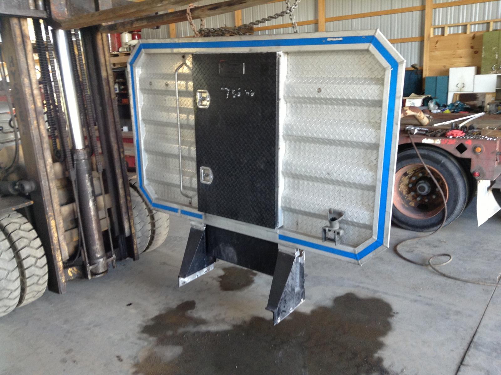

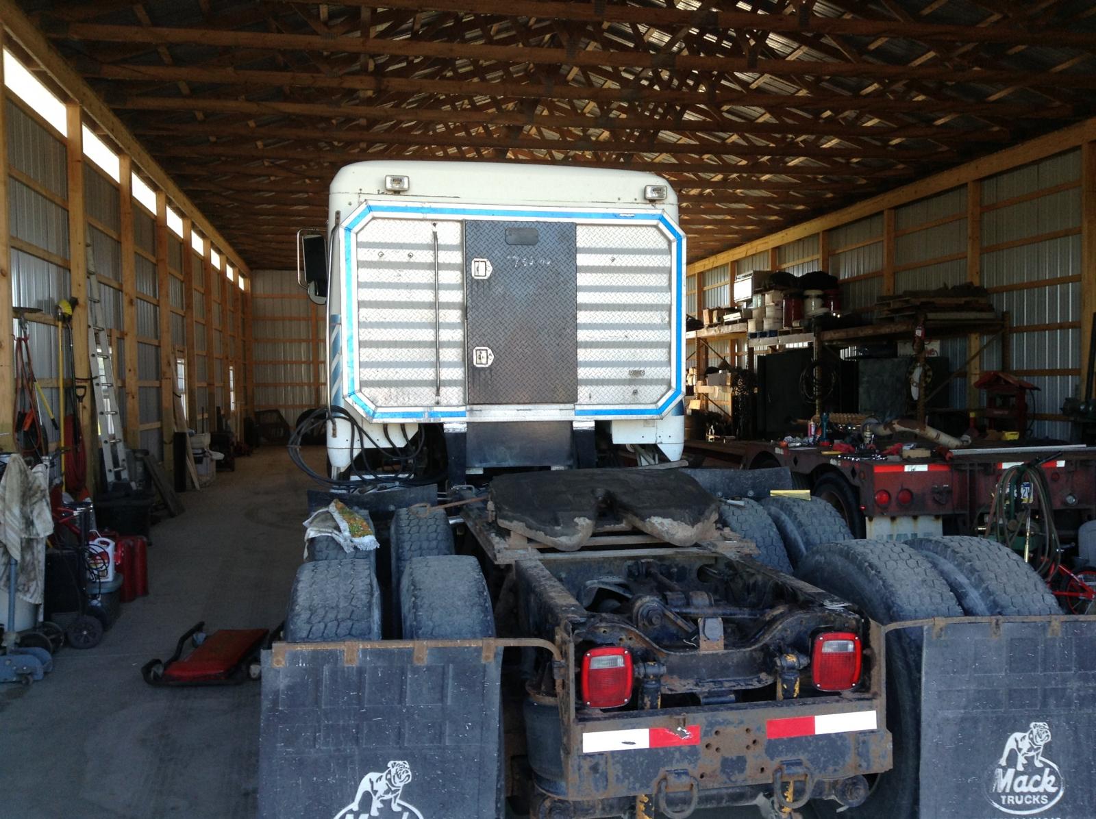

Damn thats sweet, I keep noticing more cool toys in your shop, I now see a forklift too, I think Im gonna need to come hang with you for a few months to get some projects done with all those toys. I did some math a 4.17 would be a swwet gear for the 350, would keep it right around 1500@68mph, they seem to pull best @ 1600 and get better fuel mileage there than lugging, if your going to swap to low pro 24.5's go to 3.86/3.89 that puts you in the same place, Im going on a .74OD in the trans. Wheres the RW at, it sacares me to see"cant wait to get the rw back" makes me think something happerned to it and its just too nice a truck. Im sure Antrim will be happy to take care of that long time to get to speed issue too, just take it to em and drop it off for a week, Oh and leave a blank check of course.

Couple years ago put in a Lype clutch from a pull truck from OH, when mack put in the sec trans, worked ok but some times just didn't seam right. Pulled it apart and the fly wheel had high spots and to make it better it couldn't be cut. New fly wheel for an E9 will cost you 1700.00 from mack. It's all back together just got to pick it up.

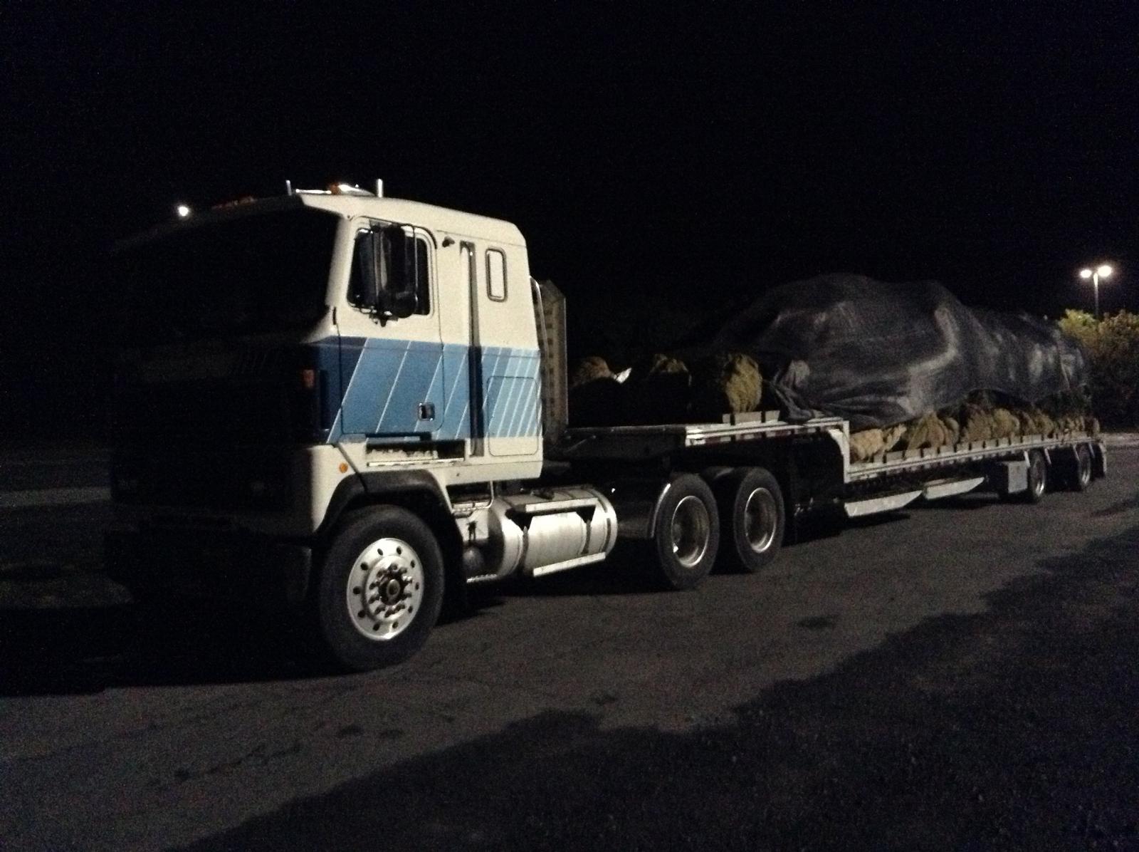

Truck look good though!!
