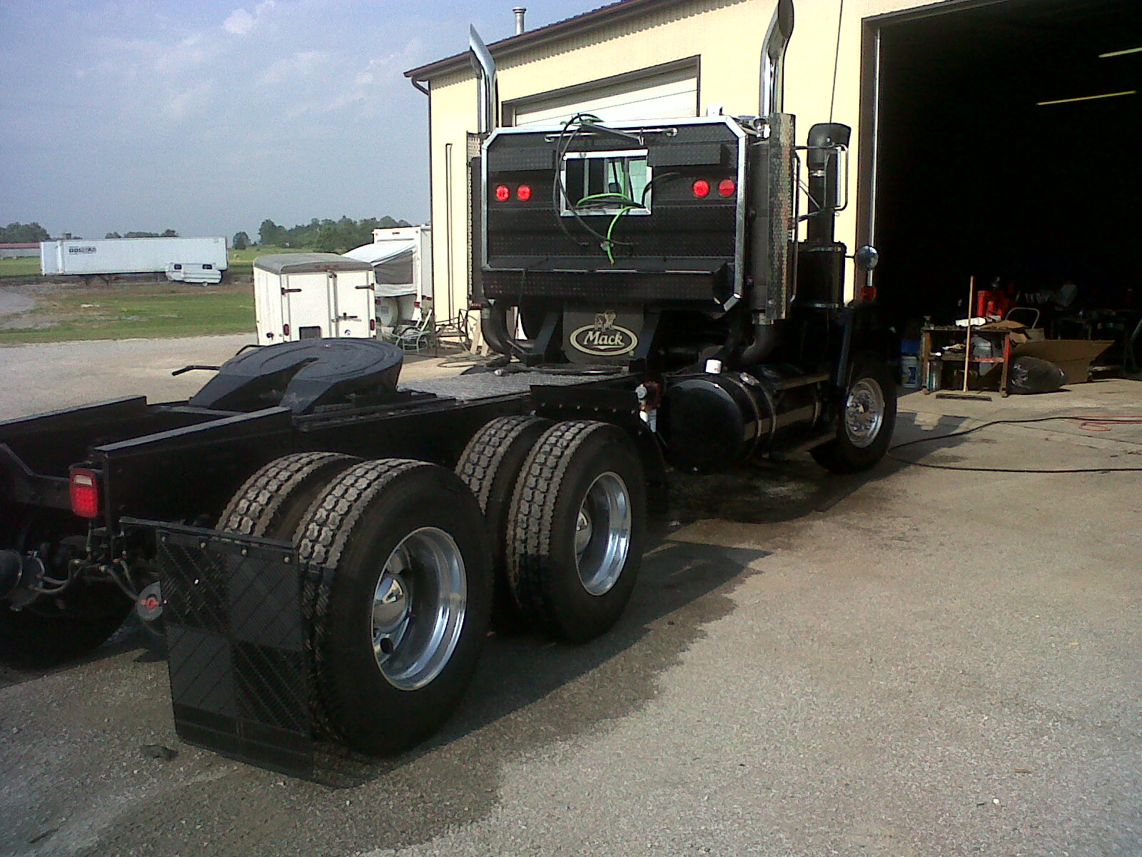

Okay I took a ton of detailed pics at Lititz of all the different ways to dual out a Superliner...problem is, I didnt talk to anyone and get manufacturer/part numbers!
I want to run 6" at least to under the cab, but I cannot find anyone that makes a 6" chrome elbows less than 45 degrees...
If I go from 6 to 5 on the stack, I have seen a bunch of one piece multi elbow 5" chrome that gets you inder the cab and turned toward the center like this...
It looks like a 90-30-45 degree bend...anyone know the manufactuer? I have been thru the Grand Rock Catalog...UNless they are kw or pete parts or something...

Anybody have any ideas?

CL exhaust is different...no go...
Got some prices on the chrome 5 inch like on bobo's awesome truck....WOWSIE!
The drivers side pipe (between the muffler and the crossover) is $510,
the other side (which is one pices and includes the Y pipe) is $1340!
Anyhow, I have the part numbers and illustration for a superliner dual system
if anyone ever needs a part number!

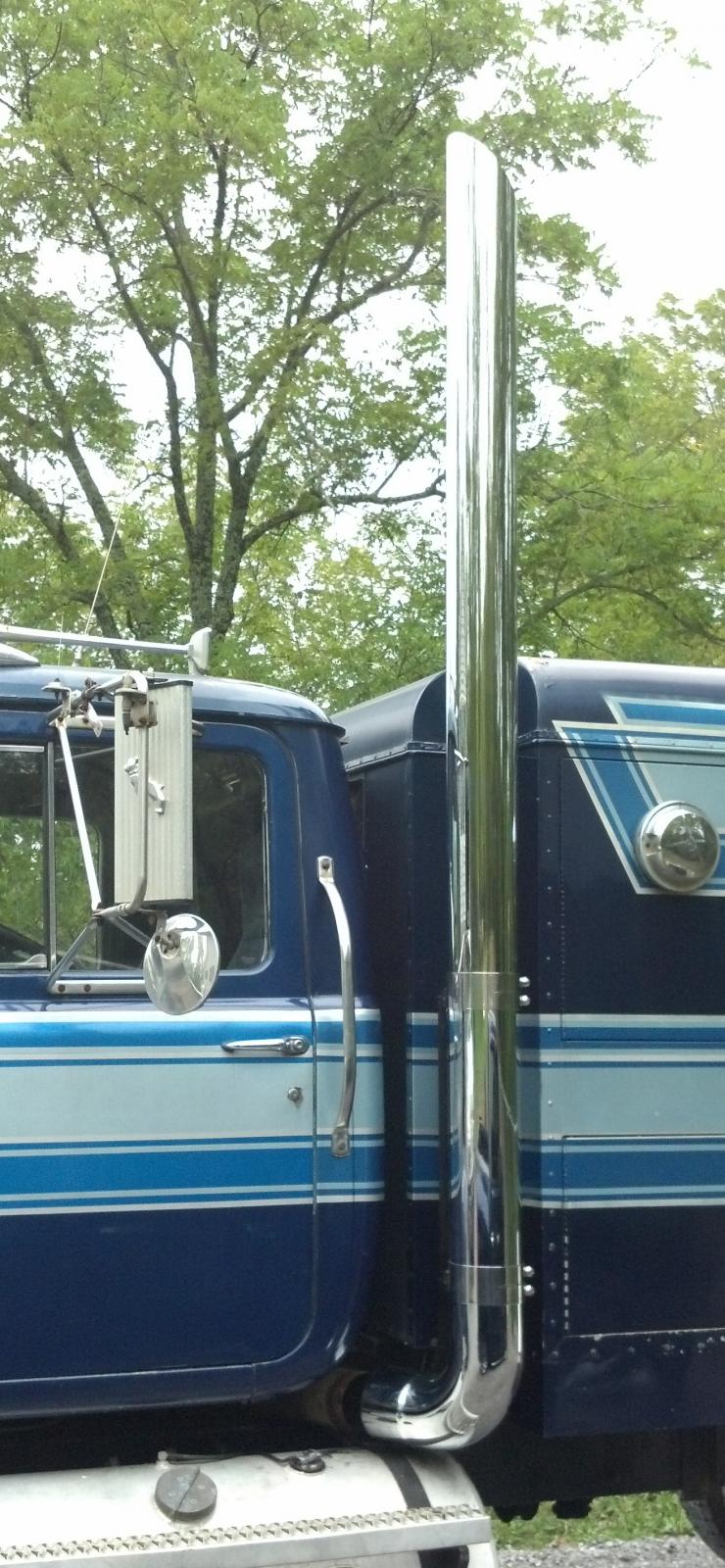

Heres a pic of one side of mine, it drops back to 5" after the elbow before it goes under the cab so it has plenty of clearance, like I said its 6" united pacific 96" miter stack and a 6" dynaflex tight radius elbow, they are both plain end where they join and there is a sleeve inside the seam is hidden behind the bottom clamp. I think the chrome 6-5 reducer was Dynaflex too, and the clamps are Stainless wide band mounting clamps for a pete, I cut the brackets off my hangers and made my own to get the stacks where I wanted them.

Very clever...me like...I like the idea of hiding a sleeve inside...are the pipes 6 ID and you used a piece of 6 od for the splice?
I am struggling with how to get back around the cab air bag and how to "create" the Y...
It is about 15 deg from the support bracket, then a 45 to go under the cab, I would need a 60 degree to get back straight across the frame...
Still thinking whether to go under the cab at 6 or neck down after the stack...
So many choices!

mine is 6" id stacks and elbow, with a 6"od sleeve, the sleeve is made for this so they should know what to get, then under the cab past the reducer I have a 5" 45 on each side, going forward into a y pipe on the right and another 45 on the left, then its just a short piece of straight to tie into the y pipe, Ill have to try ot get under my truck to take some pics, I used a piece of flex on both sides and another one from the downpipe to the y so theres plenty of movement.
