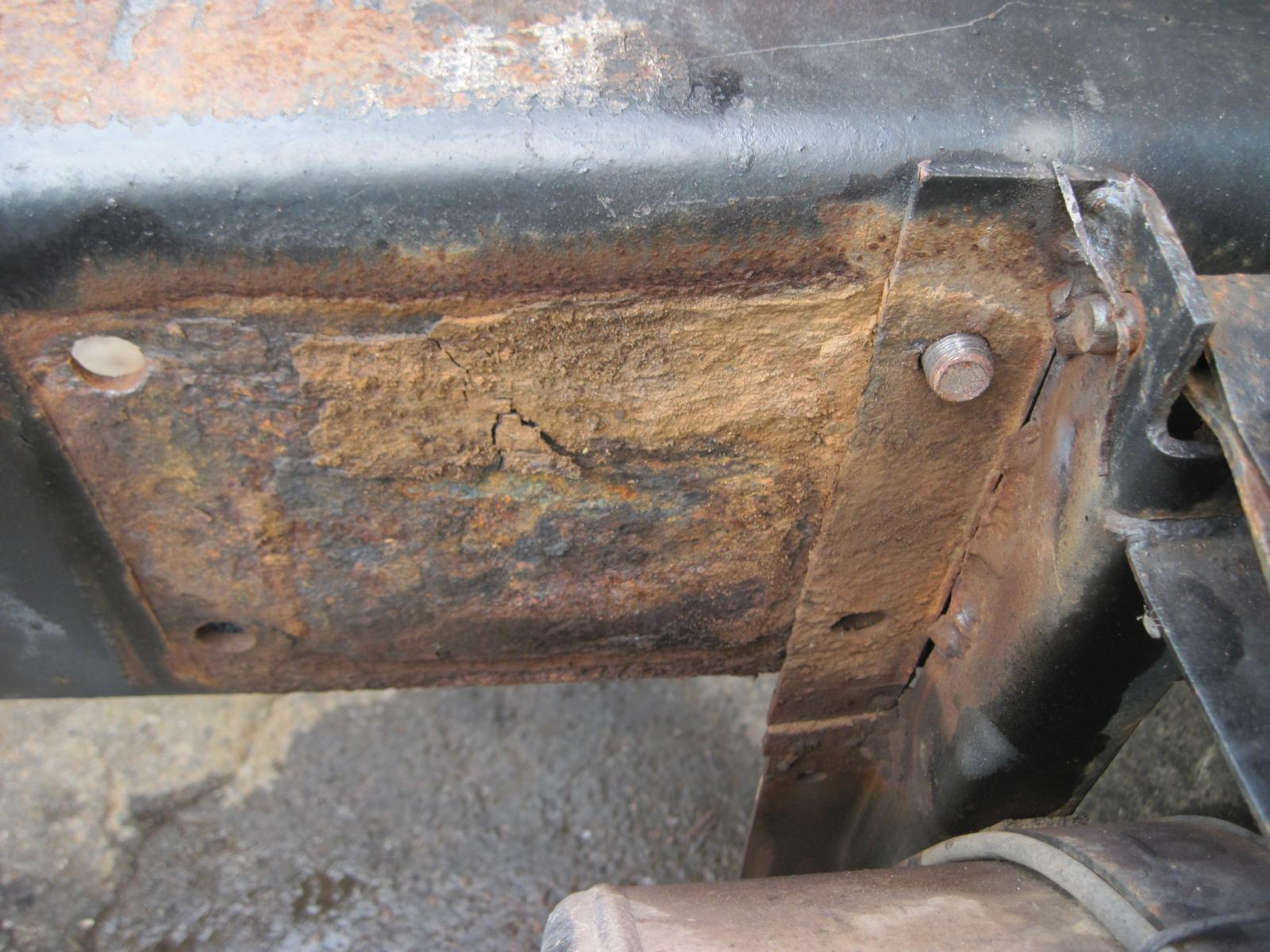

Got the plant's 3/4 impact...a lot of heat and some serious impact action got them both!
The whole reason for this was that the exhaust bracket was leaning out...instead of bending I took the thing off to find out why and found that the rust spreading was the culprit!
At least now I KNOW why they stopped using the pass side fuel tank! Bracket broken, repaired, broken again...I guess they just figured it would be okay as long as they kept it empty!
I might have one of those brackets. They are the same on the MH and I've parted out a couple.
I will say Mack is persistent with their design,,,,,They still use that spacer for the exhaust bracket on the CL's For all the Salt to sit.
Also check for any cracks on the exhaust bracket,,,,They lose their tensile strength over the years and shake allot
Also check for any crack on the exhaust bracket,,,,They lose their tensile strength over the years and shake allot
That's because the CL had the same frame and brackets as the Superliner.
True,,, and that is why I told him to look at CL parts for his duel setup,,when he ask awhile back.
Only if Mack had moved the tank bracket up a few inches they would have been able to mount the bracket flat on the frame

I thought it was mounted off the frame so water and debris would run out and not sit behind it, or so it was designed anyway.
https://www.bigmacktrucks.com/topic/33184-tough-nuts/page/2/#findComment-212510
That 1/8 inch plate is not going to let much dirt out,,,,,,,,,,,and as you can see it didn't work
It all depends on the size of the fuel tank if it will be spaced or it will be direct mount

The main mounting plate is not flat on the back...it has about a 6 inch square of material sticking out 3/32nds...the outer flange would need the spacer even if it was not mounted to the fuel tank hanger...kind of a weird design...I am sure there is a reason...
