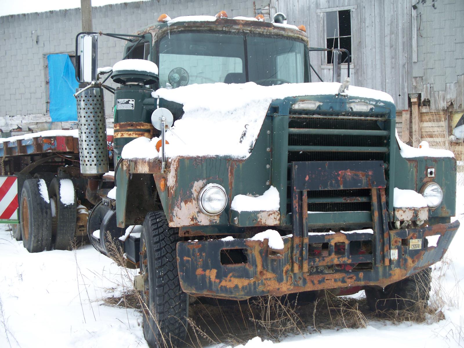

Went and drove the Flintstone around this afternoon. Ten speed and geared high. Damn truck moves right out! Front pump and the dump goes up and down very niceattachicon.gifRD 600 interior.jpgcab is clean but as you see, rockers and floor will need attention soon, a good sand blast and paint. Talk to the wise half tonight about it ;)

I bet it goes real good with the 10 speed behind that 237. Quick shifts I would gather.
Rob it does and no play in the wheel, trans. good and tight too. 97,000 on the OD appears to be original.
I would think that would be a great combo
Eric
Eric I think it would be for a road tractor but I would have thought being an ex town truck it would be geared lower with a duplex. It does move right along though :)

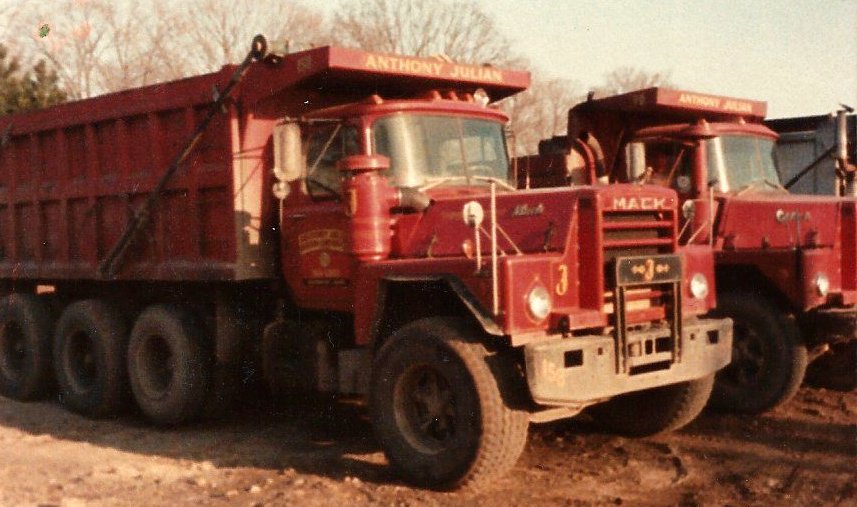

i dunno but that red triaxle dumptruck Tim posted is mean looking! theres just something about it. so I assume the chassis mounted cooler was the reason for the angled headlites in the DM hood Kscarbel?
Balloon tires and a Jake made that RD pretty nice to drive and look at and it had a duplex.
