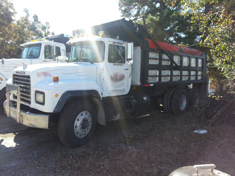

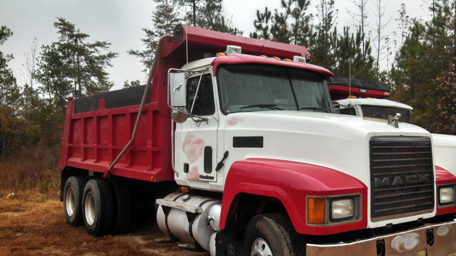

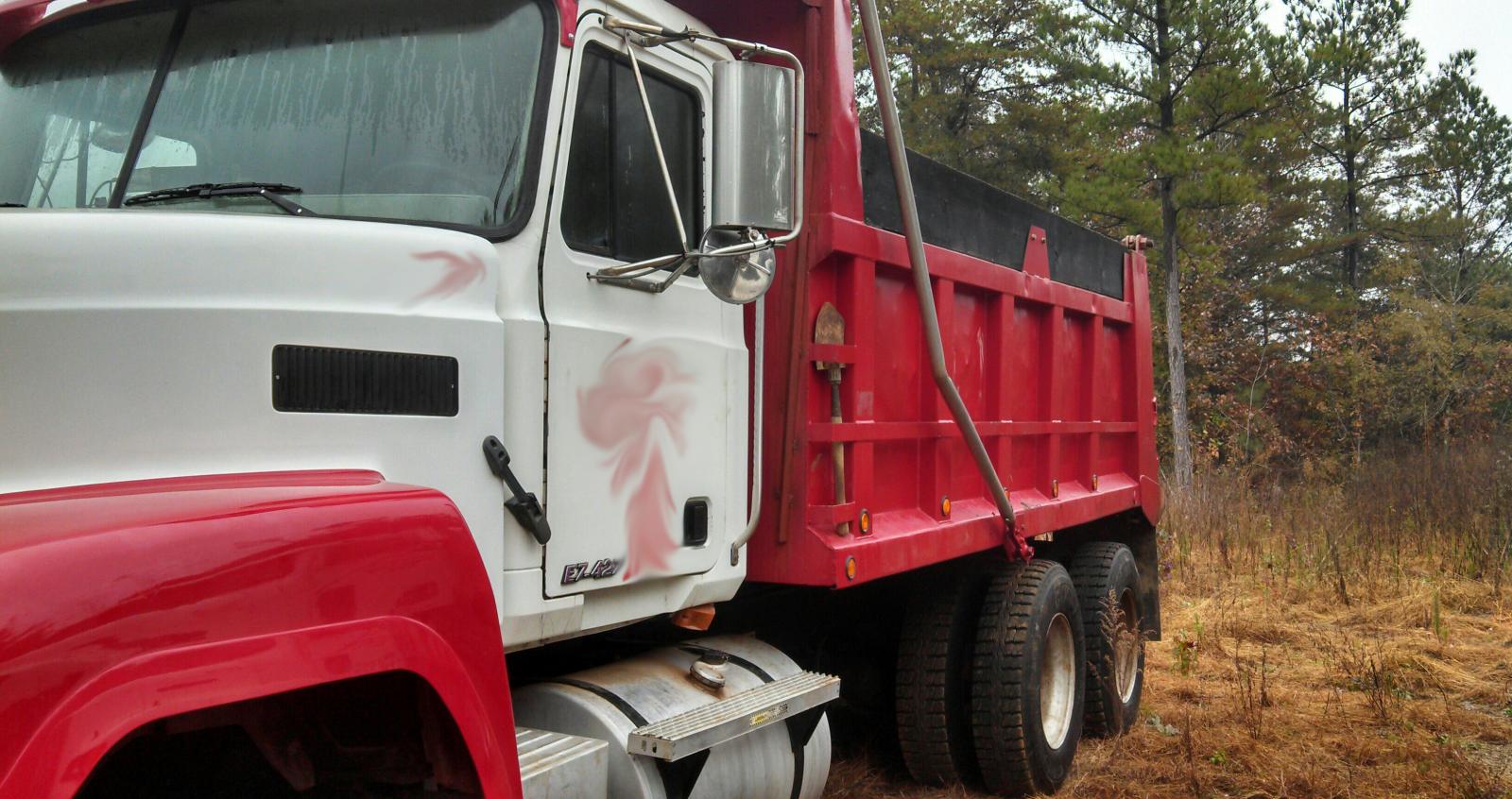

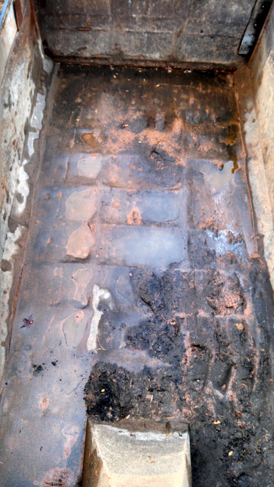

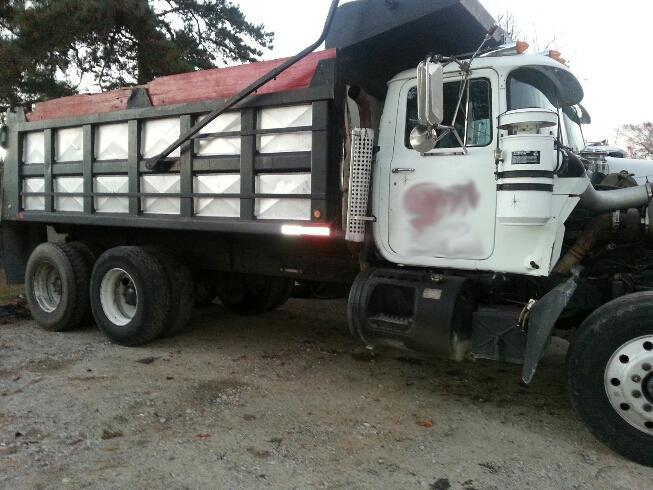

Honestly I had rather find something that fits the bill. So many of these trucks are getting shipped over seas they are getting harder to find every day. I've also found a '97 RD tandem that I'm going to shift my focus on. Here's a few pics

That chn looks like a GA truck, probably 14600 frt, 40 rears and it will need a floor in that bed pretty quick. Still didn't see any axle ratings the chassis specs would be my selling point not the looks or price.
The floor in the CH looks as it was worked hard with big potatoes. The box crossmembers are showing.Along with what others said buy a truck built for the job. The DM in South Dakota in Truckpaper looks as it has the frame that is heavy behind the cab. It could be single frame but was built for vocational work.I never drove an automatic so I could not say if good or not.I have been in the trucking business for 41 years about 25 in dump truck side. Buy whats right you will be ahead. Good Luck. Joe D.
I just sold my ch which was the same set up as the one your looking at. I owned it less than one year! the rd you have in the pics looks to have the lighter front axle also. pull the vin and have your local mack dealer run it for you. will save you a possible headache later. I upgraded the ch to a factory heavy spec truck and an so much happier.
