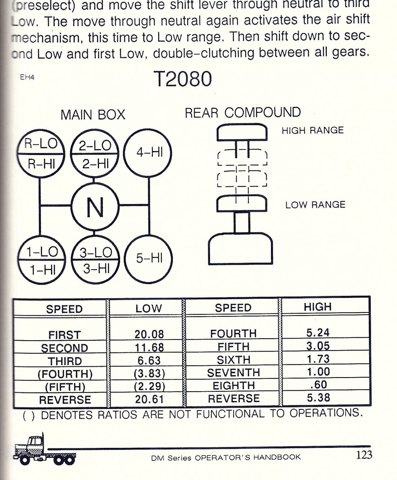

what is the gear ratio of the mack t2080 transmission. i am purchasing a truck with the t2080 with 4.33 ratio. where i from have steep hills so i want to change the ratio. any ratio recommendation. im thinking on 6:34 ratio. how fast wiill it goes and how good will it be in steep hills. engine is e7 350hp.
https://www.bigmacktrucks.com/topic/33523-mack-t2080-8-speed-transmission/
http://www.analysis-inc.com/reference/road-speed-calculator/
4.33 rear ratio, .60 final drive, 11R22.5 tires (498rpm)
If you have a 2100 rpm engine 97 mph
If you have a 1800 rpm engine 83 mph
Personally with a low rpm engine I would keep the truck with 4.33 so you have more road speed.
