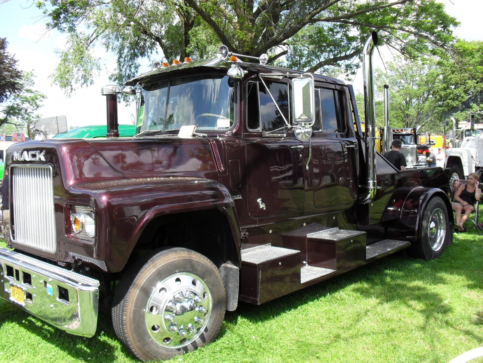

At this years Macungie there was an R model crew cab that was custom made by putting two cabs together. I forget who did the conversion but it was real professional and you couldn't tell it was two cabs.

Thank you all for such great ideas and comments. I do like that R model, but making a cf or even a MC fire truck with a nice enclosed cab would just as good for what i am looking for. I would love to see inside pics of that R model.
George
