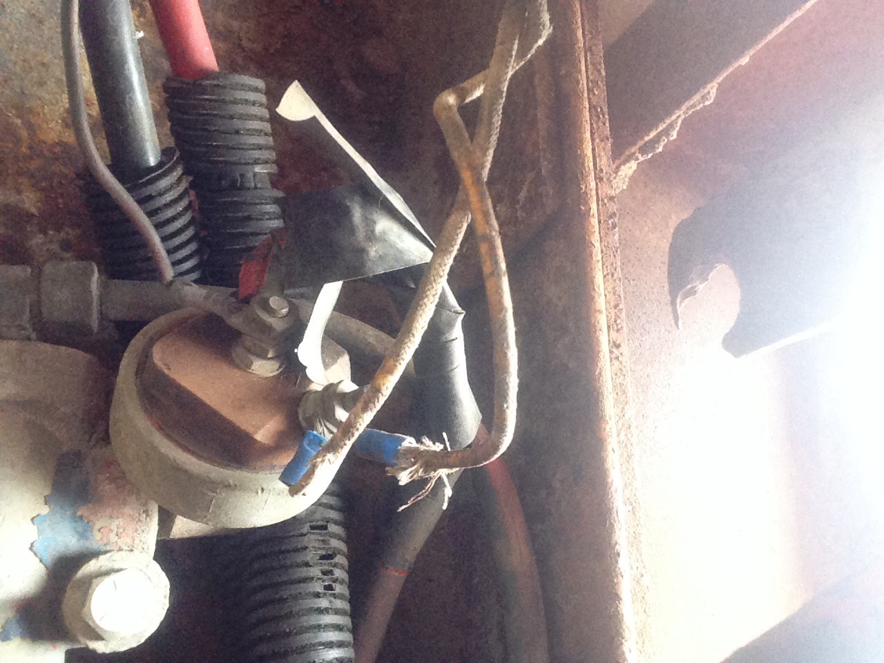

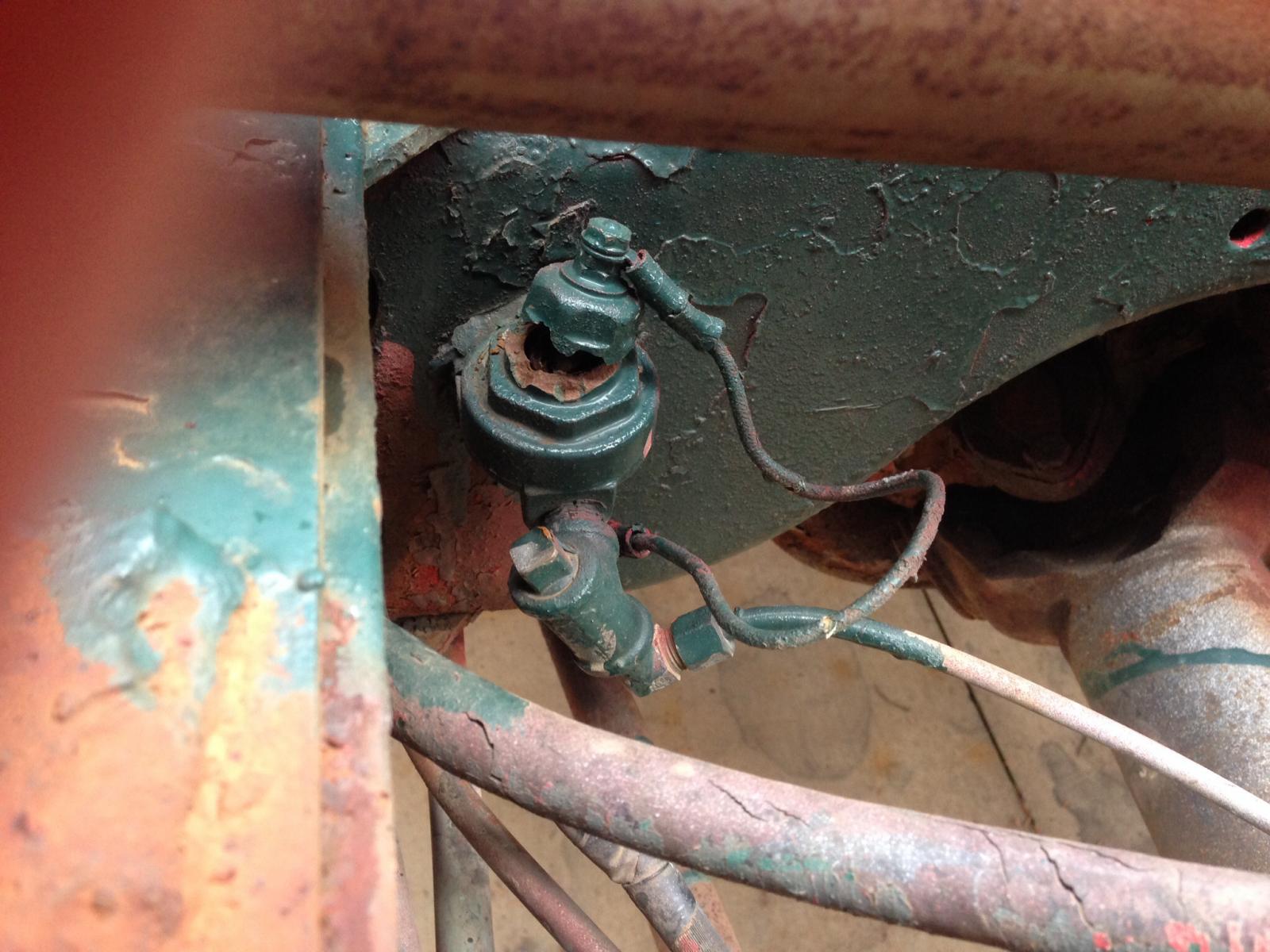

My brake lights are not working on my '58 B Model. I crawled around underneath it looking for broken wires, etc. found these two switches and do not know what there are. The first one I thought is the brake light switch since the one wire runs to the lights but not sure. Sent photos to a knowledgeable B model person and he has never seen the switch. I'm asking the BMT brain trust for help in identifying these two items.post-7189-0-03681900-1385516850_thumb.jppost-7189-0-49610500-1385516899_thumb.jp

i think the broken one is the low pressure buzzer. mine and most tractors are on the tractor protection valve teed in, for obvious reasons. I have replaced mine 2-3 times, the buzzer works for a few months then quits again, oh well. the two wire one is the brake light switch. most I have seen mounted on the treadle valve or a line behind the cab coing off the treadle valve.
https://www.bigmacktrucks.com/topic/33653-what-are-these/#findComment-218700
the buzzer is under the dash, the switch for it is plumbed into the air line off the tractor protection valve behind the cab or on dump trucks its on the firewall usually by the junction block for air. that's why there is two wires going to one side of the buzzer. one or the other is dead dpending on weather it was plumbed for a tractor or not. least that's what I have seen in most of the B's I have worked on, but they do teach me something new everyday.

sounds like someone doesn't know shit about trucks period. those switches are not Mack specific, they were on every truck around from the 40's to the 80's and most R models used the same brake light switch but it was plumbed into the treadle valve or behind the dash. the wiring looks fine to me. no need for a 1600 wiring harness. most B models are simple enough to trace the wires yourself and see what is original and what isn't. wires get broke and a new one added and disconnects, simple. a 1600 harness may fix the problem that's up to you.
