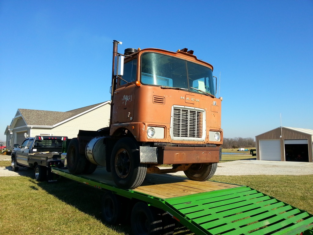

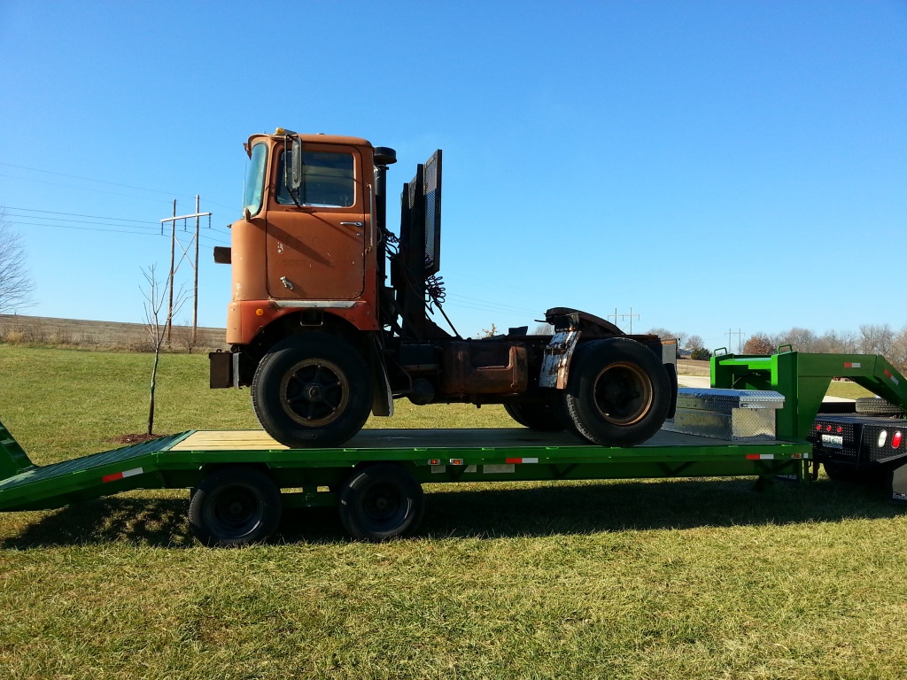

1968 F 785T Got her home last night
Go to solution Solved by 2stacksuperdog,
for whatever reason I cant paste into BMT, I sent a PM to Barry couple days ago about it have not heard back, so if you want to see the video go to youtube and search thomastractorsvc video is 1968 F 785, if any of you can cut and past into BMT feel free to post it for me.

Nice looking truck!
The first "F" models did not have hydraulic cab jacks.
They had a torsion bar lift system.
Those two round castings at the hinge point between the cab and bumper are where the torsion bars are located.
More than likely one or both of them are broken.
Anyway to tilt the cab you have to unlock the cab using the handle inside of the cab. (looks like the emergency brake handle for a "B" model)
It's at the back of the cab in the center.
The safety catch release is a cable that you pull located at the R.H. door jamb, it's cable with a loop in it.
After the main lock is unlocked you pull the safety catch and manually push the cab up.
Make sure the gear shift is in a gear that will clear the opening in the cab when you raise and lower.
It will probably be extremely heavy due to broken torsion bars, but it could always be worse, could be a sleeper!
The torsion bars for a day cab and a sleeper were different due to the big difference in weights.
I have know idea where you could find replacements, but you have to get the cab up first before you can replace them anyway.

Thanks for the info, maybe I will hook a strap to the cab and hold it so it won't fall off

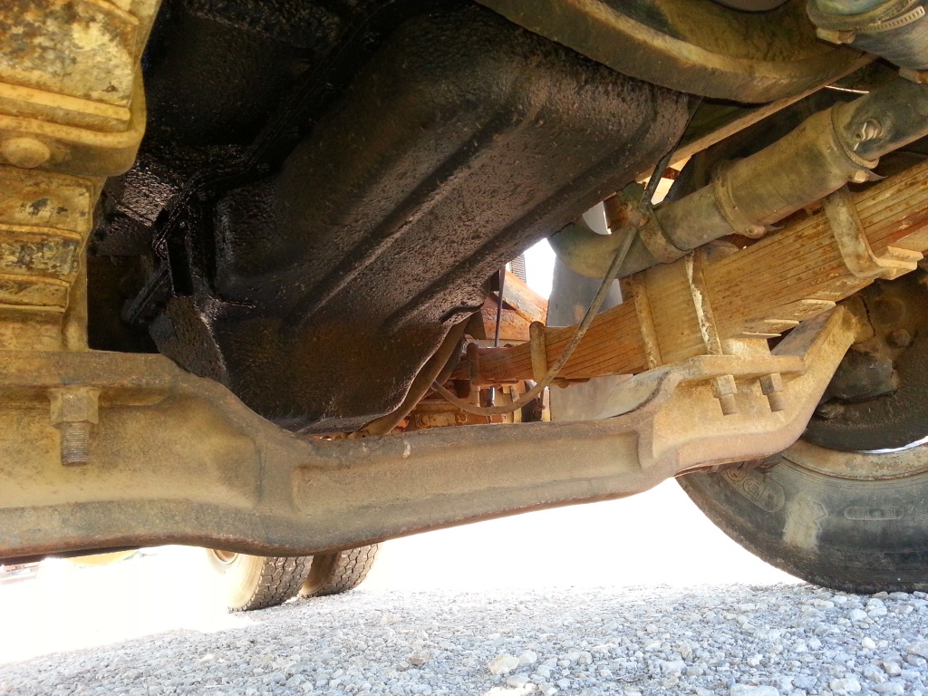

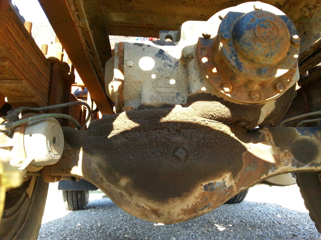

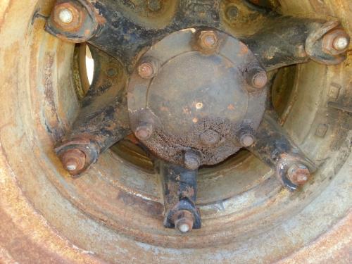

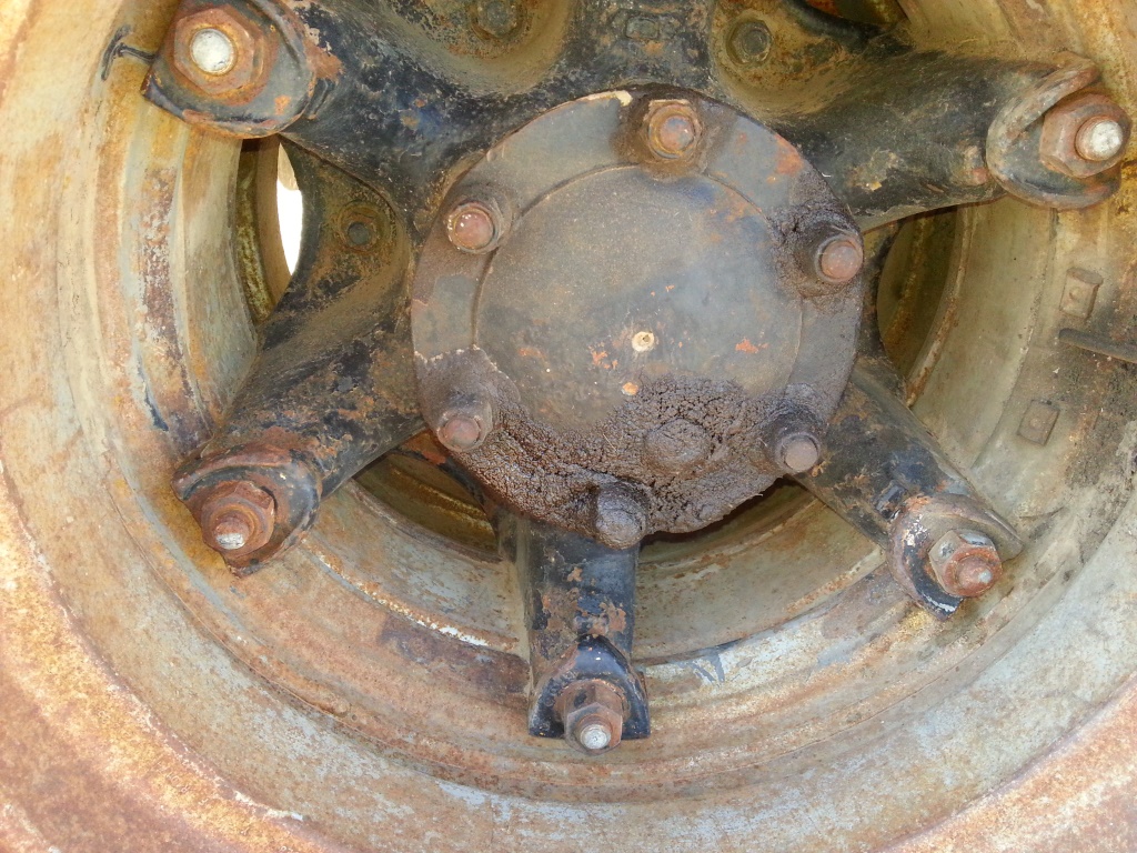

I don't think I've ever seen a single axle rear end like that,looks like front carrier out of twin screw with the rear output capped off. That's pretty neat.
Mike, that single axle g model down here I was telling you about has a top loader in it.
Jake
Cool truck! That looks the CRD-91 carrier in a RADL-515 axle.That blue/white RL700L that was at the ATHS national shows a few years back,had the same axle set-up.I always thought it was the rear axle out of a tandem also,but it has its own ratios,unique to that rear axle series only:4.39,5.07,5.46,6.45 & 7.03! Got this info out of the reprinted B,G,H,and N model operator's manual.Newer versions might have some faster ratios, I would imagine.
Thanks Al, learn something new everyday.

No problem,Mike.I think when I quit learning something new,they'll be throwin' dirt on me! Didn't seem like :mack1: made a bunch of those top-loaders,even a better reason to save it!
