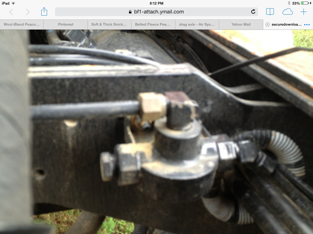

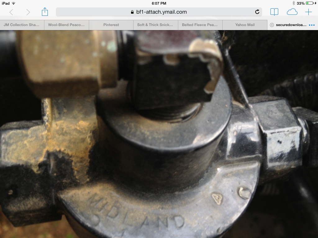

Got a pic of the valve the air is coming from?
https://www.bigmacktrucks.com/topic/33762-drag-axle/#findComment-220421
that's a QR2 quick release valve, same thing you would find on service brakes on your non parking brake axles but there would be a line on the other side not a plug, so one line goes to the control valve and the other to the air lower bags? if so swap that valve, take it off and carry it to any truck parts place and they should have one, it doesn't matter pete, kw, mack, international, fleetpride whatever you can get one there.
https://www.bigmacktrucks.com/topic/33762-drag-axle/#findComment-220462
Nope not likely, what are they plumbed into and how many lines are there on the other one? If they are ties together does the other side have the same setup? Does the line from the top of this one go to the top of the other one and a T then off into the frame? I'm guessing the raise lower valve is bad but the #1 quick release valve could be bad, hard to tell without Being able to see the plumbing.if this is on the down press bags then the pic you have there the line on top is supply air and the line coming out of the side should go to the air bag. That would mean there was a T somewhere to get one line from the control valve tied into both QR valves.
https://www.bigmacktrucks.com/topic/33762-drag-axle/#findComment-220511
well i got back to work on the truck today and i believe i have fixed it. I traced the lines back to the valve/regulator i dont know the correct name but it is the valve where you can set the pressure, i pulled it apart cleaned it and stetched one of the springs to give it a little more tension and it seems to be working. Let me know your thoughts. Thanks
