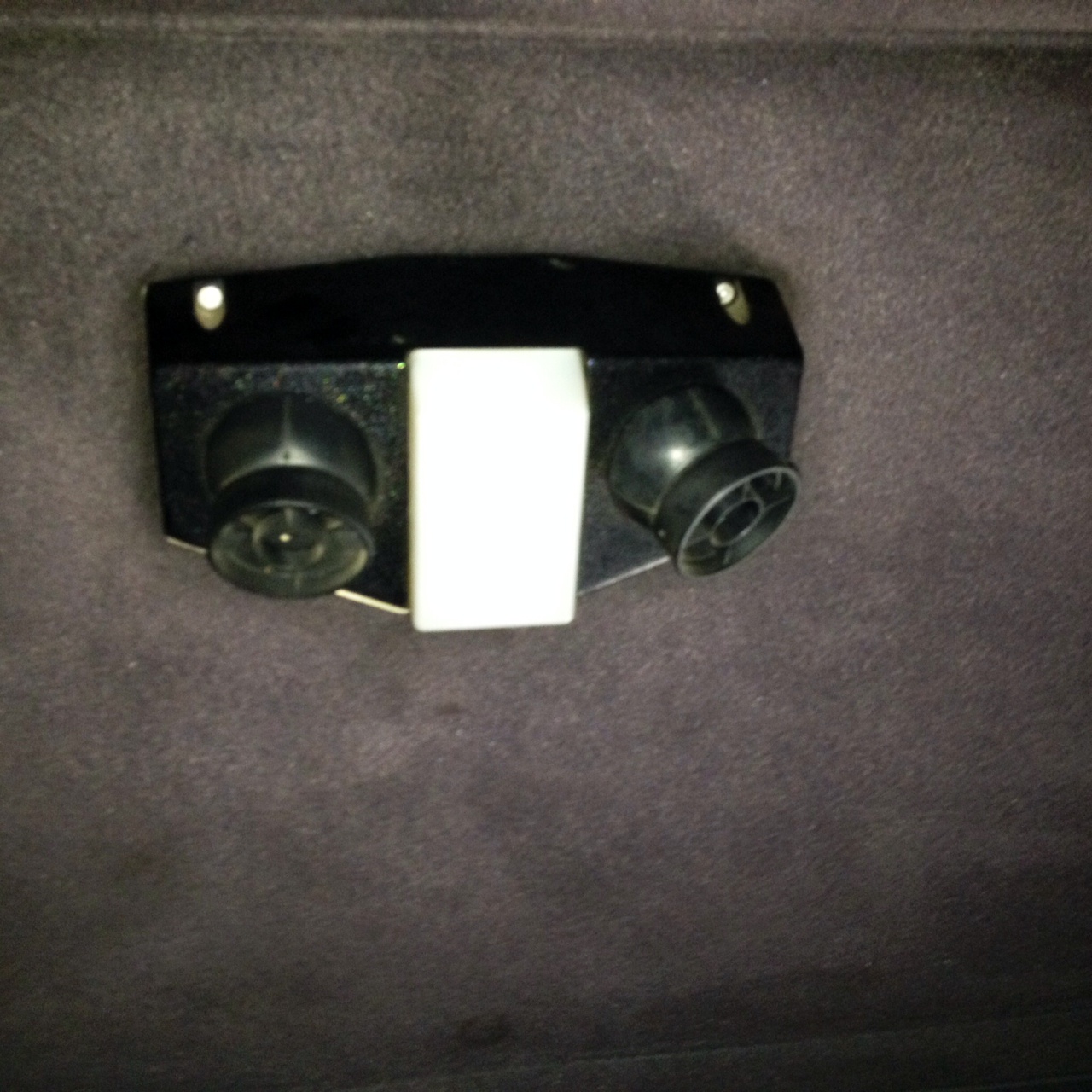

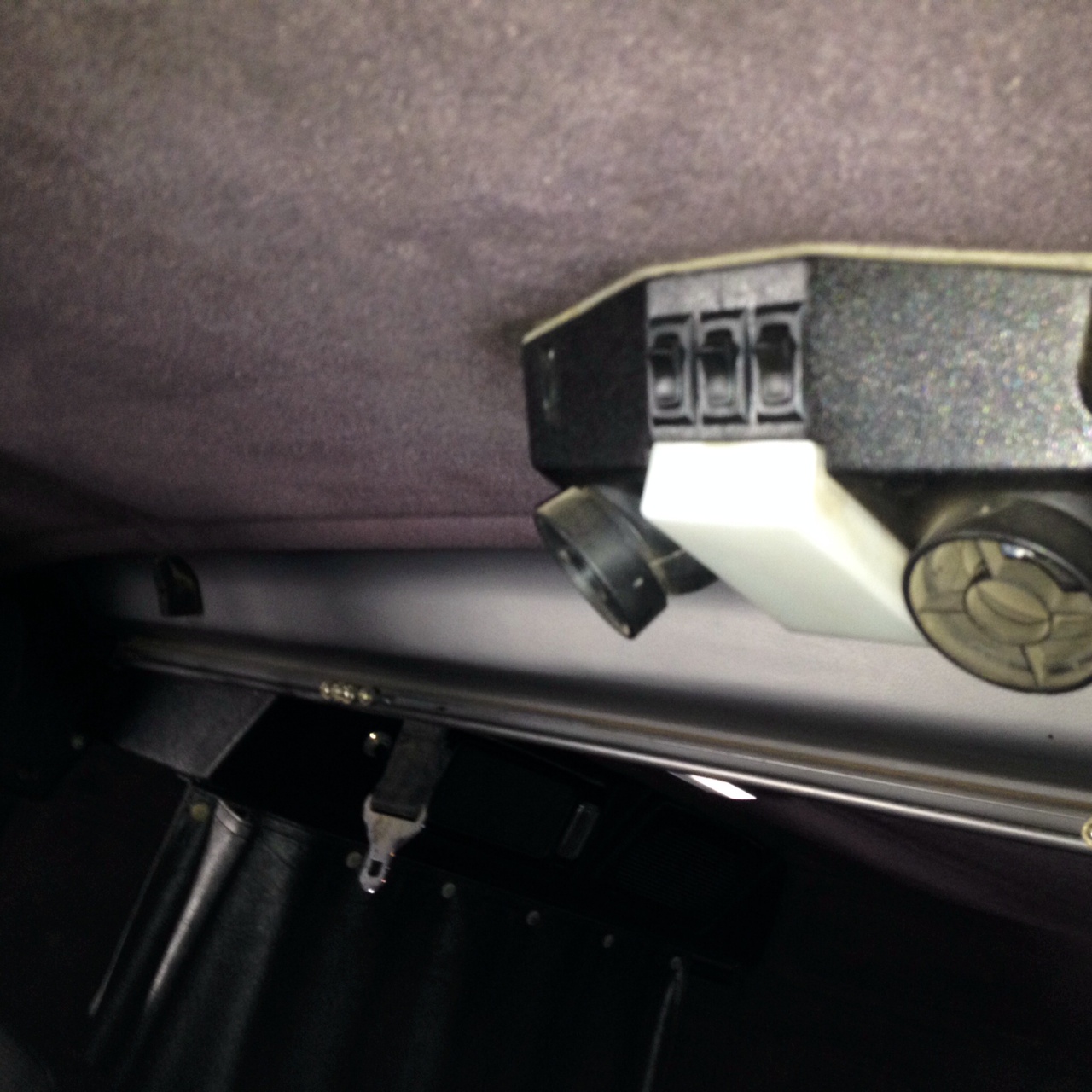

  On 12/17/2013 at 5:51 PM, Marcel67 said:
Here the interior light and map reading lights in my 93 MH E9.
Is your headliner vinyl or cloth? It looks like cloth in the pics.
Ken
Lamp manufactured by K-D Lamp Company. I tried searching for K-D but nothing. Did K-D get bought by Peterson or ?
Ken
