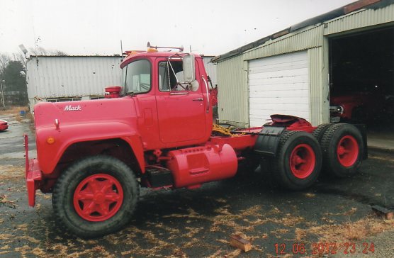

Maddog,I have done what you said about taking off the bat. cable from the terminal and it does spark,so I do have a draw.I am going to try what Jhancock said to do.Will let you all know when I have done this,hopefully will be done on Friday.Thanks for the help. Mike

My R model was formerly a municipal truck. They put a master kill switch in the cab of all their trucks to prevent something drawing juice by being left on but more importantly I was told that there was a case when something short circuited in a truck overnight and the thing caught fire and was destroyed. Nice truck you have, by the way. I like the red rims and fuel tank. You don't see that everyday. What does it have for a transmission ?
