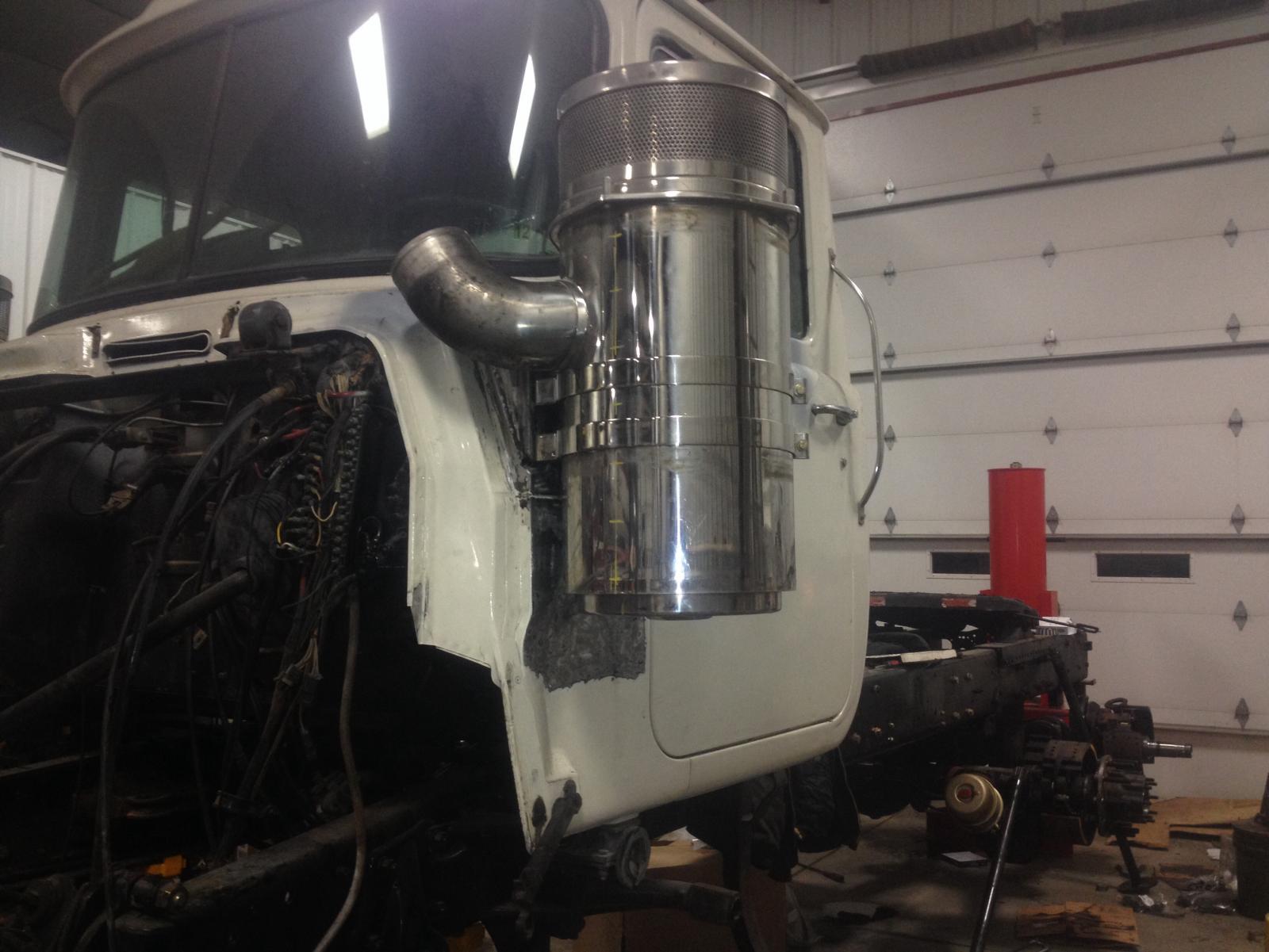

I'm waiting to get some pics back from a local salvage yard on 13" breathers off a Freightliner. I think for brackets and bands I am goin to order them through Mack if I can get them in stainless. Looks like if I take out the driver side vent then make inner support brackets I should be able to bolt factory brackets to the cowl. Then I assume super liner breather tubes should work. Or I may have the company who is doing the exhaust build stainless tubes.

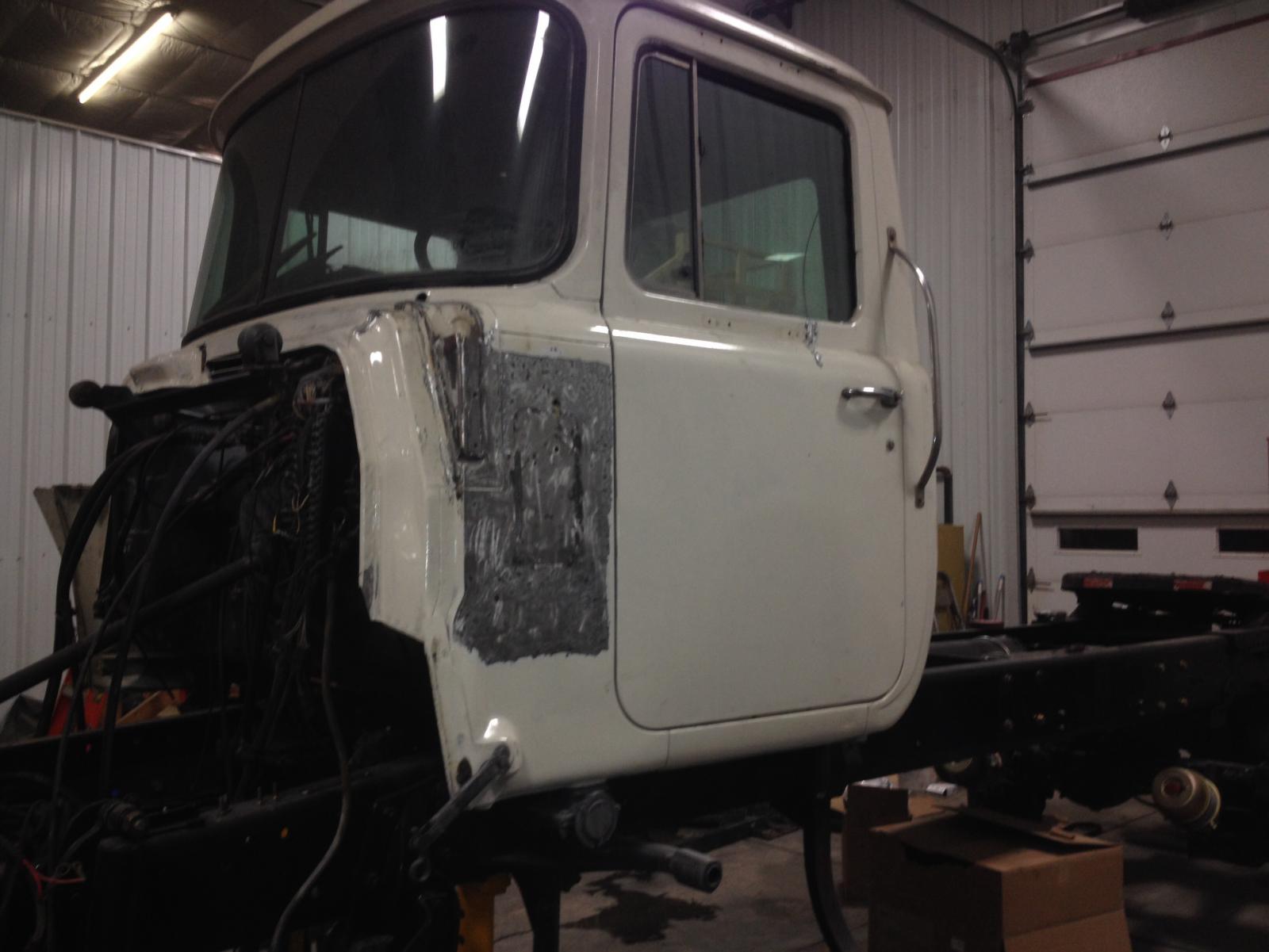

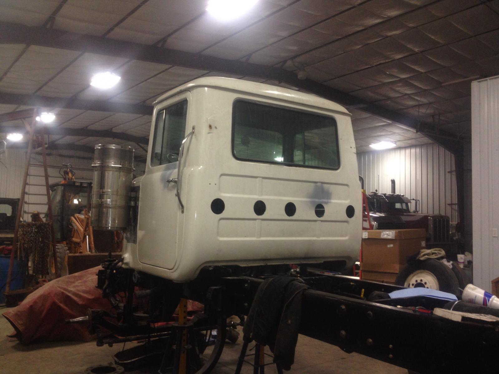

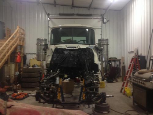

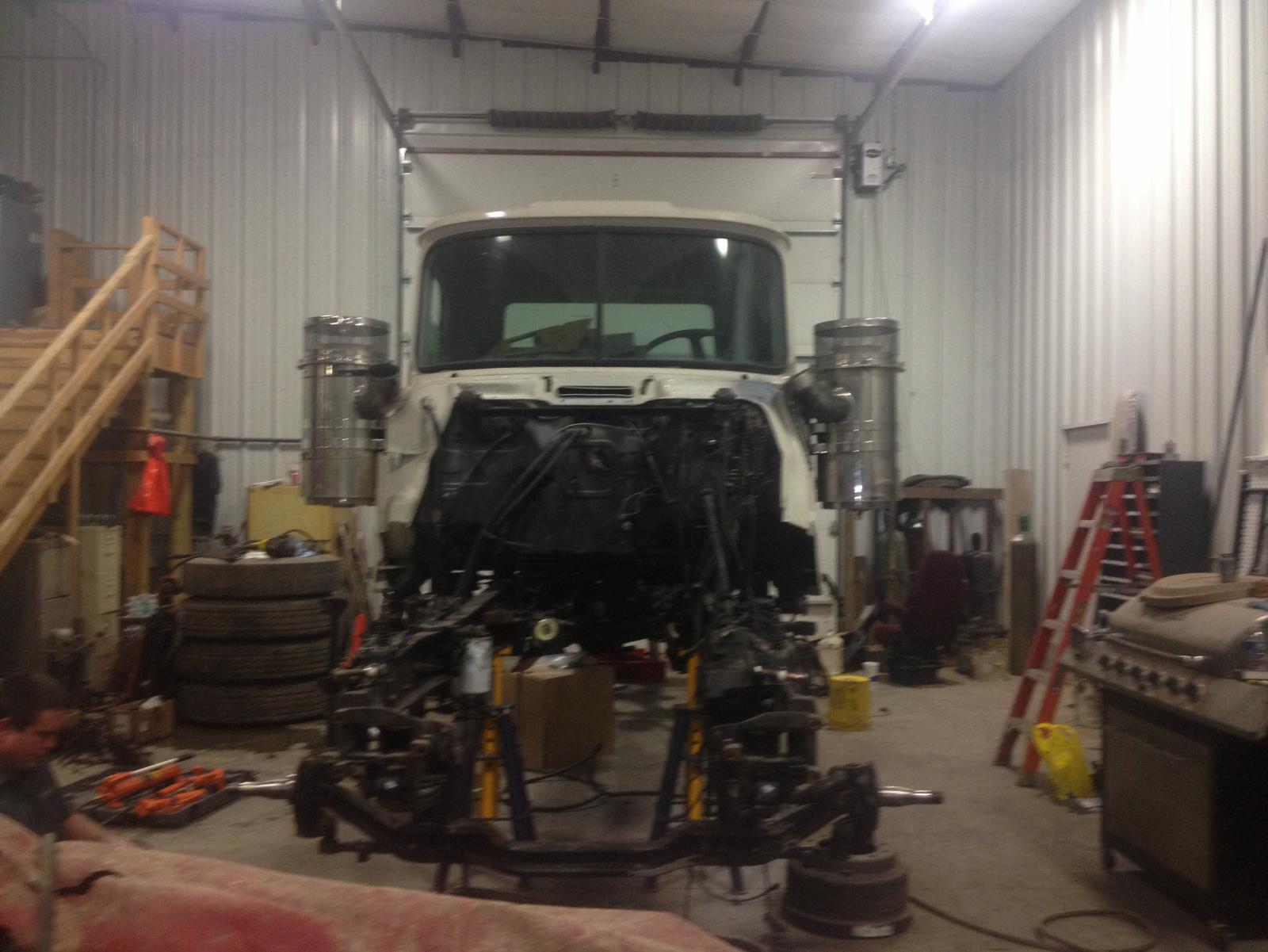

No vent not usable. To line the brackets up identical to passenger side have to plate the vent and extend the front of cowl panel to mount in same spots. I just used 1/4" flat metal on inside of the cowl to reinforce it. Everything good and sturdy. Only thing may do is shim the top bracket. The breather follows cab line so it throws it about 1/4" out of square. Can't notice unless you know or really focus on it
