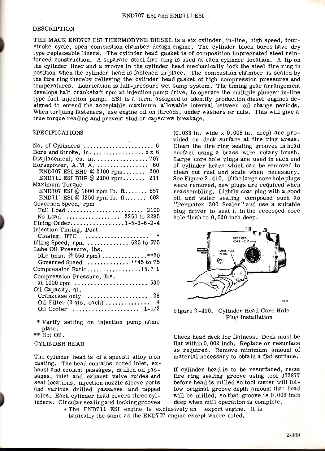

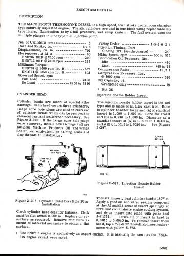

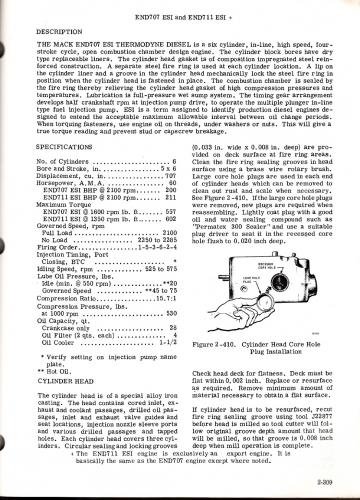

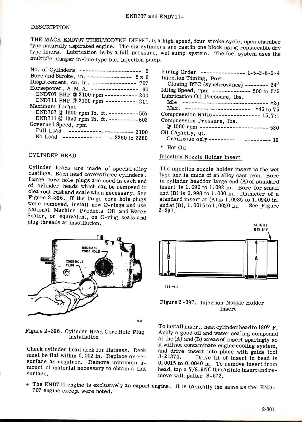

Found some info in a book with a revised date of 1977.
END 707 ESI and END 711 ESI had the fire rings. Non ESI didn't.
It is interesting that the footnote showing the 711 as export only.
Send the 711 out of the country!
