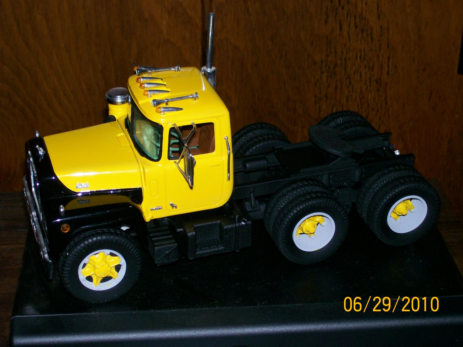

Here's a pic of a model I built some years back. It's the same paintjob. Planning to paint my R611 this way......someday.
post-11199-0-44530000-1389486756_thumb.j
