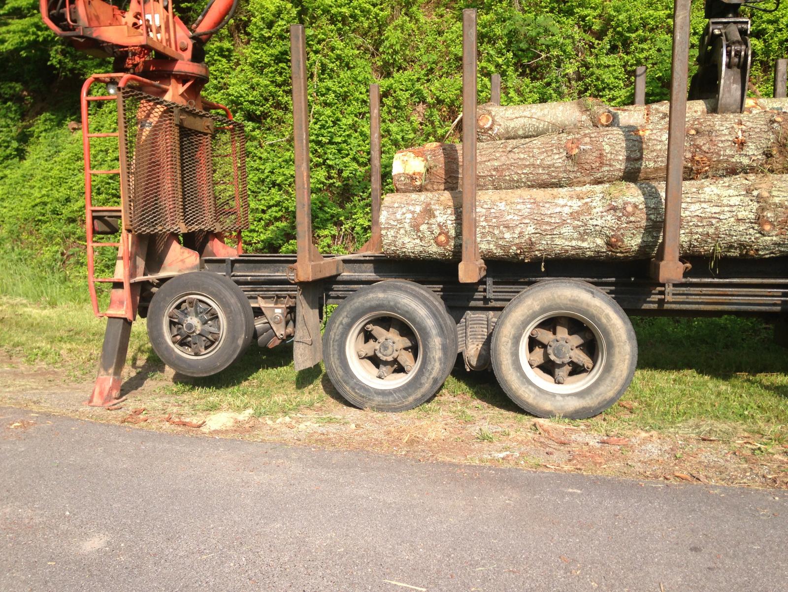

I've been hunting for a steerable lift axle to use as a tag axle on my RD 688S log truck. Want it configured as a tag because I have a heavy knuckleboom loader mounted at the very tail end of the frame, and I can't haul very much payload without being overweight on the axles. Want it steerable because I've been told a non-steerable tag axle will make it impossible to steer on the many curves on our Appalachian mountain roads. Want it cheap b/c, well, there's not much money in logging these days...
So I found a used steerable lift axle from a local paving company, with a large fleet of dump trucks. This one was taken off an R-model dump truck before it was sent to the quarry... Best I can tell it looks like someone took a front axle and a lift axle and put the parts together. I'm pretty sure I can't run it like that or it will wobble all over the place...
Is there a way to cut the tie rods and attach them to some stiff shocks and/or springs to stiffen the steering up but still allow the axle to steer?

there is a spring over shock set up for use in this application it clamps to the tie rod no cutting involved and can anchor to the lift brackets.
find your heavy truck parts suppler and they should be able to get you a kit to do this. For a log truck i'd make sure that you have a long travel drop axle.
the last thing you want is to cross a water bar and have the rear of the truck off the ground and at the mercy of a steerable axle. (gets kinda interesting)
My experience with steerable tags is that they like to steer the ass end of your truck around. Especially if your on any paved roads with the lanes kinda "worn in". My last one I actually had to put a air locker on it. Its basically a brake chamber with a finger that'll go down into a lock that's bolted on your tie rod bar. Then when you turn a corner u flip the switch and unlock it.
springvalleymfg.com they make tag axle lits to use a truck steer axle with, i just got a quote for myself last week, beats the hell out of a new one for $6000 when the kit is just over $2000 and I can get a steer axle for $250.

Ha, I just found it, wish I knew about them several years ago, they offer two models the Ss120 is good to 16,000# the other to 22,000#. I'm looking at the SS120 and a 14,600 steer axle, the steer tag I got is a heavy ass Watson chalin that's been butchered to remount before.
A couple guys are looking at pusher axles to mount on straight trucks in this area. Had one on my RD at one time. Non-steerable,but it did what it was supposed to. Used ones are around. But they tell me finding one that is correct for their application,can be tough to find. Our mixers at work have the hydraulic "booster" (tag) axle set-up on them,which is steerable. The drivers say it can be a real bitch at time controlling the damn thing. Staying on your game is a must! Seen a few of them lose it on a straight road! Wheel drops off the pavement and they get squirrely! It adds several feet to your bridge (good for the truck's owner),but can act like a unwanted "wheel lift" for the drive axles at times!

Local heavy truck parts supplier can sell a shock/spring kit for this...Also can sell me an add-on and/or replacement controls that will wire in to my reverse so that the axle will raise automatically when in reverse. Only thing I needed to make sure of is that the kingpins aren't welded fast (they're not, just need a little bit of grease) so the front axle will steer.
