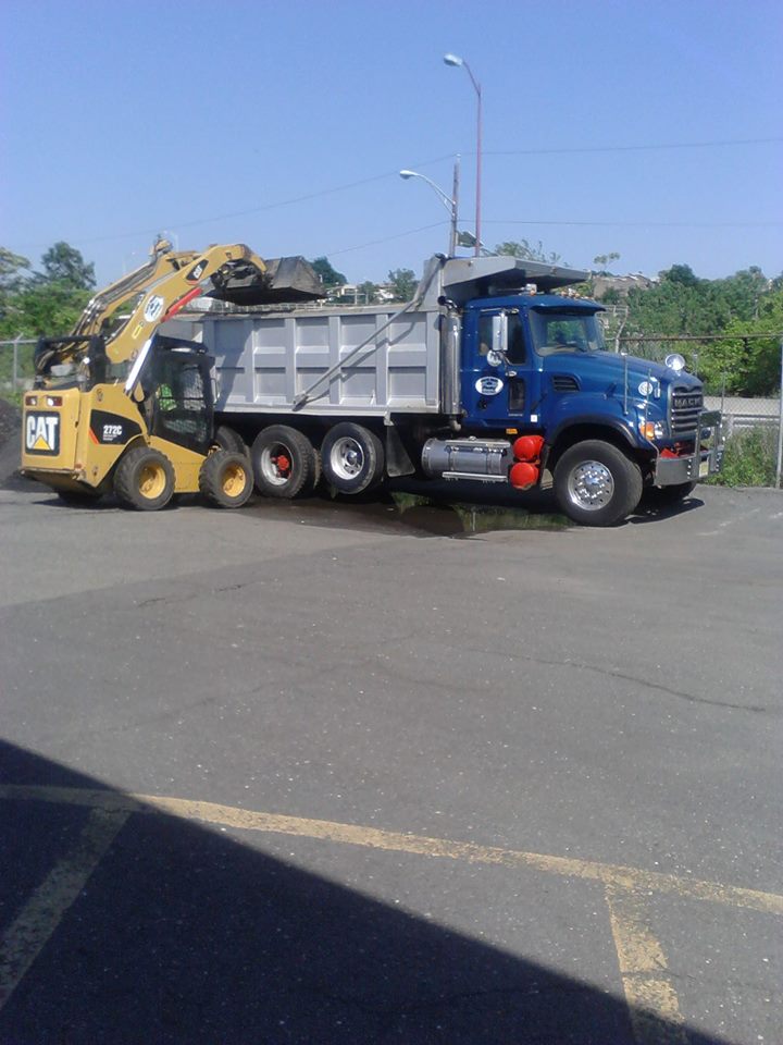

Highly doubt this is an original NY truck based on those axles and pusher
Seen that axle arrangement upstate NY a lot. Don't ask me to explain their weight laws but I know guys that run a standard tri-axle in PA 73,280 gvw get busted down to 58,000 gvw if they cross into NY

New York State Bridge Formula: 34,000 + (1,000 x Overall Wheelbase in feet, rounded to the nearest foot) State Bridge formula Example: 4 axle dump truck with a 20 foot overall wheelbase; 34,000 + (1,000 x 20) = 54,000 pounds.

And the same 20' wheelbase tri-axle in NJ is legal for 80,000 gvw. Go figure. Not enough brakes to stop 40 tons IMHO, assuming the lift axle will bounce and lock up in a panic stop anyway.

actually, that truck is legal for 80k in new yawk too, if it is registered for it.
i have apportioned plates on my truck and am legal for 80k in all states. but i am only legal for 54k over the bridges.
 the lift axle only bounces on braking if you are not intelligent enough to properly set it. i keep mine set at 70 lbs or so and have no problem. but i see others that set the lift axle at 30-40 psi and the axle hops all over the place every time they hit the brakes.

Unfortunately, for every responsible sensible operator like yourself, there are 10 dumbasses out there who don't get the proper permits or know how to set the air pressure on their lift axles. The laws are basically idiot-proof to protect us from the idiots LOL. We have a local problem here in East Bangor with tri axles running into the Quarry with waste material from New Jersey and New York City... running overweight dodging the scales and wreaking havoc at every turn. Mostly immigrant operators working for chump change... I guess you get what you pay for.
New York bridge law for 54,000 is for what they class as a divisible load (sand, gravel etc) and the law is different for a non divisible load (container, large freight etc) Basically the 54,000  limit is to get you to buy a permit, has zero to do with anything but money, same as the NYHUT  $$$$
