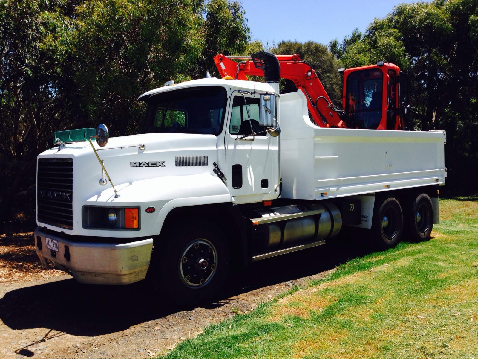

This rattle drove me insane! It actually ended up being the hood. Where the hood goes into the pockets when you close it.....they should have rubber on them. I lost on of the rubber pads so the metal would rattle in the pocket.
My Ch did the same thing. Drove me nuts until I figured out what it was.
