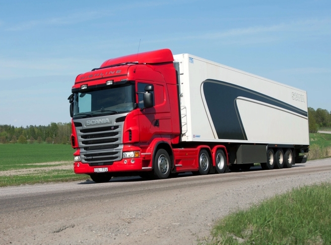

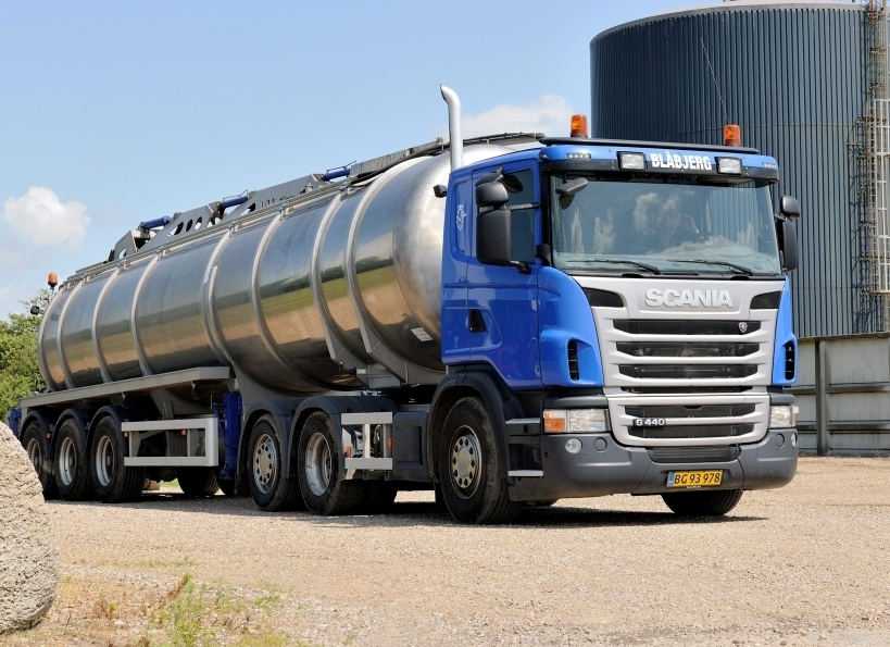

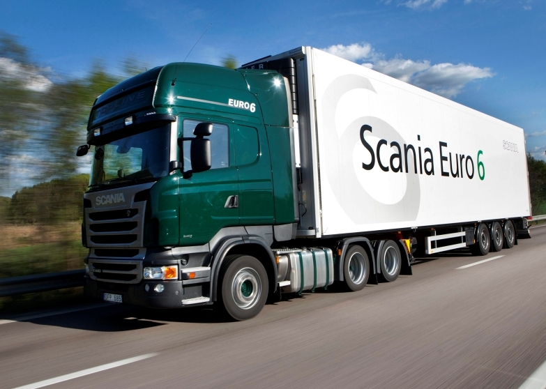

We've talked about 6x2s before (http://www.bigmacktrucks.com/index.php?/topic/34359-nacfe-report-lays-out-6x2-axle-advantages-and-drawbacks/). I think complaints in the U.S. market are related to the primitive 6x2 arrangement being promoted here. It doesn't even come close to comparing with the much more refined 6x2 designs in Europe and elsewhere.
Whether the dead axle is forward (pusher) or aft (tag) of the drive axle, they should be steered (single tire) and liftable.
In Europe, they do run some non-steered (liftable) tags. But those trucks are running at 44 metric tons (97,003 lb).
Page 6 (11) https://til.scania.com/groups/bwd/documents/bwm/bwm_0000027_01.pdf
  • 6x2/4 - Six wheels, of which two are driven and four are steered – by means of an additional steered axle ahead of the drive axle (twin-steer)
  • 6x2*4 - Six wheels, of which two are driven and four are steered – by means of an additional steered axle aft of the drive axle

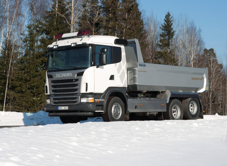

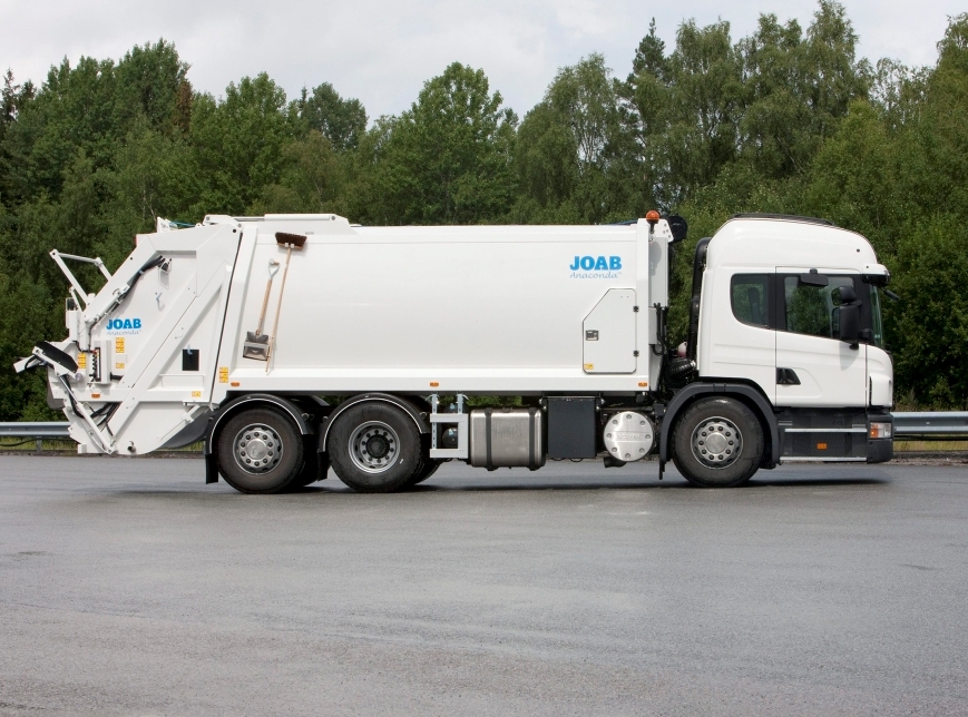

Noting the examples above of Scania 6x2 vocational chassis (rear-loader refuse and tipper), I can assure you that when equipped with a driver-controlled inter-wheel differential lock, the 6x2 is quite capable off road.
