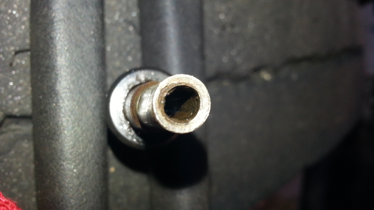

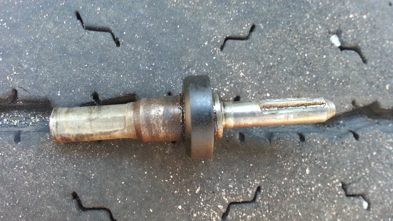

I know this has come up before, but I'm still unclear about it. So, 'xplain it to me! And, as always, pictures help.
Need a tach cable. May need a tach too, but that's another discussion.
The build sheet calls for, I believe, a 54MT314AP88 cable. The one on it now is longer than the 88" implied by that number, and the engine end has been spliced for some reason. Maybe to adapt the end? Maybe something to do with the drive pin?
Numbers available now are 54MT314DP88/94/108, etc..., suggesting revisions have been made.
This number series shows up as a "speedometer" cable in several places.
Are the tachometer cables standard speedometer cables? And, if they are, how does one deal with the odd-ball drive gizmo on the engine end (see pics)? I don't believe a standard square speedometer cable can stick into this thing and still thread on...too long, I would think. Or, is it? That gizmo sticks up quite a ways from the drive gear. Do you stick the cable into it and stake it? Or, would the end, shown below, interfere with the sheath?
Please help!
post-11199-0-46338300-1394403188_thumb.j
post-11199-0-49083200-1394403203_thumb.j

Okay! So the cable comes with different tips, and you pick the one you need? That makes a little more sense.
And, yes, the drive tip is in pretty good shape.
