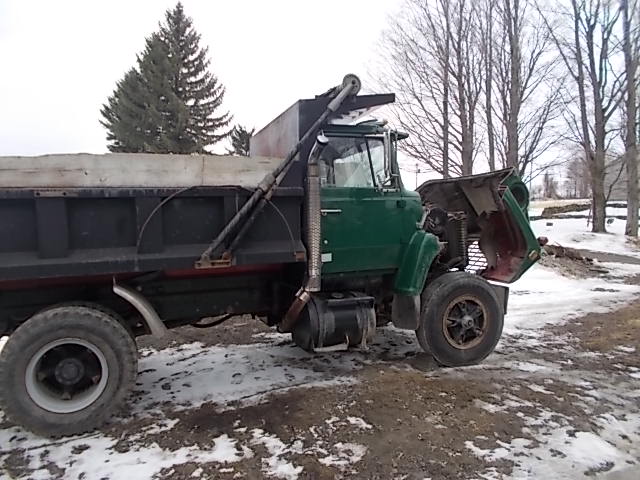

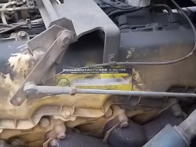

hi all I got the truck and am very happy with its condition. I know I will have to replace the throwout bearing but some grease really quieted it. my big question is the waterpump is quite large with several protrusions. each head has about an 1 1/2 pipe going into this large pump casting. there is what looks like an oring on each. both sides have a slow drip, doesn't spray when hot just a slow drip. any suggestions? its a 3208 and the tranny is actually 5+2. thanks.

for that price you cant go wrong, and if that is a reman engine and it runs good it should last you a long time. body and cab appear to be good also

thanks, unfortunately the two orings that go from the heads to the front cover are seeping antifreeze. there is no easy fix. my research says the heads are the way to go. but since the engine has low hours and doesn't smoke im going to go for the front cover. I realize its no mack but my chances of passing the road test are much better in this truck. my father drove it back from Hartford ct for me. this was one of the most stressful days of my lifeit was 180 miles one way. ibrought everything from a generator to a fire extinguisher. not many old trucks look like that around here.
