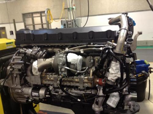

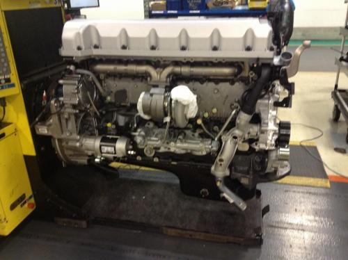

the 445 rating is pretty sweet for a 13 liter engine if you think about it, at 505 it would be a true beast, the 12.7 series 60 detroit 500hp engines were nice but they tore themselves apart if they werent handled properly. Its hard to get that much power and torque out of that kind of displacement after having to add all the emissions crap on top of it all. If you think back it wasnt all that long ago that 500+ hp for a 14 liter was impressive, I remember the N14 525 rating being a haus but I also heard of several flying apart, same for the 550hp 3406E. I just dont think you can get that m uch power density out of an engine keeping it emissions legal. That said, dump all the emissions crap and put a good simple turbo on an MP8 505 and I bet it would be a beast just by losing all the restriction in the intake and exhaust. I know that once you dump your emissions control systems and go with a non emissions freindly program you can make plenty of power from a 12.7 detroit, Cummins or Cat, just call Pittsburgh Power, Edge or Diesel Freak. I have a Diesel Freak adjustable power kit here for a C15 that is said to add 90hp and 250# and they say they have the dyno sheets to back it up, I know folks that run em and they say it is a huge gain so I say screw the EPA and make em smoke, they run better that way.
https://www.bigmacktrucks.com/topic/35023-mp8-505-pinnacle/#findComment-238388
never seen those, they did a non emissions aset engine at 480hp for the military in the ill fated Granite military truck, the ones they actually bought to my knowledge were off the shelf Mack powertrain with allison transmissions. There have been some non emissions MP7's sent south of the border but Ive only seen pics of them thru Staxx, I am sure they could make them however they wanted but they probaably wont help us get there.
https://www.bigmacktrucks.com/topic/35023-mp8-505-pinnacle/#findComment-239381
I popped the hood on some of the Export setback axle Granite's with small sleepers at the factory last year. My Father and I were drooling at the idea of how much more powerful and reliable those MP8 powered non EGR etc. trucks would be.
https://www.bigmacktrucks.com/topic/35023-mp8-505-pinnacle/#findComment-239406
The Turbo on the Non-EGR engine is also not a Vaned turbo. Didn't notice the make but it is not a VGT trubo (Variable Geometry) I believe the Holset is a sliding nozzle but complicated just the same. Oh how I yern for the simple diesels in life again.....
