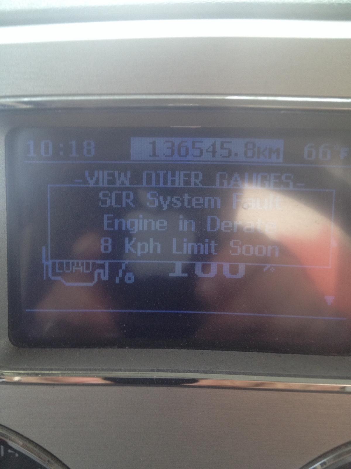

Second time in a month, cel and a message "SCR Fault, engine will derate soon". Code come back def system loss of prime. Sitting waiting at Mack now, and there's a crew of roofers and a crane waiting on site for me......frustrating.

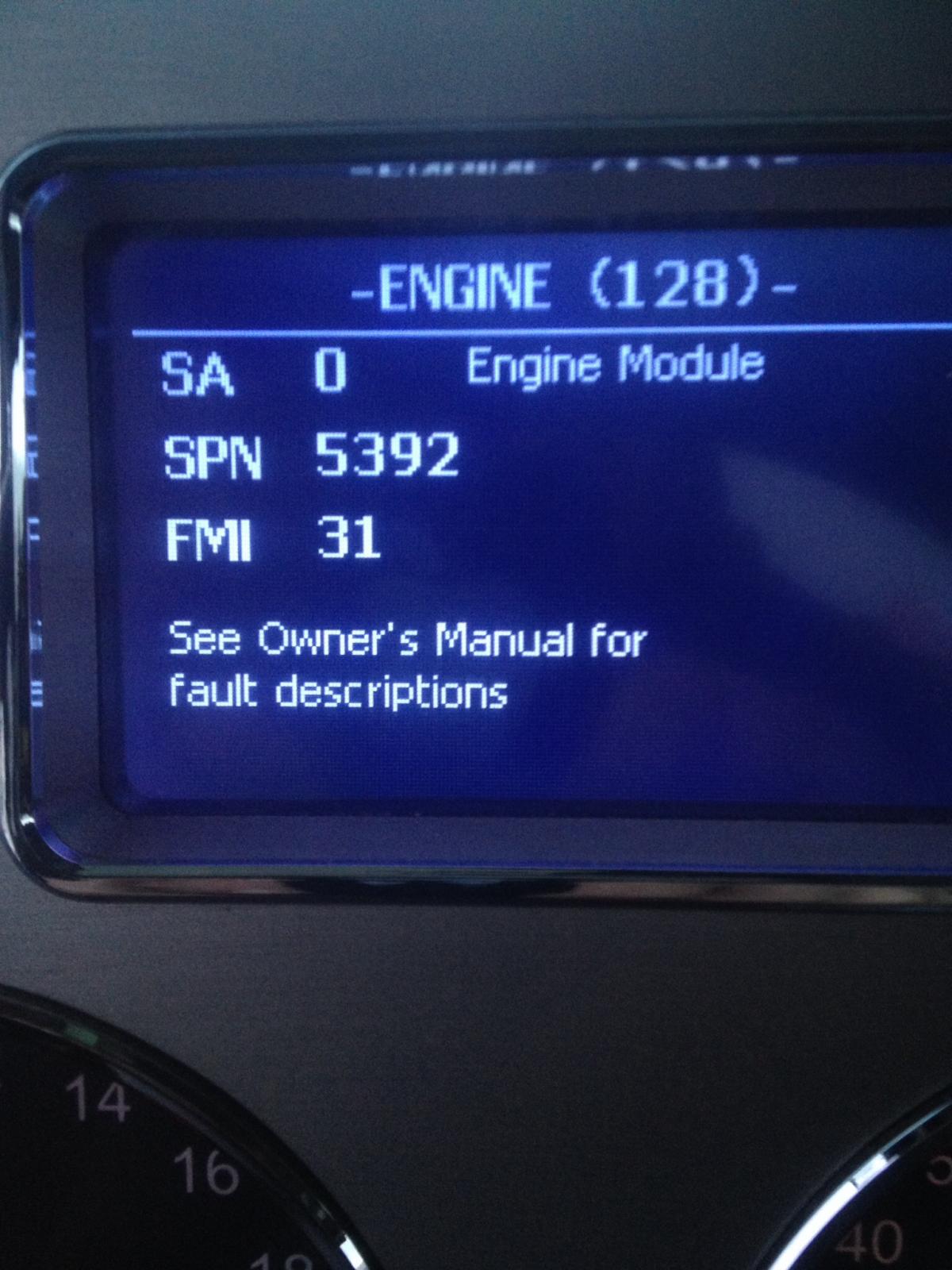

ECM SPN 5392, Aftertreatment Diesel Exhaust Fluid (DEF) Dosing Valve Loss of Prime – MID 128 PSID 121
FMI 31:Aftertreatment Diesel Exhaust Fluid (DEF) pressure build up failure-
Possible Causes:
  • Empty DEF tank
  • DEF filter clogged
  • DEF inlet pipe leak or blockage
  • DEF pump assembly
https://www.bigmacktrucks.com/topic/35275-scr-fault/#findComment-240670
They had it fixed by 4:00 that day. Looks like a new def doser.... When I got my stuff out of it, they had the steps and kick panel off the passenger side of the fame and were working on taking the after treatment system apart.

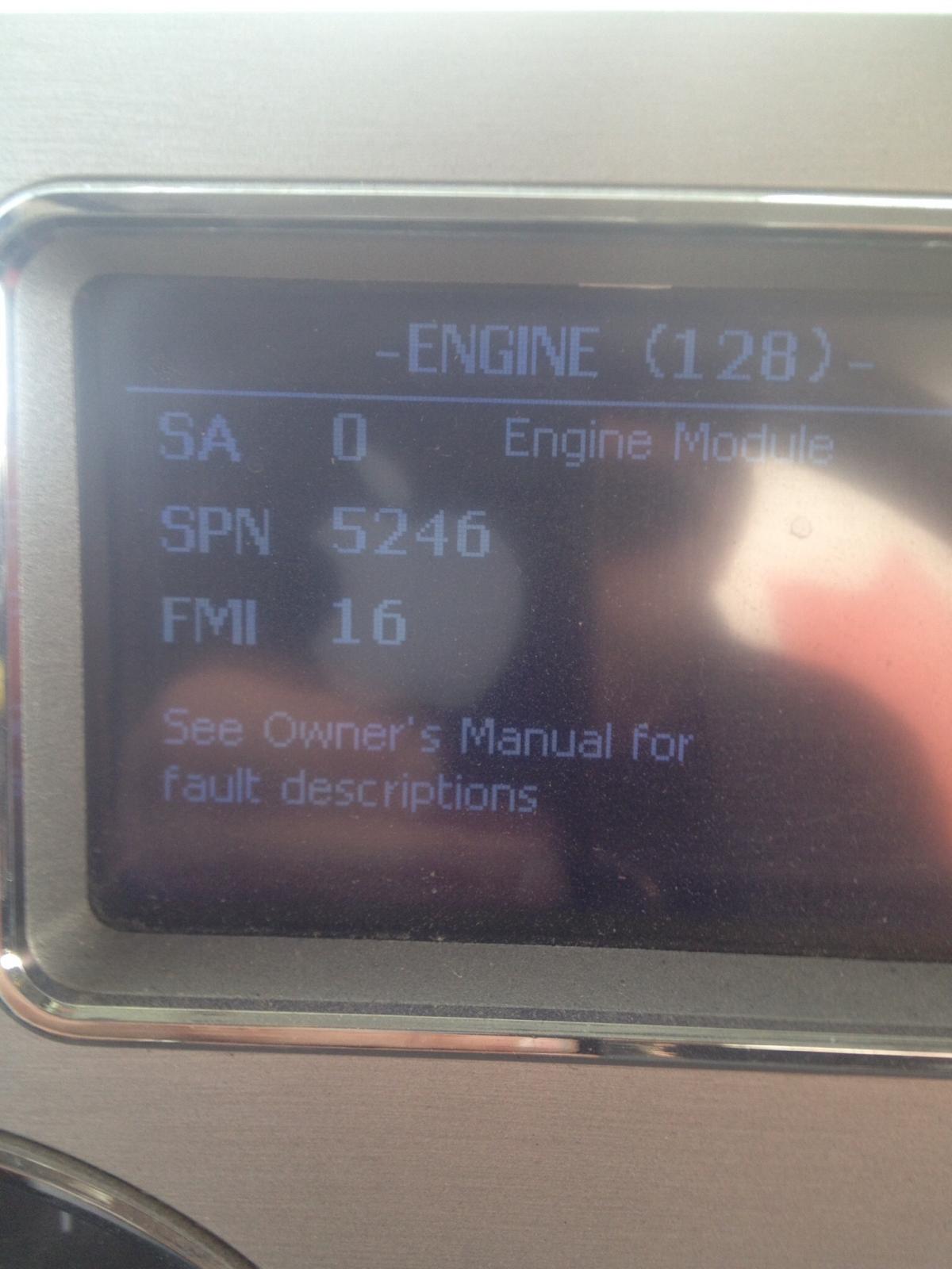

Just around the corner from Mack and I got this "new" error message

When I got to Mack, I checked the codes and got the same old 5392 loss of prime code and this one

That's what I keep reading......and it been in at least 3 times (this last one might have been 4, but my memory sucks) with the damn codes and it keep happening. I was actually starting to wonder if DEF "salts" like fertalizer does, and if the crystals float or sink. Seem every time it's happens the def tank was between 1/4 & 1/2. Maybe plugging the strainer??? But then I also read that the pump pulls DEF from the lines back to the tank on shut down, would that not effectively clear the strainer temporarily???? Crap.....thinking out loud, and now my head hurts....where's my damn beer :)
