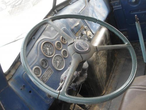

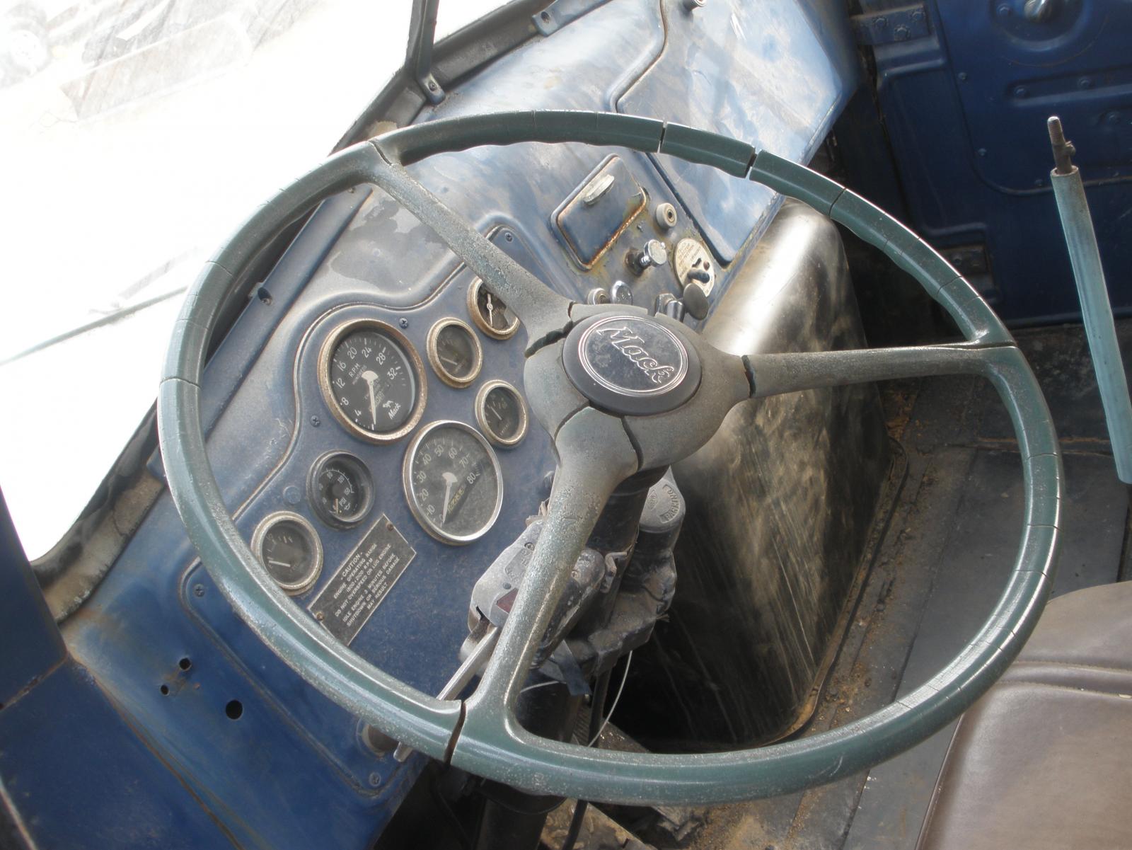

Recently purchased a 1965 B-67 & hoping to restore. Truck has manual (not power) steering & 20" diameter steering wheel in very rough shape. Would like to replace wheel - any idea where to get one?
Also this truck is like ones I drove in 1968-72, which had a pale green interior. Would like to re-paint this one to match. Anyone know exact paint color?
Thanks for any help, WC Hall

I repaired the Steering wheel in my 41 Chevy Convertible and another for my 1963 Corvan with the Eastwood's Steering wheel repair kit. Works very well if you follow the directions to the letter. I double cleaned the cracks to be sure. Paul

I have had good results with sandblasting the cracks (the wheel has a steel core) and using a plastic bumper filler after I have V'd out the cracks. You can then prime & repaint.
