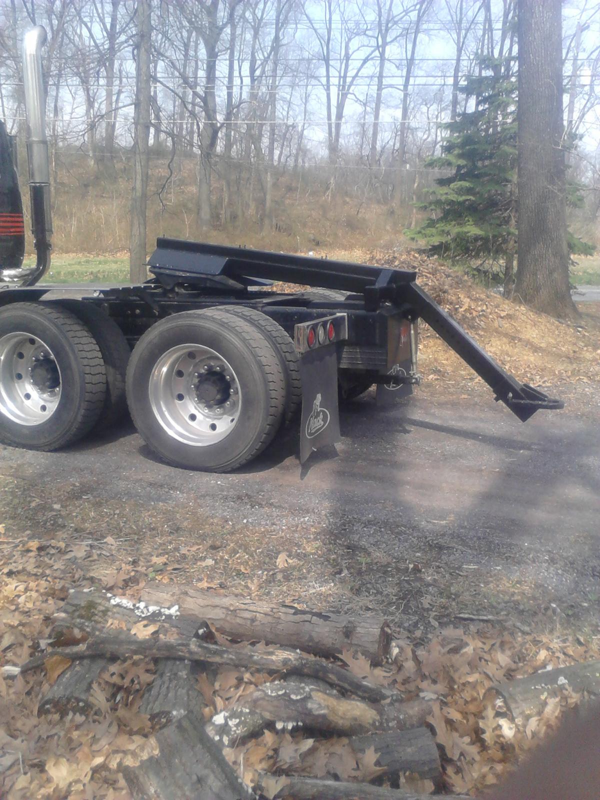

I have used industrial enamel sold from Cloverdale Paint which is now called Rodda Paint. Cost about $35-40 a gallon. Not a show truck finish but very tough and reasonably priced. Sales guy told me it was self priming and has rust inhibitors in it.

Agree with the POR 15. It will actually trap the rust. Expensive when you compare it to other paints, but its WELL worth the few dollars extra. A little goes a LONG way. Great stuff but do put something on it as it will fade when expossed.
Last thing I used it on was a dam gate for a small hydro plant, 5 years in water and it is holding up as good as the galvy, only used this because the piece was to big to dip. I am doing the frame on my F600 with it.
