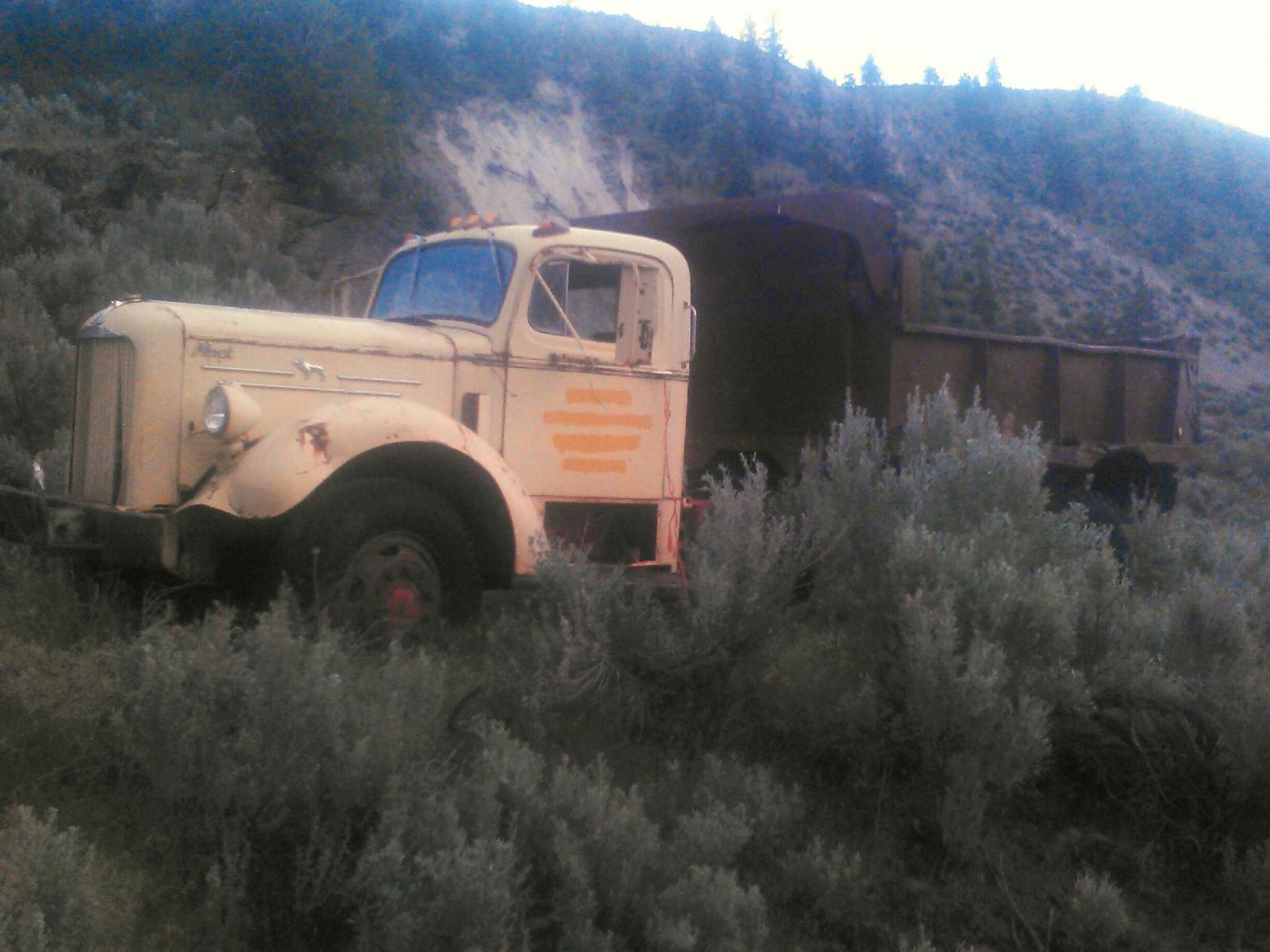

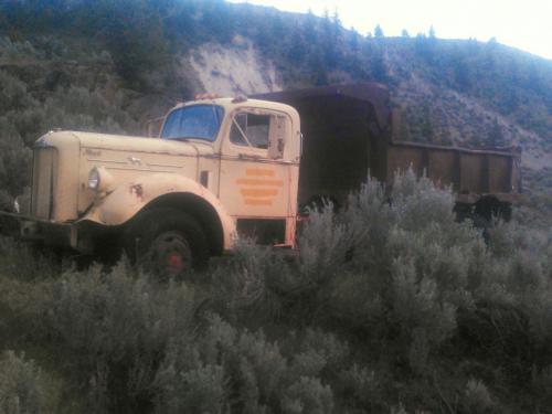

ok smart phone has whooped my needle brain cant get pics to post the id tag says A54S 1620 truck has dents and dings but no bad damage. Gas pot 6cyl. main and aux trans. didn't play with to count gears, but levers move, bad news is rear axles pulled.air brake single screw rear double frame both frame and cab good as far as rust just a little in the floor.

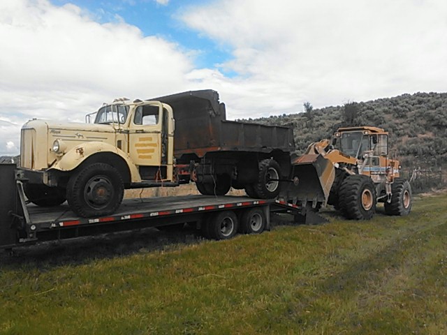

well before rattle snake season gets into full swing I guess I had better go get this thing. besides the battery box cover the other thing I saw was missing was the bull dog, oh well I guess trucks 5 miles from home wont always be perfect !

I would think the aux. trans is a 3 speed not a 4 speed unless changed by previous owner. I had a spec sheet for a Mack A-51 and it was offered with a du-plex,mono shift or 5X3 main and 3 speed Brown Lipe or Spicer aux. This is not saying other trans. were not avaible just spec. sheet I had. There was a man in Penna. that had some A-Model parts I do not know if he still deals with it. His name is John Chalmers. It looks to me as A-Model Macks are getting some interest after all these years. From your picture the tin looks great after sitting out all those years.In Pa. it would have quite a bit of rust and bullet holes from target practice.Good Luck on the save. Joe D.
