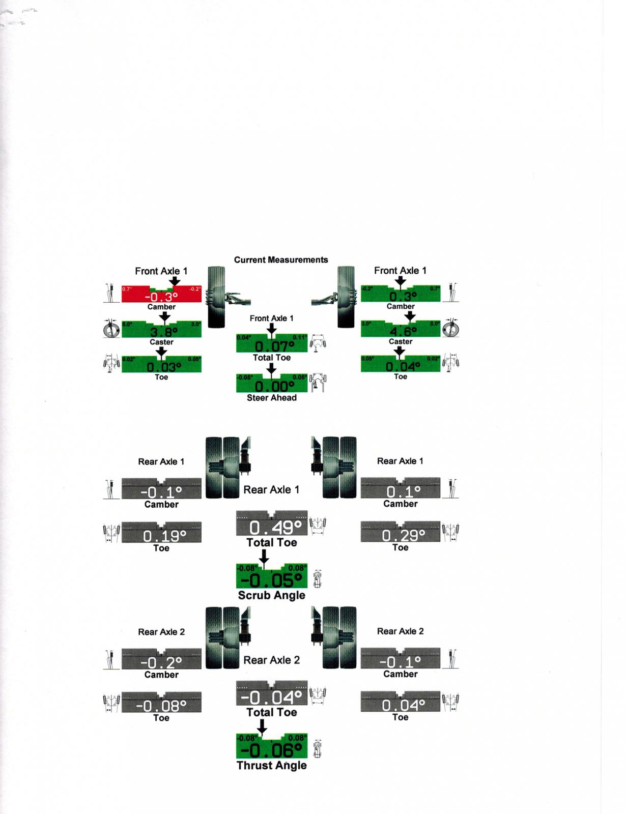

I'm the very disappointed owner of a 2014 CHU that wanders all over the road like a coyote chasing gophers from ditch to ditch. Have had alignment checked twice at 2 different shops and they both say it's good. Steering box has been replaced under warranty and it didn't help at all. Got rid of the factory Bridgestone steer tires and replaced with Michelins which improved it slightly, but still darts side to side at the slightest rut or twist in the road.
Oh yeah, forgot to mention it only has 80,000km on it. Anybody have any ideas, cause the dealership sure don't?

5000kgs on the steers seems light to me.....my granite roll off is over 7000kgs empty. If the drives are crooked it would wanna follow them.....air ride or other?

Drives line up perfect. Thrust angles are dead on. It's got the new Twin Y suspension on the back and Mack 14200 steer axle. I know of 2 other owners of the same model having the same problem. One has Hendrickson and the other has NeWay suspension.
Sorry I didn't get back yesterday. My alignment guy says the toe and caster are a little off and might cause some wonder. He asked me if the inspection procedure which is a bullitin for the twin Y suspension has been done? Also he would like the alignment measurments of the rears if possible.

My alignment guy said its good. Unfortunately its hard to change camber as it is factory set. The only way is to bend the beam which Mack does not allow.
OK Thanks.
I was thinking that having both sides slightly negative would be the way to go.
My older Mack service manual in the alignment section says that "Castor should not vary more than 0`30' from side to side." Maybe your dealer could tighten up the "range" that your castor is set at now so that Both sides would be equal at 4 degrees or 4.2 degrees.
