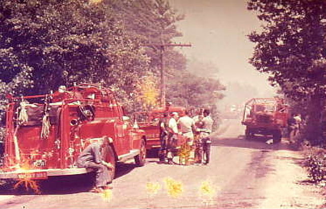

I went through the Cape Cod F.D. sight quickly and found what looks like it in the 1957 BB Sandwich fire in the far right. I sent an Email but no response yet . Any info appreciated. Paul

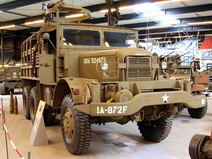

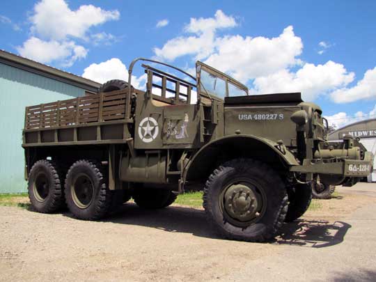

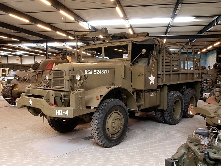

Would that have been a 707 powered unit? What would the drive line have been exactly? Was it permantly in all wheel drive? Was there a high/low range transfer case with maybe a five speed? I've not seen any literature on the NO other than what is in the Mack sanctioned picture book. The photo where it halls a large gun and sits next to a jeep with a mortar is cool...it looks massive as hell.

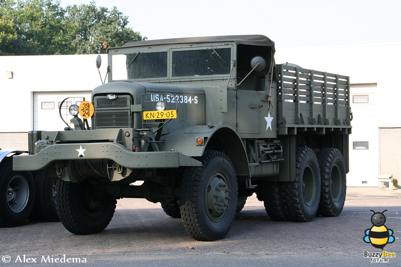

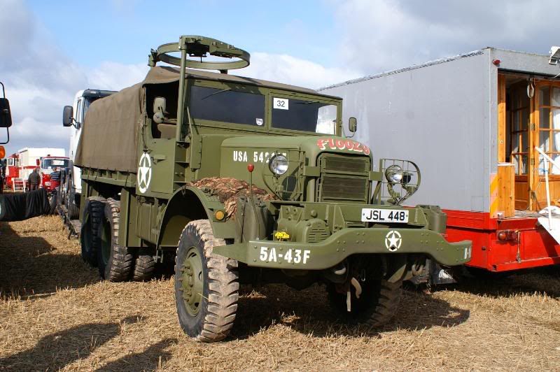

There are apparently 3 versions of the NO. A 1940 version a 1942 /43 version and a 1943 to 1945 version, I think since the specs are very close it is just three different contracts-purchase orders.

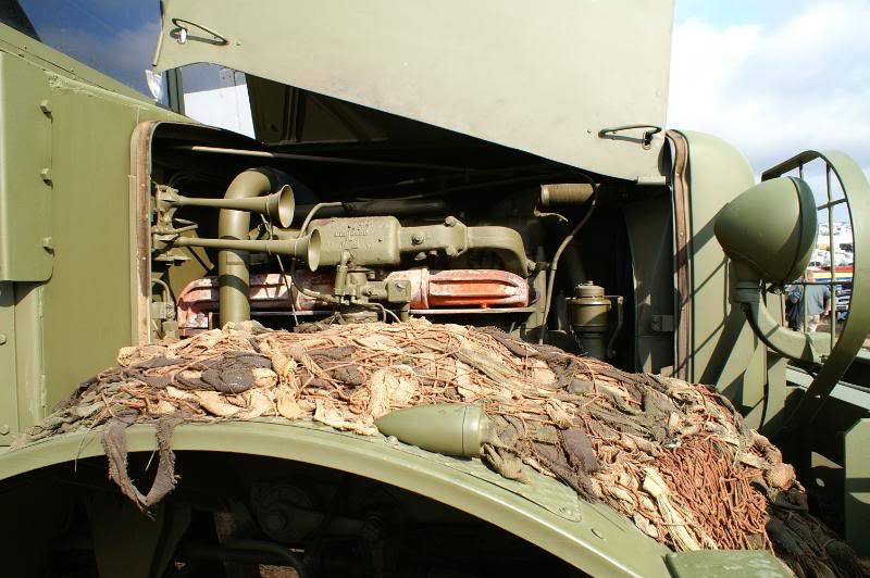

Power was a military spec EY 707 over head valve gas engine 170 b.h.p. , MACK 5 speed with 5th gear direct, hi and low range transfer case, MACK CR38 and CR39 rear axles with a ratio of 9:02. Front was a FA49 elevated axle ( no ball joints it had a bevel gear drive instead). Borg Warner air brakes, with an electric trailer brake. 160 gallon fuel tank. 2053 built. GVW was a bit over 44,000 lbs. After WWII most if not all in Europe were rebuilt by Corbitt and given to Allies in NATO. According to my info what was in production here when Germany surrendered were finished and put in reserve. Later given to Civil Defense units and a few lucky municipalities. Paul

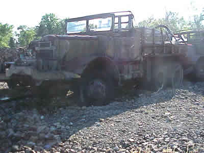

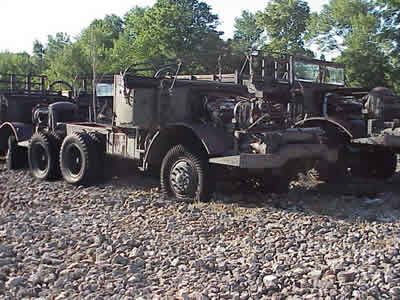

Haven't found info on the fire truck but found 2 very very expensive NO G-532 artillery hauler in Akron, Ohio. Classed as lifetime resto projects. Paul
https://www.bigmacktrucks.com/topic/36124-mack-no-brush-buster/#findComment-250574
Akron, OH? Must be Sam Winer.
http://www.samwinermotors.com/
Yep He's got two 85% complete and one 50% complete and 4 sets of front and rear axles. Only an arm, leg and first born for any of them. :)

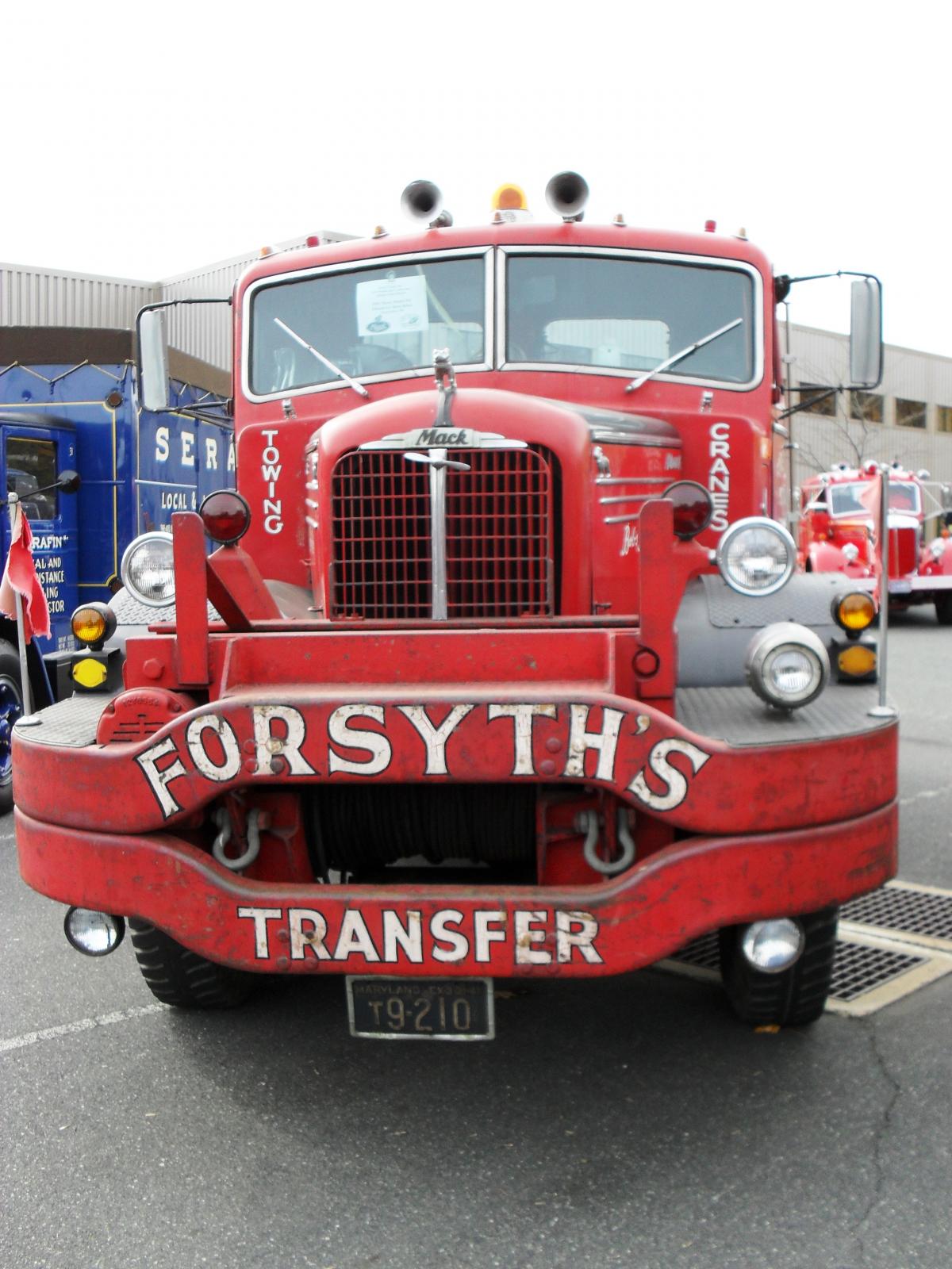

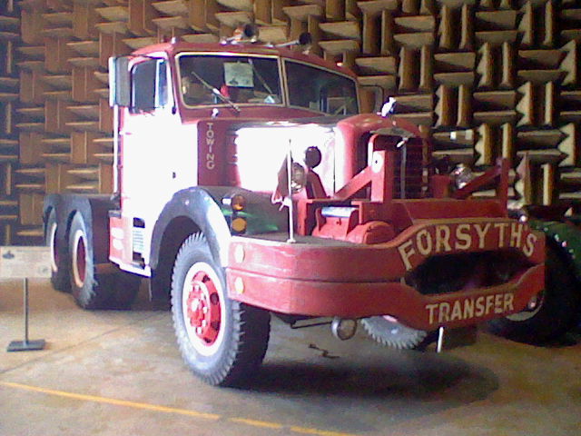

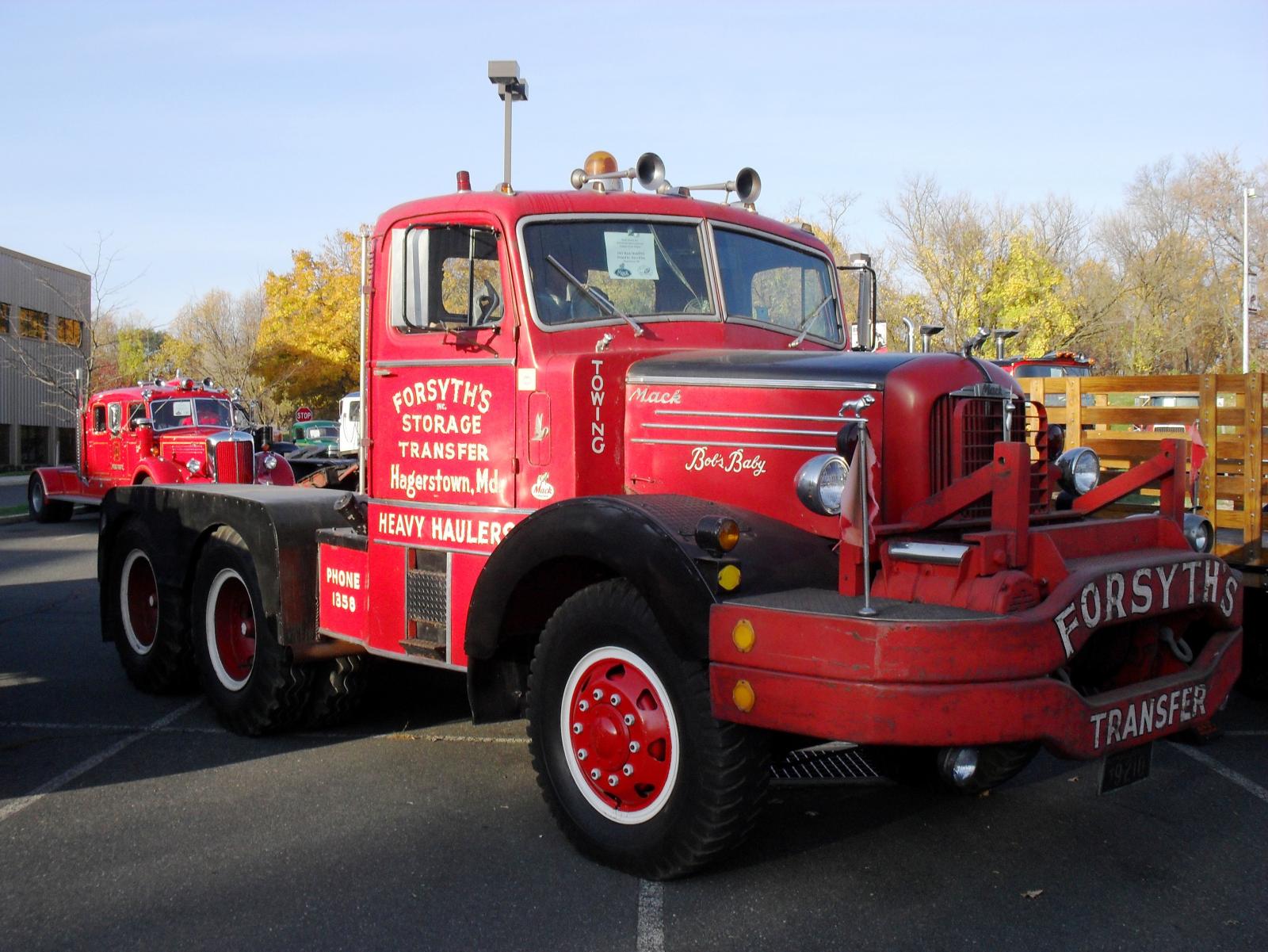

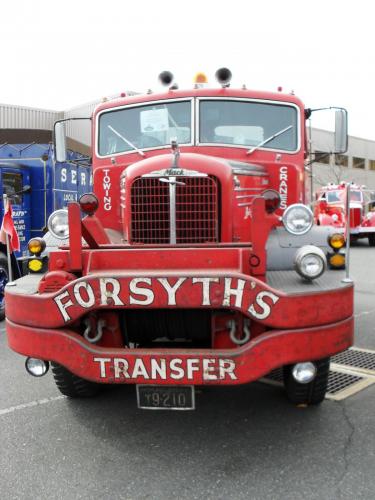

Forsyths is interesting with the second bumper flipped over. Paul
