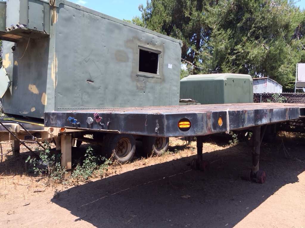

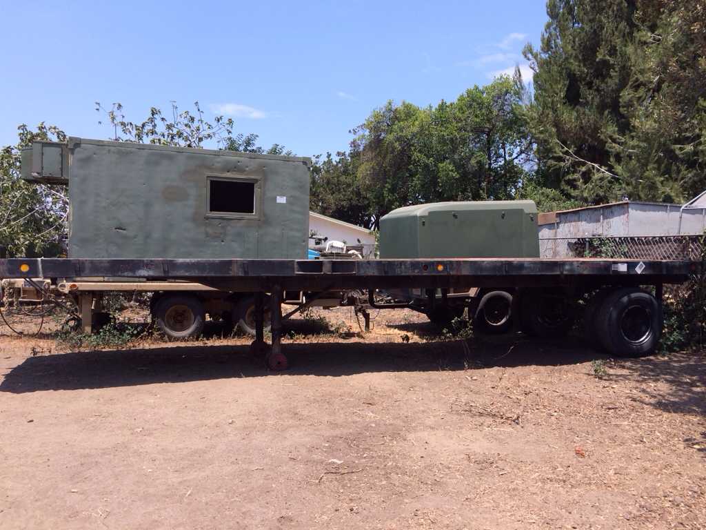

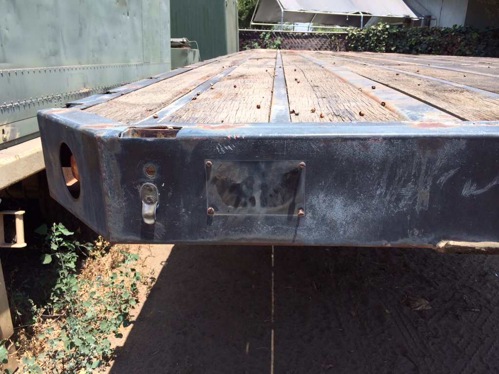

I just picked up a 30 foot single axle flatbed trailer. The manufacturers data tag is missing. Is this information stamped anyplace else on the trailer?

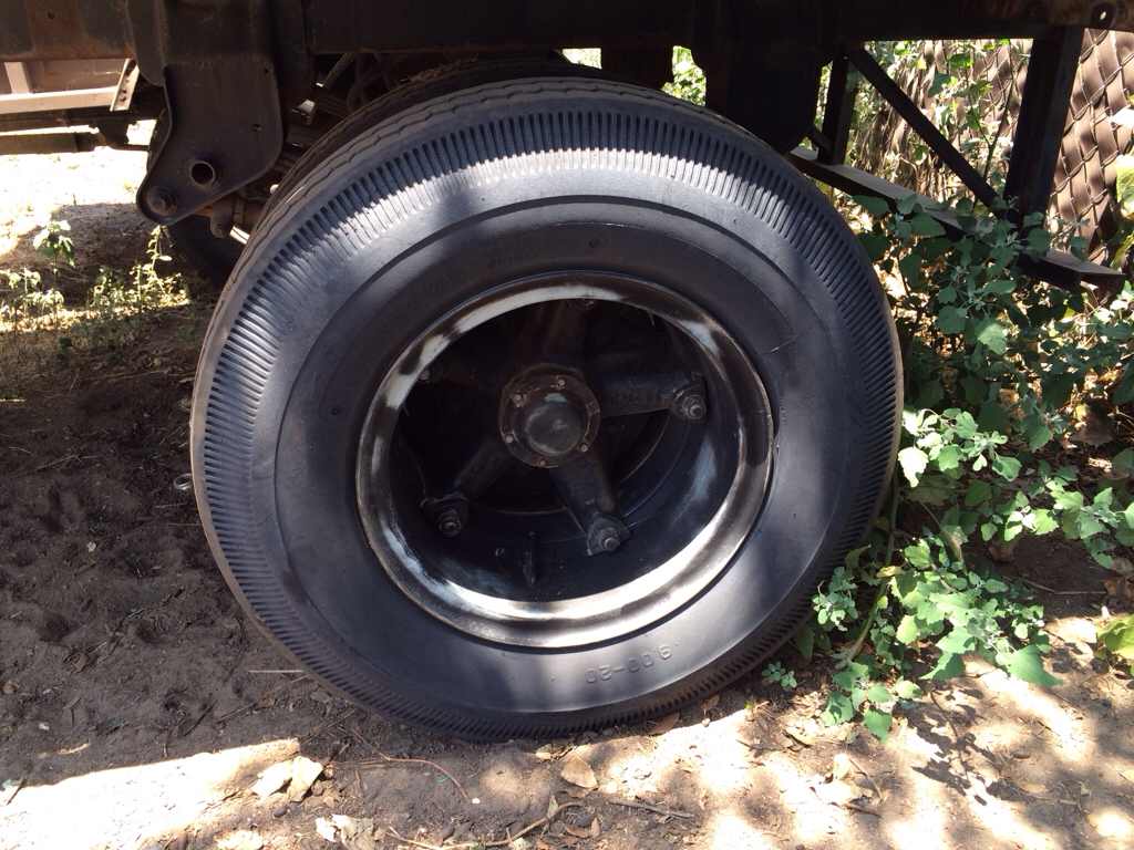

The trailer looks to be an older trailer. It has 9-20 tires on spoked wheels.

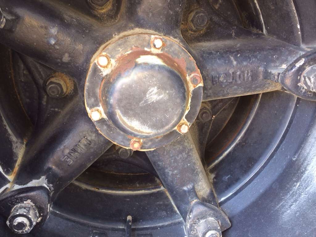

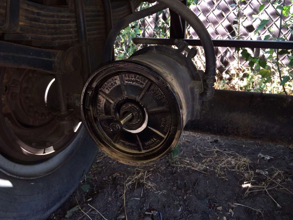

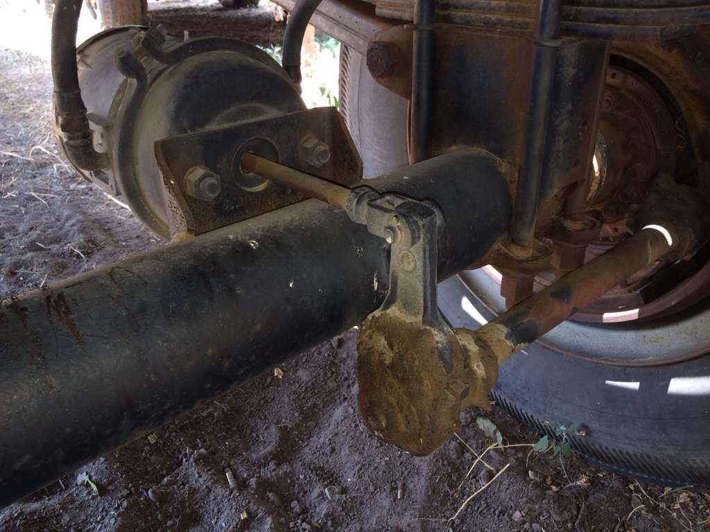

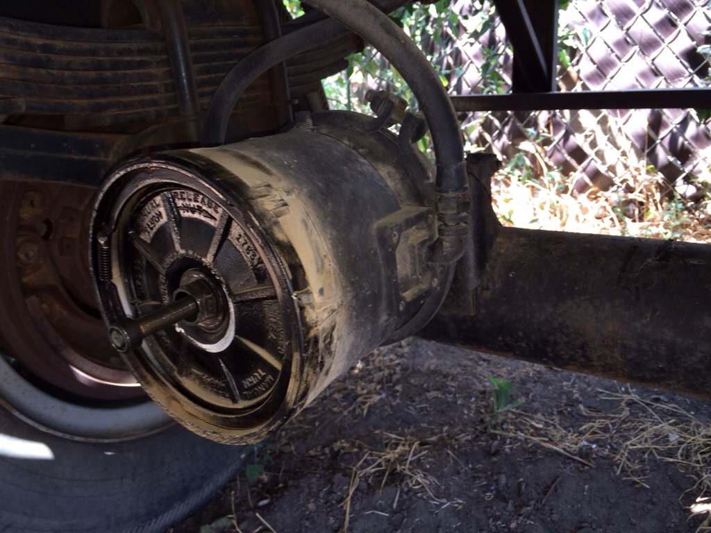

The trailer has s cam spring brakes but the spring brake chambers are unlike any that I have seen before. They look like a cylinder and have a built in caging bolt.

photos?

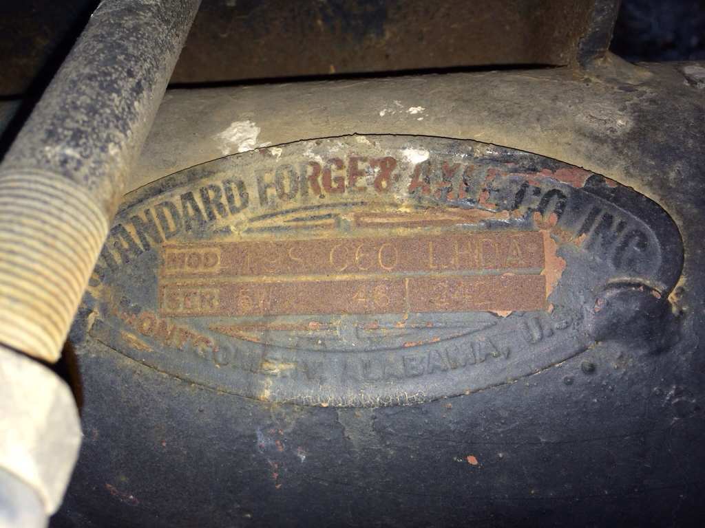

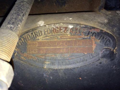

The axle tag reads
Standard forge & axle CO Inc.
Montgomery Alabama
Model A19S C60 LHDA
Serial number 5W 46 242
This tag appears to have been trademarked in 1970 and expired in 1993
The Air Can is marked
Berg MFG CO Chicago
1783 Y
The Spider is marked
Hutch Line
  On 7/5/2014 at 8:48 PM, Maddog13407 said:

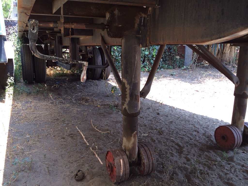

the axle looks like a Fruehauf with those torsion bars and the Reyco style spring hangers. the landing gears looks like Galion or Trailmobile tho.
Thanks for the reply
Any thoughts on the vintage or year?
We had a similar flatbed years ago on the farm,just sat,never went anywhere it had the angled corners in the front,thats what made me think Fruehauf,but now that I think about it,it had a Fruehauf emblem to the right of the gladhands? could be wrong but just an un-educated guess! Lol!....................................Mark
  On 7/11/2014 at 3:12 AM, carlotpilot said:

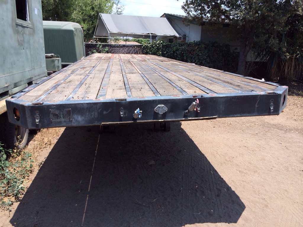

for what its worth looking at the floor the way its installed( gindy) is the only one that i have seen like that
Yes it is an odd floor.
What is Gindy?
The metal strips are actually the top of hat channels. They do not hold down the planks. They appear the support the edges of the planks. The planks appear to be screwed down through the hat channel to the trailer crossmember.
