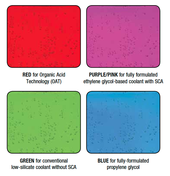

Coolant Colors
The TMC has established recommended colors for varying types of coolants (RP-351). While these are recommendations, the colors are not required and some manufacturers do not follow the color guidelines. Note the color recommendations below:
When choosing the appropriate type of coolant, it is important to understand that you should not assume colors on the packaging are the color of the contents in the bottle. It is not uncommon to find red or purple labeling, or colored caps, on products that might not correlate to the content’s color or formulation. Do not judge a book by its cover and always read the label to be sure you are buying the appropriate coolant for your system.
