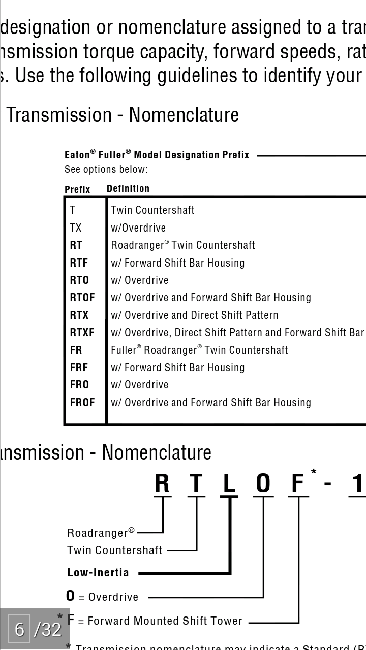

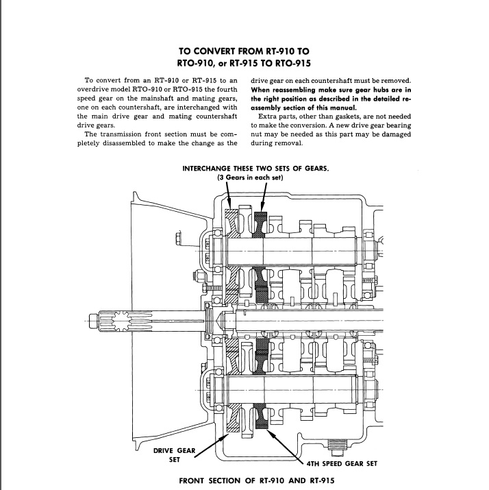

If you swap the gearsets in the box to make it an overdrive in high (see pic), every gear (except "direct") gets raised one notch, so the 4th and 5th positions would be reversed. If you didn't like that pattern, Fuller offers a shift plate (basically the top of the trans) which reverses the 4th and 5th shifter fork movement. This would put the pattern back to "normal". There's where all the "x-pattern" and "h-pattern" business comes from.
The older boxes, incidentally, should have an "O" in the number to indicate overdrive...like RTO-915. I can't tell you a blasted thing about the newer stuff.
My RTF-915 would be Roadranger, Transmission, Front-shift-tower, 950 ft-lbs torque rating, 15 speeds. Elegant system, isn't it? Just wish it was an RTFO-915, with the X-pattern body... Maybe if I ever pull it out, I'll change it!

Yes you can change from direct to over drive by swapping the gears around and I have did a lot of them in years past but when you do you will dislike it. It will have a coming home gear when in hi. There is too much of a split between the two gears.A factory o/d has all different gears in it and you end up with a smaller split from the factory set up.But in the early years we upgraded HP at over haul time and then next thing was add some speed.I never saw a man that was happy with swapping the gears.I never did try to figure the o/d ratio but its big.
According to the Fuller service manual...
15-speed direct
Deep Reduction
R - 13.03:1
1 - 12.0:1
2 - 9.42:1

Swapping the drive gears changes the speed of the countershafts. The spacing between gears is determined by the relative number of teeth on the various gear sets.
