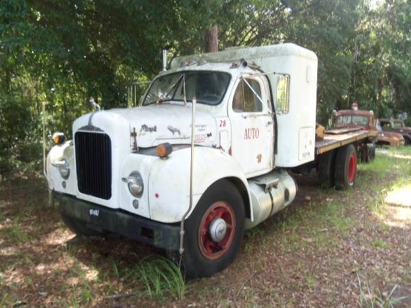

Hi, I have a 1958 B67T Mack with a 36" sleeper on it, there's a hole in the roof already, from what looks like was probably a roof unit it once had. I started looking for roof units, because I want to put air back in the truck (I live in Florida) and I came across Dometic 12 and 24 volt self contained units. I am familiar with the company because I helped my friend put one of their units on his Airstream, and it works great! HAs anyone had any experience with their 12/24 volt systems? It would make installing air so much easier if they work good. The website say's they are available all the way up to 13,000 BTU ! I would imagine that little Mack cab and 36" sleeper would turn into a freezer with a 13000 BTU unit! lol

That's why I'm looking at the self contained unit, where you don't have to mount a compressor, drier and condenser, it's all in the unit, my B67T has that doghouse right there under the dash, so no under dash unit fitting, and I can't put one on the floor between the seats on the floor, because of the sleeper.

What kind of truck do you have it on? Is it a big sleeper? I would be using it as my only source of A/C, but in a little B67, and a 36" sleeper, it should be fine I would think, I can close the sleeper off while I'm driving during the day
