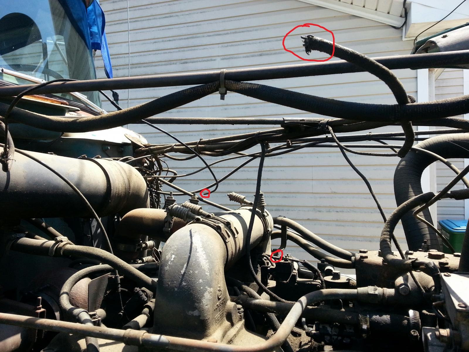

bdt the dynatard is quite simple: toggle sw. to micro sw. at fuel pump to dynatard solenoids . take a test light and find your switched power wire then run it to the fuel pump micro switch, with the throttle at idle the sw. should be closed so you should have power thru the sw. then wire micro sw. to the dynatard .=done
