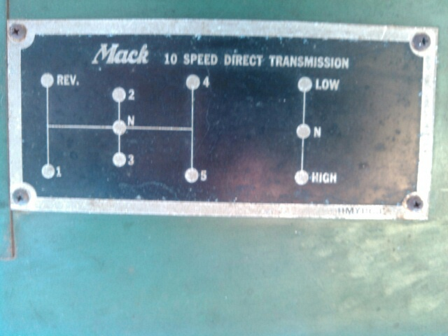

Hi, I read somewhere in one of these posts that I could find the trans numbers on the driver sider of my trans in my 1958 B67, however, the only numbers I have found are on the passenger side, and they don't appear to be the numbers I need. The guy I got it from, told me that top gear had been turned around, (like you can do to a Fuller trans) so that 5th gear is now forward, (up against the dash) is that even possible with a Mack trans? It has a duplex in it. These are the only numbers I can find on the trans, the front box has a Patent number 267440, and a part number under that that reads 284KB5623, the rear box has a casting number 281KBK544, and a part number 281KB. I have looked all over the passenger sides of both front and rear boxes, but can't kind anything, except for the Mack logo on the front box.

the trans numbers are on the left side of the front case and are stamped into the case, not raised like the patent numbers. news to me but don't think you can turn 5th gear around in a Mack. im betting its a 9 speed overgear. that was the most common after a while in a road tractor. if the case has been cracked and replaced, there could also be no numbers stamped. youll need a wire brush to find the numbers. they are right ahead of where the two cases bolt together.
Thanks, I'll look again, they are very clean, so I shouldn't have missed them, if they are there, but the shift pattern plaque in the truck clearly shows fifth gear being back, towards the rear of the truck, and not forward, so, someone may have swapped trannies out somewhere along the way.

Should have MACK cast in the left side, plus "Hypoid gearing" or something of the such. Like mentioned, it should have a milled flat spot in the front case with "TRD72" or the like stamped into it with like 3/8" tall letters.

If back box has high range toward dash it could be a mono-shift duplex converted to 2 stick duplex. I found this out a few weeks ago from a well versed Mack Man. Do not know about main box turned around. Joe D.
My '60 B 61 has a TRD 720 with the fifth gear turned around but the hi range is to the seat. Here is a paragraph from the shop manual: "In overgeared-type transmissions, an aditional rocker and pivot pin, to operate fourth and fifth-speed sliding clutch converts the shift pattern of these transmissions to that of the direct-drive boxes. Thus, either type of transmission has the same standard shift." I was talking to Matt Phafl last year about this and he said in some cases the direct shift tower/cover had been used on the over-gear transmissions and you wind up with the
4th/5th flip.
Well, there is one other thing, all the mack twin sticks I have ever seen, are pretty much both vertical, and pretty parallel . in this truck, the main box shifter is angled towards the back of the cab, like a straight single stick 5 speed. .
