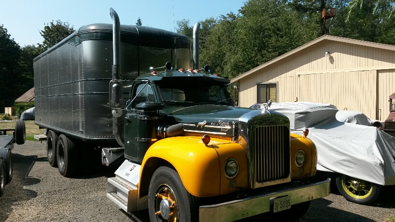

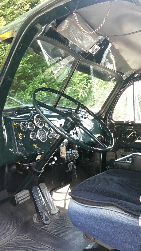

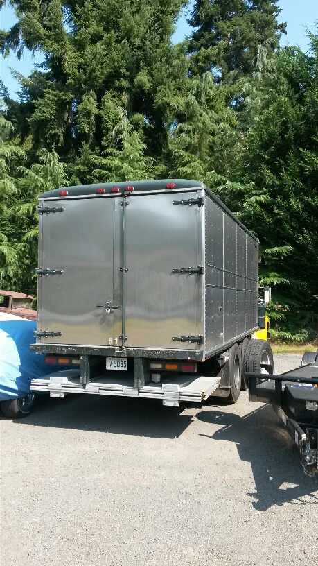

An AC compressor is sitting right above that area so couldn't see the number. Any other places the ID might be? Added some pic's below. thx

It's not coming out of what ever the gear was when you rolled to a stop and when you put it in first gear you are then getting stuck in two gears it will be a cheap fix will have to pull the floor out and see whats not lined up or what has worn off then just weld the piece up that has worn down or adjust dog on the rod in the top of the box to close the gap up ( you will see what Im on about when you have the top off the box ) I reckon it will take longer to get all the stuff out of the cab than it will to fix the problem wont be the clutch as it only happens in one gear oh yeah welcome and what a great looking truck looks real handy for bringing all sorts of bargins home gotta love the tail gate lifter :twothumbsup:

Neat truck! Love the stainless box.

Welcome. Very nice truck and box. Sounds like a fun trip. Hope you can get the trans straightened out with not too much trouble. PS Looks like something cool under cover parked next to your truck
might be more more than just one thing hiding in the background you blokes have sharper eyes than me that is one cool looking truck

putting 2+2 your trip over the narrows and the fact that your house and surrounding trees don't have moss on them I'm guessing your around Purdy-Silverdale area, if so watch out for the wimmins correctional facility! don't be trying to get behind bars :loldude:
