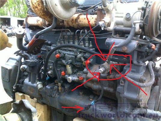

Based on the pic, it is NOT an ETech but rather a conventional pump-line-nozzle injection system.
Is the transfer/supply pump providing fuel to the injection pump? If so then the problem is between the pump and nozzles. Or could be a problem with the ECM.

The fuel shutoff solenoid is just to the left of the circle (10 o'clock position). It is mounted on the front side of the injection pump. The fuel solenoid itself may be functional but it is controlled by the V-MAC module (ECM). There are many sensors that "feed" the ECM. It could be anyone of these sensors that is causing the ECM to shutoff the fuel.
Is the CEL (check engine light) illuminated?
As theakerstwo posted, your best bet is to get it to a Mack dealer so they can hookup a computer and diagnose the issue.
As much as I like to "do things myself", it is sometimes less expensive and time consuming to pay an "expert".
Either way good luck in resolving your issue.
Ken
