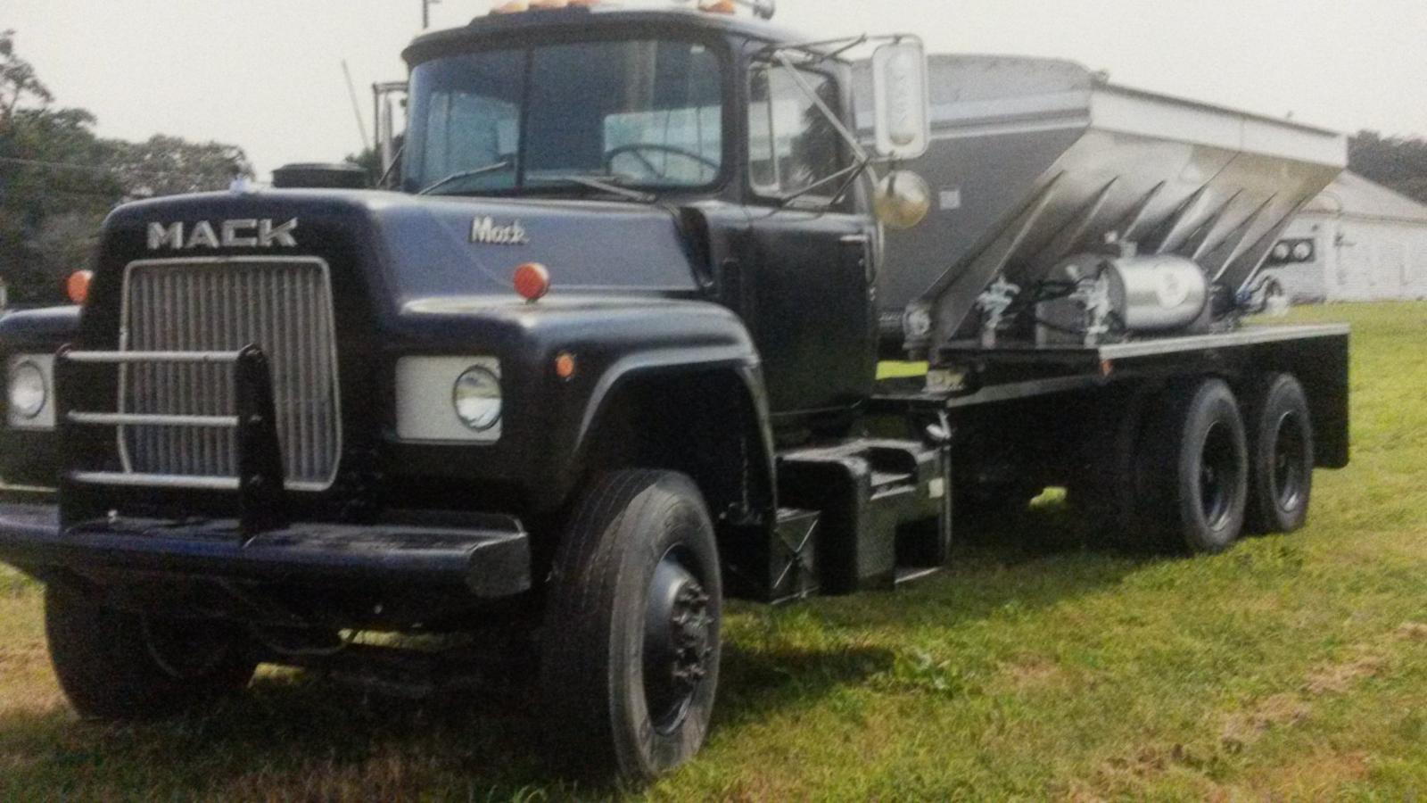

Hello All,
I have found much helpful information on this site--thank you all, but I haven't found exactly what I am looking for concerning brakes.
I have a 1978 RD600 that does about 400 miles a week delivering products (usually loaded at GVW 50000 lbs) to farms. It has what I consider "regular" brakes, that is they look and adjust like any other brakes we use. I think they have Bendix 20/24 canister or similar.
The brake are barely adequate. We have put on new liners, the drums are not wore out. I keep them adjusted as tight at I dare.
Does anyone have any ideas to make them better? Like I said, they are adequate but if you have to stop in a hurry is where there effectiveness runs short.
Are there upgrades? Its like I wish they had a power assist--is there such a thing? Can I add it?
We love the truck (almost no maintenance cost compared to our newer trucks) but I wish it had better brakes.
Any insight is appreciated. Thanks
Ross
