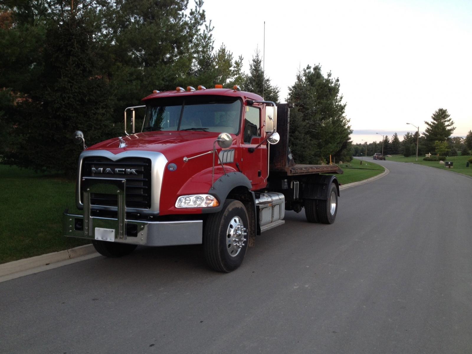

The hook lift system is probably heavier. The interchangeable bodies have to be pretty rugged to take the forces when fully loaded.
The hook lift excels in versatility switching between bodies from flatbeds that can level load items, bins, box bodies, etc. with one chassis.

We have an assortment of bins and a deck for machinery for the roll offs, but the tare weights are kinda ridiculous for trying to maximize loads....20yd (smallest cans) tare @ 17,100kg on my GU and around 16,000 on the RD tandem and 50yd are almost 19,000kg....but a dump of similar preportions tares @ 15,000 or less. It's the versatility we need, but trying to save weight. 16 tonne payload doesn't go too far. The Rd is even lower, MTO only allows 28,000kg gross.....
Also seems that hook loaders dont have the finese for pick ups due to the no rails thing.....never run one, but they seem to tip the can back an awful lot during p/u....

hook lifts don't need the height clearance that a roll off does
have seen tandem hook lifts but most are S/A units 10 yd cans
good for smaller projects or space limitations
Had thought about getting a truck and some cans at one time. could just go around a jobsite and load onto my grapple-make one trip instead of 5
I'am not sure what you mean by finese. but having run both I much prefer the hooklift to the cable type. a couple of reasons are
1 you can pick cans at an angle with a hook.
2 you don't have to get out of the cab to load.
3 you can use the hook like a crane
I totally agree on the light weight thing... you can use it like a dump truck but you can't get the tonnage like one

1. Sure you can, I do it daily...trick to minimizing the roofers missing the can is dropping it super close along the wall, get most of the can hagnkng off the tails, position the back close and set it down, then let the cable out and for the last few feet, crank the wheel away from the building, swinging the back of the truck and the front of the bin into the wall...to pu set up at an angle (I've done about 30* from center without scratching/gouging the tails), pick up the bin and turn in to pull it off the wall at the same shallow angle I put it down. easier when the bin is loaded right, heavy shit at the front.....with gravel you only need 1/4 of the bin on the truck to lift the feet off the ground....it gets interesting picking up a super tail heavy bin, one last week all the gravel/roof mat was at the doors and the insulation was in the front.....Had 90% of the bin on the truck before it would lift the feet.....and the front end lol
Re-read the finese thing, and it wasn't what iwas talking about, and I'm not sure how to explain it.....
