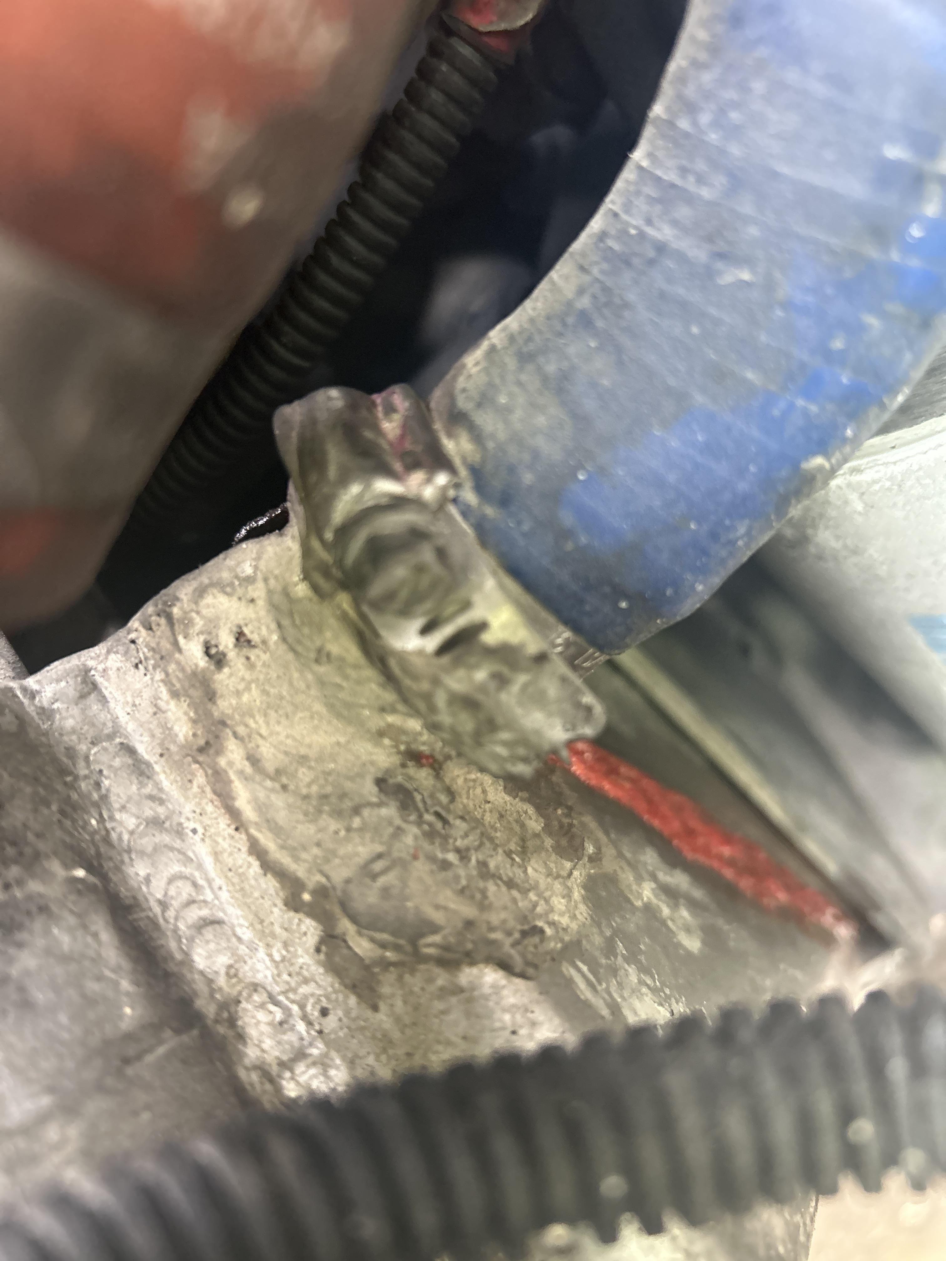

It’s thick almost feels like chunky grease but I believe that’s a coolant line . Does all that egr stuff have to stay on the truck can all that shit come off since it’s deleted anyway. I owned road tractors for yrs cats Detroit and Cummins I know I sound like a greenhorn and on this Mack dump truck that’s cause I am …if you look at all the soot on the engine it’s all over did find one leak in exhaust manifold . What kind of gasket goes with that manifold Is it one I can make or is it special
Thanks fellas again. I’m going take that pc of piping off and take a photo maybe you see something diff than I do.  I did find a wear spot on one of the boots for air to air don’t know yet if that’s the leak or not getting ready to see.  Also that red orange substance I am reluctant to to peel away at that silicon and see what’s under it but gona have to I’m guessing could be a crack in the egr cooler that would prolly not help the smoke and boost problem any.  Ok so the exhaust manifold gaskets for these motors I have one on back order along with a turbo gasket are there any other gaskets within this turbo egr side that I should just replace while I’m in there ? Could cracked egr cooler be the problem? The codes thrown again where signal codes and waste gate code signal code read somthing like low signal cylinder 2

I don’t have a boost gauge in this truck first one I’ve ever had without one.. so I don’t know I took boot off front of turbo and there’s a smidge of oil not much at all egr is unplugged also the codes are a 4-5 code which is waste gate I think then signal codes to cylinders 15 codes 15 times everytime if there’s a leak in air to air I haven’t found it yet. Could it be electrical ? I’m just lost man and I’ve spent so much money already I’m a bit beat up but not much quit in me so
Ring nozzle I’ll look at that as well everything is sooted up lol I’ve washed and washed cleaned contacts fuses I’ve spent last 2 days hunting for the prob truck has to work tomorrow
