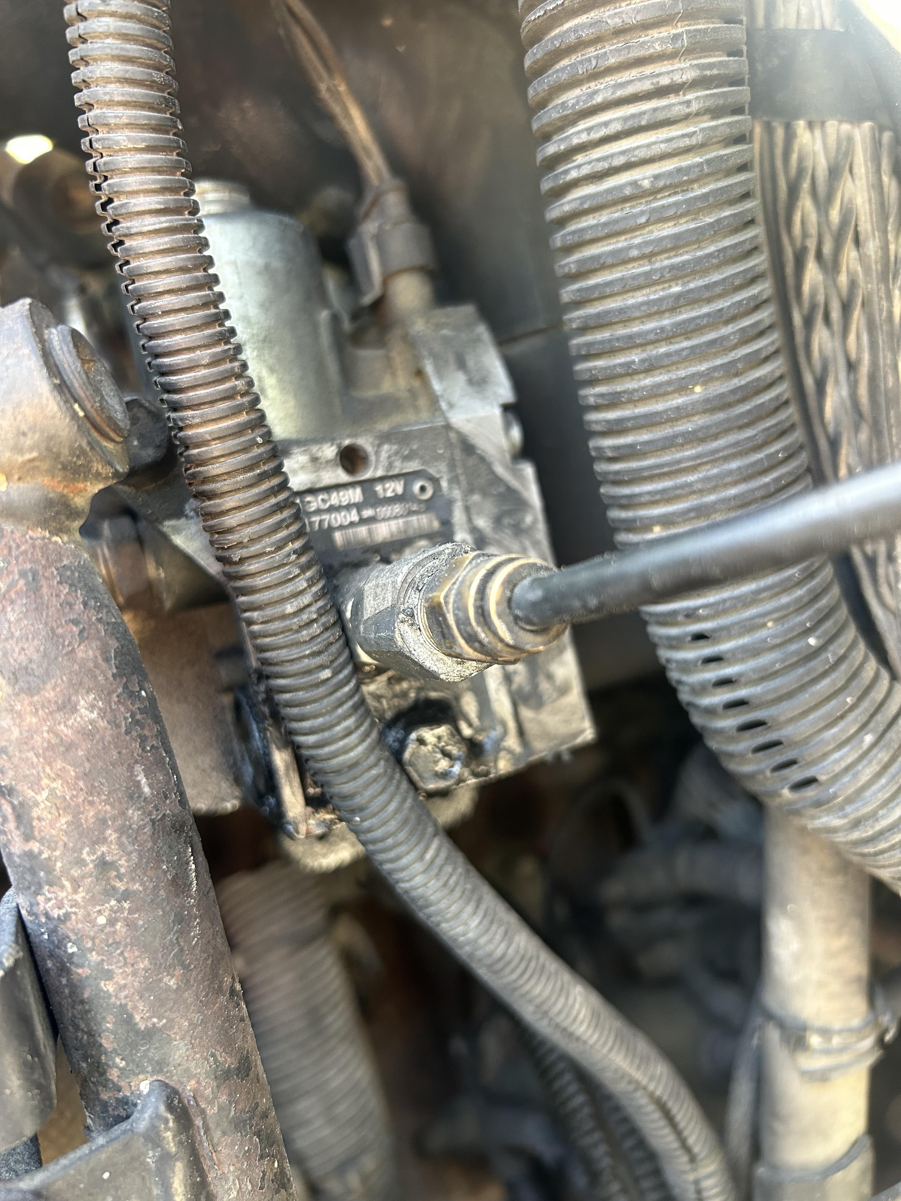

Joey Mack, it’s getting its air from this there is a line running from this valve to the actuator that black line right there probably used to come out of the filter that has vanished they just looped it back into the mixt.. there is another kinda skinny inline valve with a red stopper lookin thing on it this one loops to that one from the skinny one down the frame they just diverted it and bypassed the filter.. finding out about compressor tomorrow hopefully this week installed then we start cleaning night fellas IMG_5344.thumb.jpeg.98dc92190ab1c07a14e751b9acf37cce.jpegIMG_5344.thumb.jpeg.98dc92190ab1c07a14e751b9acf37cce.jpeg
No sh!t ??  Bypassed,  ok..  the air line going to the turbo should be a #4 stainless braided line.  I wish i had a bunch of pictures of a complete  AC engine.

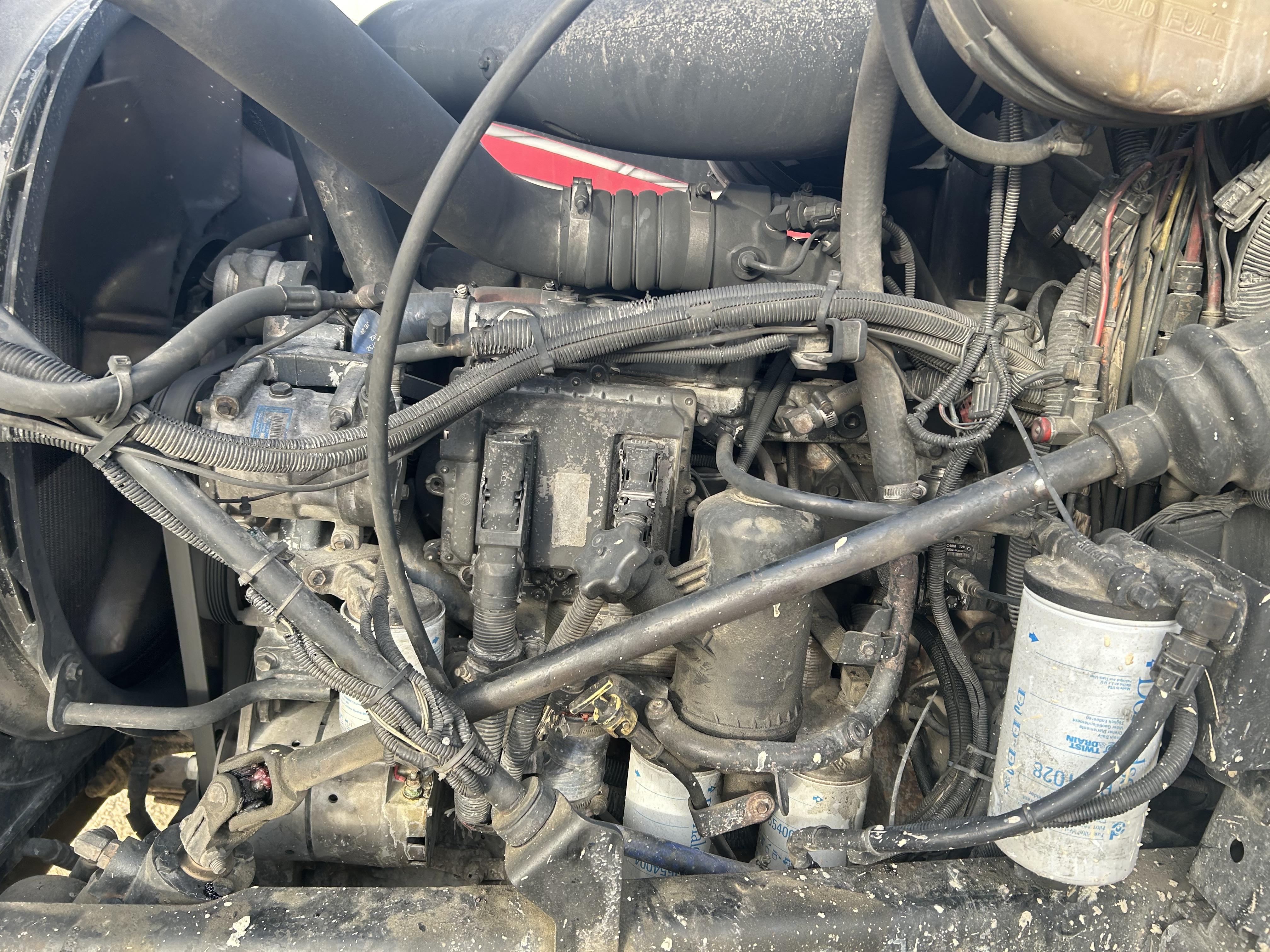

IMG_5336.thumb.jpeg.36e7f65237da5a782969dedc2c6423aa.jpegYa it’s runnin right out of that valve over the engine into the actuator if I could get my hands on that filter assembly I could put it back on I’d say look at this pick u see close to firewall that skinny valve with red knob on it it’s looped thru that instead of goin thru the filter assembly red knob red hose goin to it
That valve is the air regulator for the filter, the red button is a dust cover, theres a relief valve behind it. After a while they will leak.  Easy repair..

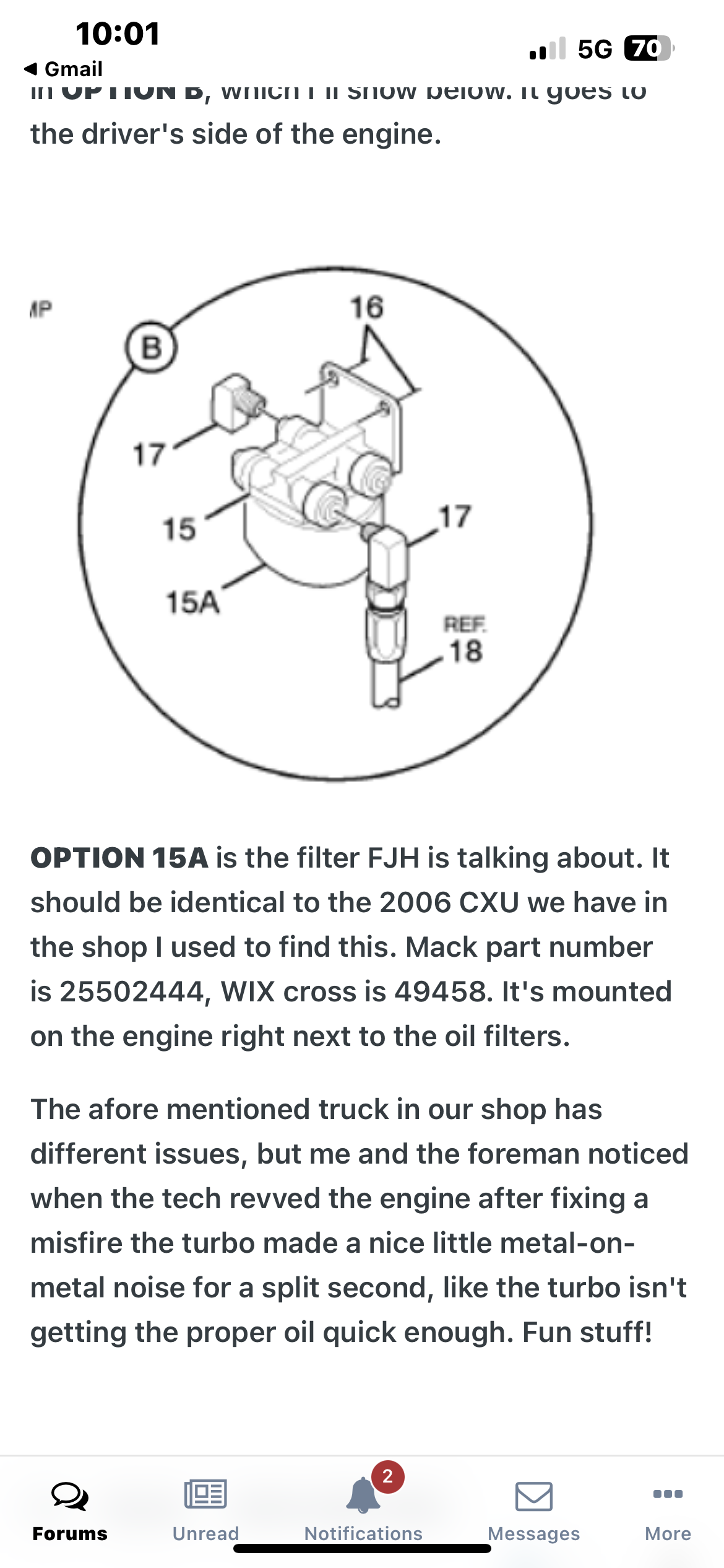

The truck in our shop didn't have the same complaints, but I feel like at least mentioning one repair we made could be related to your issues. The truck was showing faults for VTG Position Sensor code 4-5, Turbocharger Speed code 6-2, among others. I don't know if the VGT was sweeping correctly before or not, so I can't say if this truck had the same problem or not.
