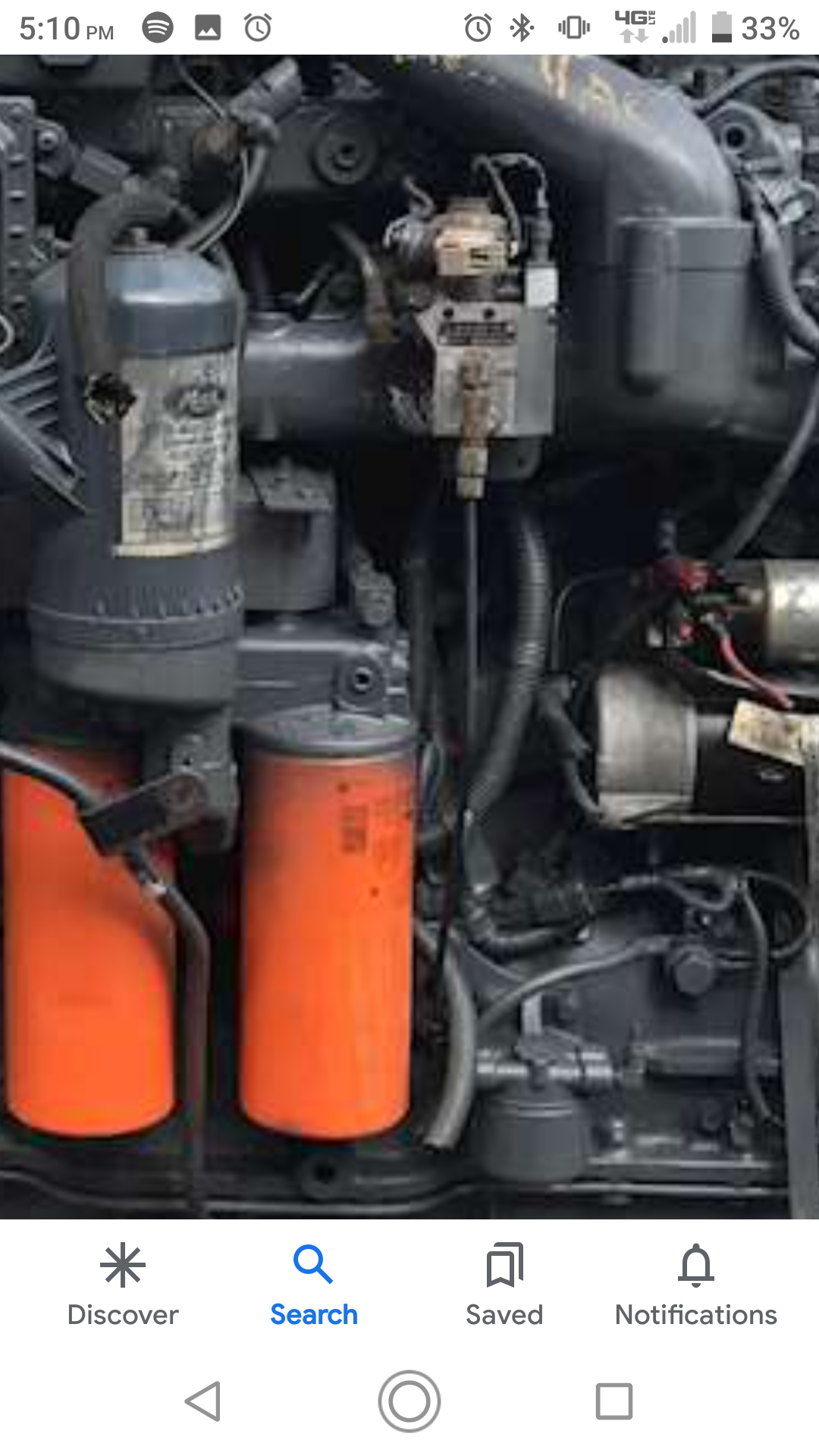

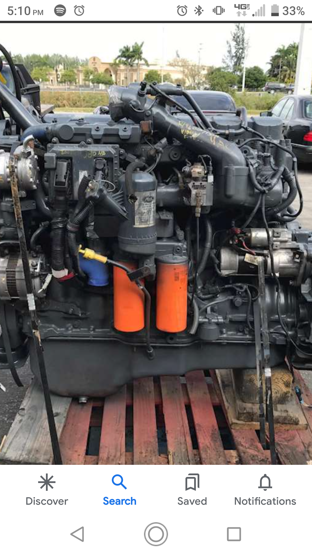

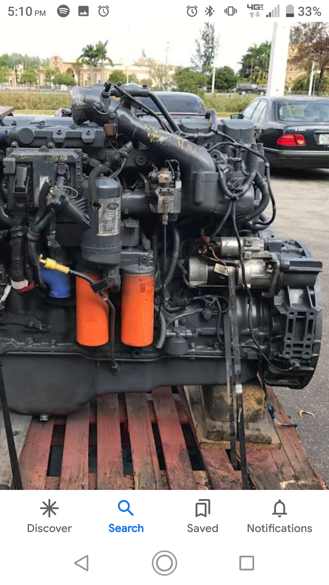

11 hours ago, Joey Mack said:

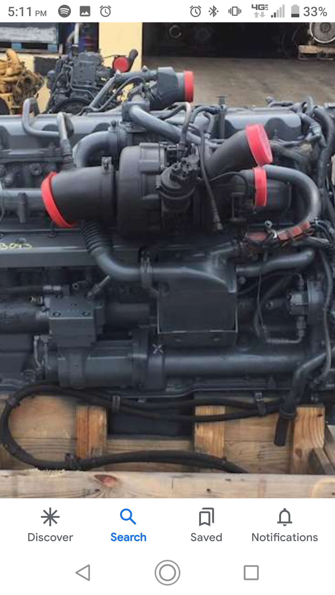

No sh!t ??  Bypassed,  ok..  the air line going to the turbo should be a #4 stainless braided line.  I wish i had a bunch of pictures of a complete  AC engine.
A little late to the Party, but the Googleweb is a great friend, sometimes. Punched in "Mack AC400 Engine" on an image search and was met with more than a few choices on pictures of engines minus truck frames in the way...

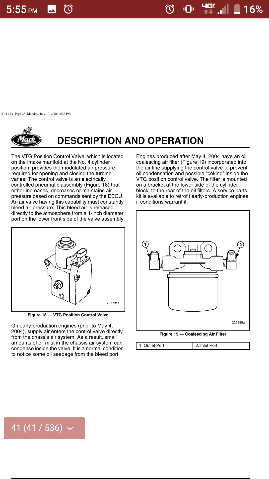

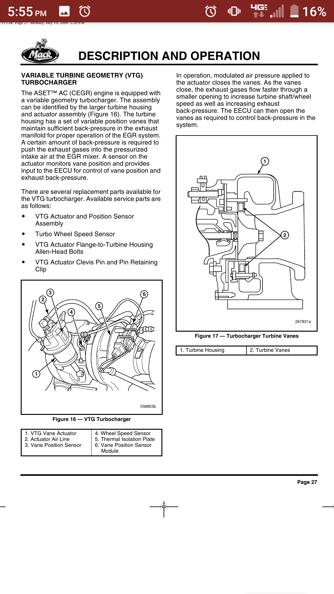

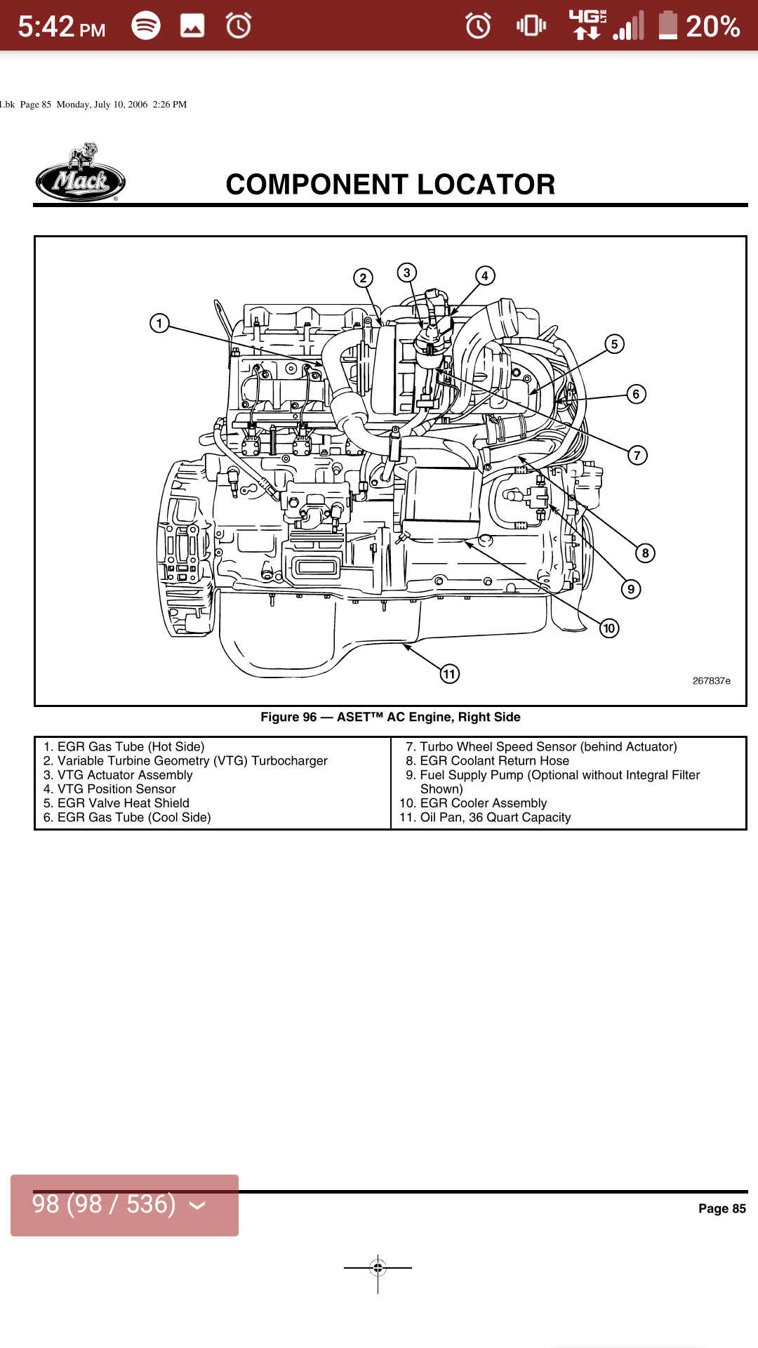

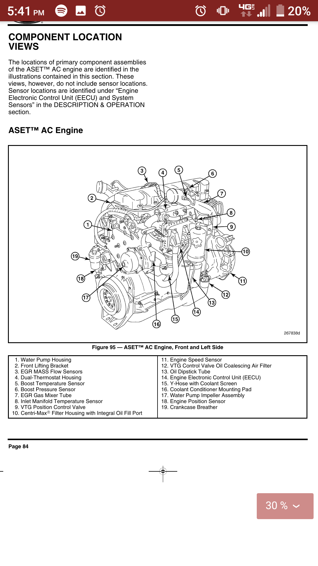

https://macktrucks.vg-emedia.com/ProductDetail.aspx?ProductId=6148
Here's a link to download (free) the Mack Manual for your engine.  Click on "View File" to download. It may have a lot of helpful info for you on this dumb EGR system's plumbing.

Ok I’m finally home pouring out so I’m reading joes literature .. I see a lot of things I don’t believe are on the engine anymore lol but I’ll look again. So here’s what I can do I believe I can get a new compressor and I’m gona try and locate the oil collector assembly to put back on the motor run it back thru the filter system with clean air I’m probably gona go thru the filters they are expensive but gotta do it I may be able to swing the turbo in any other month but may all 3 kids b days same month lol thoughts?
