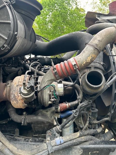

ok,, the pipe with the 2 sensors in it going over the valve cover feeds exhaust into the intake, I gues you nees to weld a cap on the EGR cooler end to stop exh flow into the intake..
the stainless steel pipe that goes over the rear valve cover..it has 2 probes in it..  weld a plug dont put anything that can come loose and get sucked into the intake..
Joe WTH is a telephone pipe and the 2 sensors if would let me send a damn picture are on a pipe running from the air to air on drivers side to another pipe on top the motor this one ?IMG_5283.jpeg.bf50c5d016275bceb4dcac26c34e1f1e.jpeg
the telephone pipe is the one with the bellows made in it, at the EGR cooler..  the curvy pipe fromt the EGR cooler to the top of the intake snorkle is the one that needs a welded plug.
the one wuth the red boot hose that has the 'S' shape needs a cap welded to that end..to plug off the flow..
Ok I can do that I hope I’m telling you guys everything correctly you have seen the motor and we are sure it’s an ac I’ll plug that change compressor have hienz get me new filter assembly I’ll show u better pic of what they did if I can find one

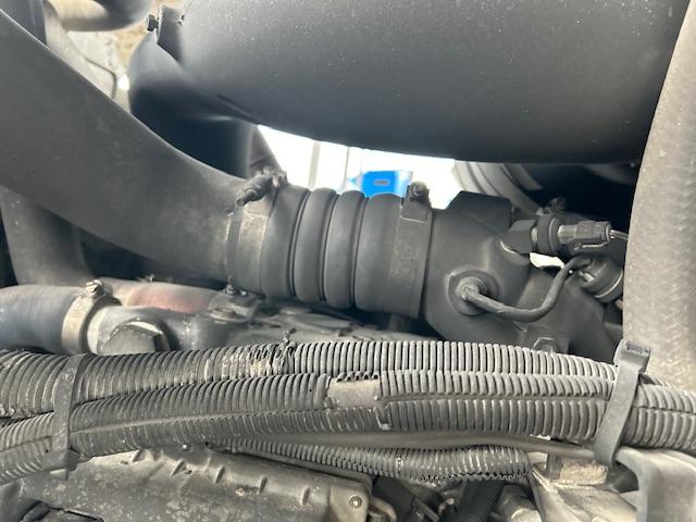

Yes hold on I’ll snap a pick of the pipe we pulled that was plugged I forgot about that the pipe coming out of her cooler that runs under the turbo to the egr valve is the one that was leaking air bad pulled it and it’s plugged IMG_5316.thumb.jpeg.2ca6686155c17b0add62a92032bf11d4.jpeg
The one with the accordion bumps on it! I plugged???? and is leaking? If its capped there or anywhere in that circuit its stopping the flo ! A plate bettween the egr valve and the manifold is less intrusive how ever whats done is done! fix the leak and move on! Your main issue is the turbo is not spooling up properly when you get on the throtle! either the vanes  or actuator are sticking or the controller is not working correctly because of the oil! and crap inside it! Have you been resetting the stroke on the turbo sweep before you start!

FJH good morning no you’re not off track yes in that circuit there is a plug from the pipe coming out of the left side of the EGR cooler. If you’re looking at it that picture it’s plugged up where it goes into that square block it where the EGR valve is, it was leaking at the clamp fix that that’s how we found out was deleted because it had a plug in it. Joe said I should camp off the red line coming in as well. The turbo is spooling up. There is no oil in that braided line going from the controller to the actuator, but that doesn’t mean that it’s not there already. I ordered a new compressor to get clean air started. There is an exhaust manifold leak I got exhaust manifold last night, gaskets Hines Hines can get me the filter assembly for that BGT filter so the new parts going on our compressor manifold gaskets I’m gonna try to find that filter and reroute those airlines back through it. Joe said that there shouldn’t be any exhaust going back into the manifold back into the engine , he said the shaped tube and leave the telephone pole alone

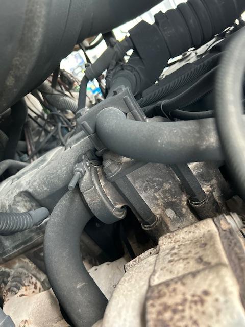

So I guess now my question is do I cut off the EGR flow or not do I cap it where the orange boot is ?
The job is already done! you don't need to plug it twice! the flow is effectively stopped if its capped where you say it is! you will get a code for low egr flow and the engine light will stay on for that! As well as the codes for the Vgt/ (Wastgate)  when it screws up! the problem is is you can.t see what codes are current! EGR will be off the scale at 15 also depending on how many  times the VGT screws up will also be at 15! Long as you can learn to live with what you have for the time being and can work and make some food money all will be good! Potter away at the rest!
Ya so funny you say that everytime we hook it up to computer it has thrown 15 codes 15 times the signal codes to the cylinders waste gate it’s never thrown an egr code that’s what is confusing and is the soot coming from a leak in exhaust manifold ?? Idk where it’s coming out I can’t get enough soot off the damn thing to find a hotspot so idk we only found where we think the exhaust leak is by taking a pc of hose one end to your ear and move it around until you hear the leak tried soaping it and found that leak from egr tube. Which side of the egr does the air come in first it’s the blue  boot under the red one they are on the same side? Reason I ask if it’s coming in that one if red boot isn’t block won’t exhaust go back into the engine?
