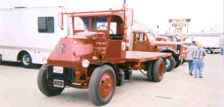

I borrowed this pic,but it was taken at Walcott the year Art Robinson brought his AC,he was a super nice guy,and really took a liking to Mikey. Art couldn't see very well so didn't get to drive his trucks.didn't stop him from enjoying them,though. I was standing out next to the show entrance talking to some people,and next thing I knew,this AC came flying by,Mikey driving and Art riding.

Change final drive ratio by going up or down on primary drive sprocket. I have a few different ones. The standard is 14 tooth, I have OEM 12 and a 13 tooth primaries that were a $8.10 factory optional pack. Rears are 39 and 43 teeth. I have an after market set from 1937 that are 21 primary and 47 final. With the 40 x 6 rear wheels and tires it would give you a top speed of about 50 + at 1600 RPM.

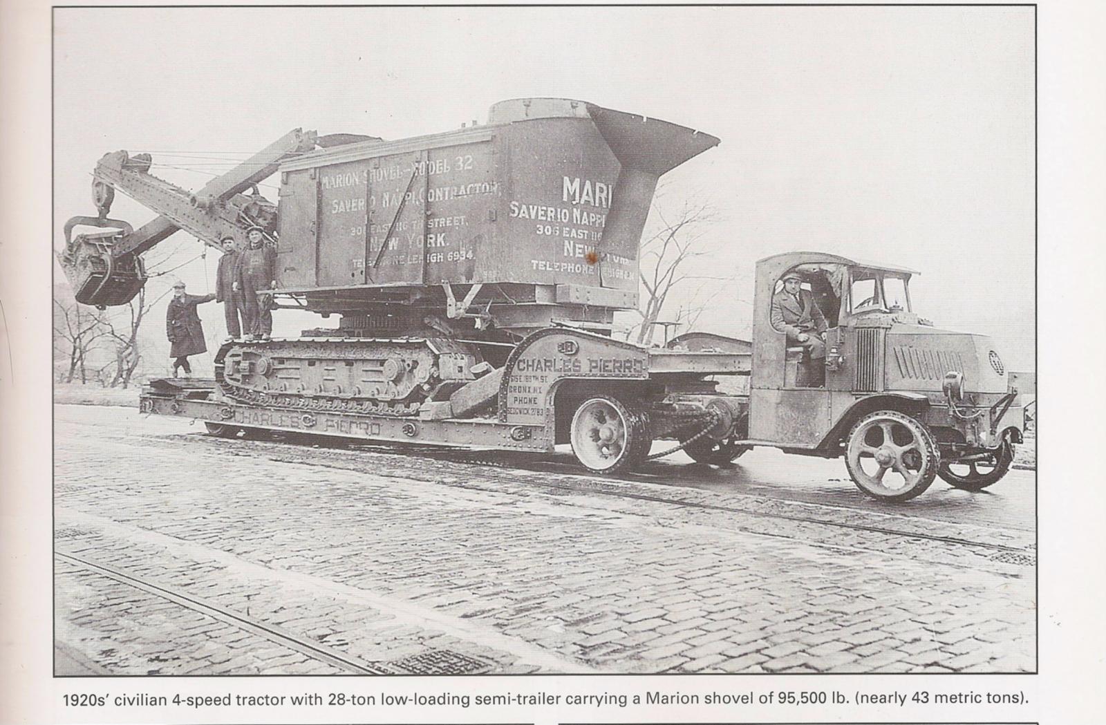

Loads? This was at the high end of normal Early 7 1/2 tonner with NO front brakes by probably have Bendix Vacuum Assist. Truck weight + trailer weight + 95550 Marion, all pulled with 70 or 74 h.p. in the BRONX

Got to remember one thing with all the teens and twenties trucks and the brakes, gearing and power. In their day we had may 20% paved highways with macadam or concrete. Most were still wagon trails or less. City roads were cobble stone or packed dirt and clay either oiled or watered. A lot of places these trucks went our modern units would have a ton of trouble with. As for the loads, those people never knew it couldn't be done most times they were the first motorized vehicles to move the loads and go where they did. Early drivers were real teamsters who went with the trucks the same places they went with the horses or mules.

The history lessons, and pictures, are appreciated as always. Interesting to see what people were able to accomplish when there was nobody there to tell them "It can't be done." The picture of the 7.5 tonner is amazing. Wish I'd been there! ;)
