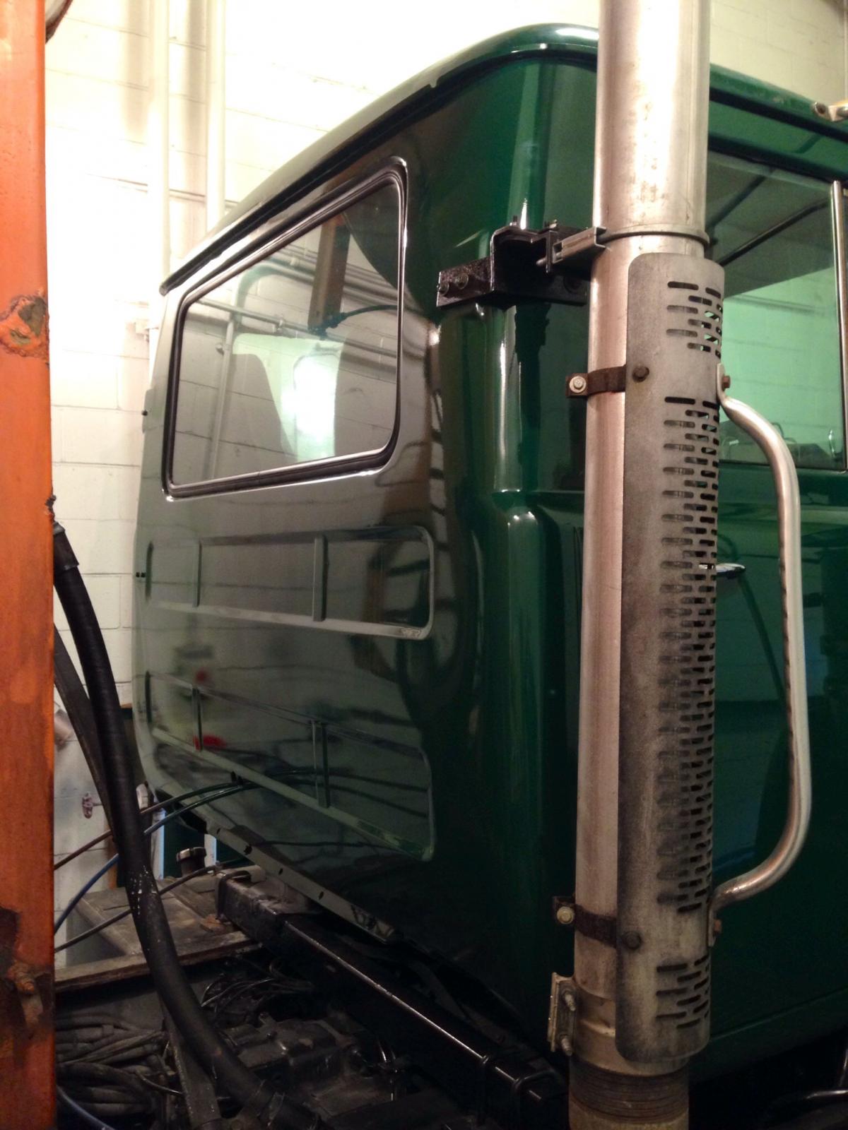

Today's progress:
1. Installed the battery box covers. They look great. Very happy with them. As my uncle said, "better than original."
2. Finished installing the windshield and the spline. It's now done.
3. Hung the doors.
post-18831-0-69446200-1426807155_thumb.j
post-18831-0-78186400-1426807223_thumb.j
post-18831-0-54546400-1426807292_thumb.j

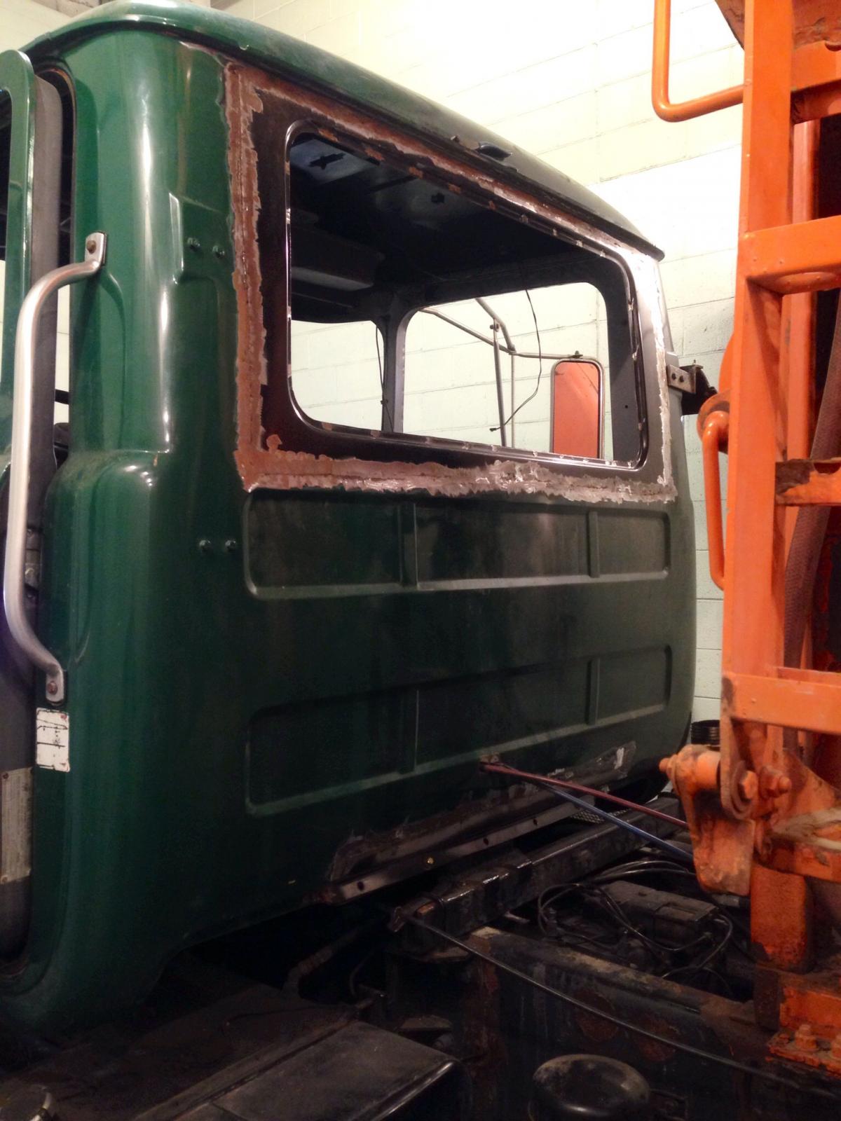

Yesterday's progress:
1. Replaced a missing bolt/nut combo on the hood support arms.
2. Put bends in the PTO/dump levers to A) give the passenger more room, B) make the levers easier to reach from driver's seat, and C) avoid hitting the glove box cover when in the down position. These levers are really sweet now.
3. Put a little more body filler on the cab corner to fill in some deep scratches from 40 grit paper. Sanded it down with 220 and 320. It's better now.
4. Sealed a pinhole in the rear corner by the exhaust with weatherstripping adhesive on the inside. Paint will take care of the outside.
This coming week is prep week for painting the cab (tentatively) on Thursday.
